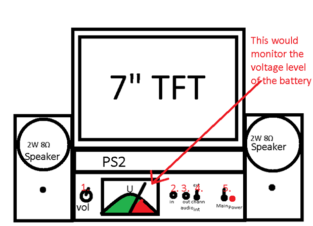

Couple'o days ago, I've got my hands on a PS2 Slim. Later on, I've noticed that it's power supply produces only 8.5v and max ~5.5A I guess.. So I've got the idea: Why not make a portable dock with a 7" TFT, 2W8Ohm stereo speakers, and an AUX port? So I've started searching aound the interwebs and didn't find a thing about this, but seen this RaspberryPi stuff, and came up with another idea: How about making a gameboy-ish retro console out of this little thingy?(Probably gutting an NES controller would give the controlls) So I started searching again and found some articles, but nothing actually has been around my imaginations. Then finally, I've found it out:
What if I put these all together, and make this AV dock that's compatible with PS2, and also has a RaspberryPi (actually functioning as a retro emulator) inside? It would probably be propelled by a 12v battery, and have a "Mikroelektronika AudioAmp" for the audio.
I'm doing this only as a hobby, I'm pretty much of a rookie in electronics stuff. I'm asking here about this, please help me.
I've came up with this sketch:
1. Volume knob
2. 3.5mm Audio in jack
3. 3.5mm Audio out jack
4. Channel switch(external - internal / PS2&RetroPi - External)
5. Main power switch and power LED
Sorry for the poor picture, I'm not a pro with MS paint..
Please Ben Heck, I need your help!!

    What I actually need help with is converting 12V into 8.5-9V 5-6Amps. Any suggestions?

    What could be using that much current?

    DC DC 15A Converter Buck Adjustable 4 32V 12V to 1 2 32V 3 3V 5V 24V Step Down | eBay
    Maybe?

    Sounds legit, think I can handle that.. But I've seen these "voltage regulators" that are used to power an LM386 chip from a 9v battery by reducing the voltage, those would take less space and emit less heat.
    Anyways, the 8.5v should be for the PS2(Slim)
    Thanks for any feedback/help so far!
    Any suggestions for the battery?

    Yeah, that would be a linear regulator.  I don't think you are going to put much current through those though. Worst case power would be (12V - 8.5V)*6A = 21W.
    Even at 90% efficiency on the switching regulator you'd only see around 5W wasted if my calculations are correct.
    0 e14 Contributor over 12 years ago in reply to colecago
    Yup, problem is PS2 requires 79W according to the Internet.
