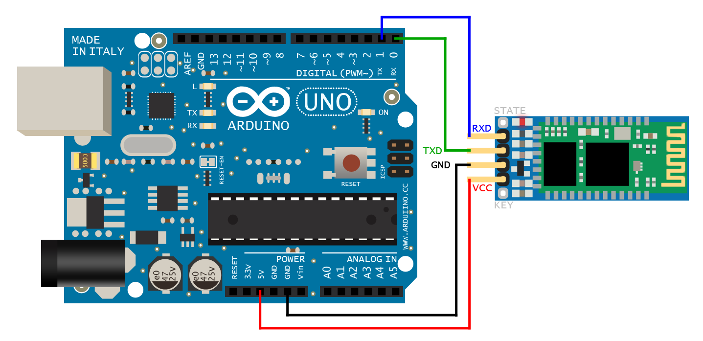

    Since we will be receiveing the data through the module and then in turn sending it to the arduino board we only need to use the TX pin on the module. Run a wire from that pin to the RX pin on the arduino board. The Led is controlled through PIN 2 on the arduino.
  • atharvabenheckfan
    0 atharvabenheckfan over 11 years ago
    The important aspect here is the baud rate - make sure it matches the baud rate of your module - check the datasheet or use AT commands to do it.

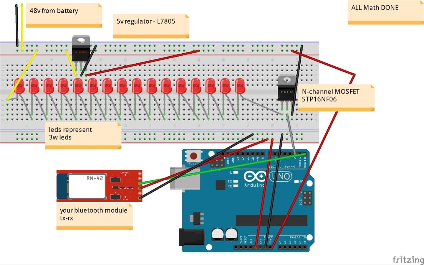

    the end design this should do it
  • atharvabenheckfan
    try making this neater than i did
    sorry i could not vary the wattage of the leds
    if you already have an arduino
    just buy a new atmega328p,put in in your arduino program it
    remove an put it in your project wire it all up according to the datasheet on the arduino website.
    you will need to put a 16 mhz crystal and two 22pf caps to pins 9,10
    just to be on the cheap side
    use a vreg that can regulate from 50 volts not 35 or you'll fry it
