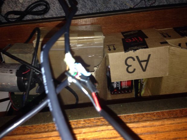

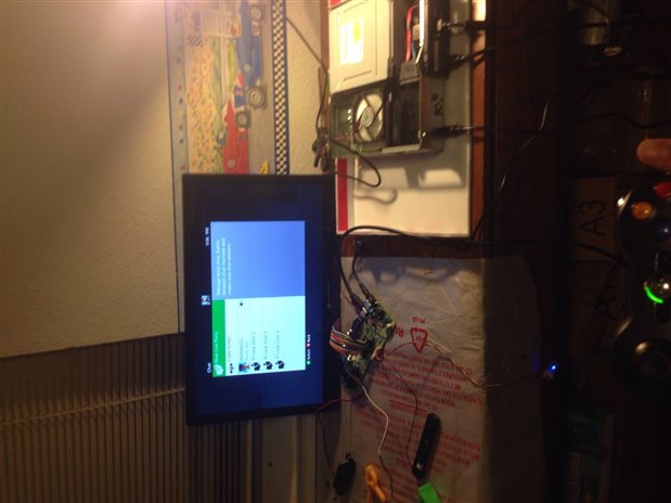

I am building my very own Xbox laptop using an Xbox 360e and element 19" 12v tv 2.5amp. I have tried looking up different ways of drawing 12v from the 360e and came across using the Kinect or original fan power source only problem is that i don't want to fry my TV. A drawn diagram of the different places to draw 12v at 2.5 amps would help tremendously. I have also heard that you can draw some amount of power from the sata cord. Thank you
    0 e14 Contributor over 11 years ago in reply to gadget.iom
    It seems to big and complicated for my project and I want to find a way of using something that is already on the board that is safe. I am not going to use the fan, kinnect or hard drive ports from the Xbox so I'm thinking about using one of them. My friend is bringing a multimeter by later today so i think I'm going to run it and check the amps/v coming out of those 3 places.
    Ok so I made it home and I ran strait to my project and started to multimeter it in different places and found that the kinect has just the right power source so I wired everything up as temporary as posible and ta da it works. I am so thrilled right now. And please ignore the wallpaper. it was put up when I was born and now that I'm 17 Im too lazy to take it down. And also I wanted to put the consol back in the box to eliminate variable.imageimage
