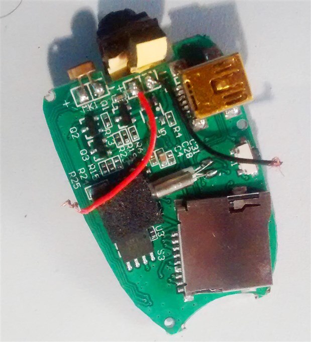

Hi All,
I am Nuwan from Sri Lanka. I want to replace micro-sd card socket in 808 camera with a SD card socket. The camera is as follows:
I want to replace this microsd socket and place sd socket.
Why I want to do this because. I want to use a EYE-FI card with this camera.
So I tried a micro-sd to sd extender cable but that wasn't worked. Please watch the video
I can't understand why it is not working when attaching the extender to the camera. I search for the forums but I didn't able to find any topic regarding to this kind of issue.
I want to know whether is it possible to replace this micro-sd socket with sd socket. If yes please tell me what pins should I connect to the SD card socket.
Thank you very much.
Nuwan

    How about getting one of these:

    0 e14 Contributor over 11 years ago in reply to gadget.iom
    Hi Paul Ellison
    I already purchased SD to MicroSD Card Extension Cable Adapter Flexible Extender Cable 24inch Long | eBay. I make it shorter. Can I expect that one to be worked with this. I have less than one month to submit this project so I haven't enough time to order one from ebay since it takes more time to deliver to my house.
    Do you have any idea why this camera not working with this extender.
    Thank you

    If you just want to swap out he card holder the following pin out may help.
    I think this link may be correct http://ficara.altervista.org/?p=156
    Is it?
  • gadget.iom
    0 gadget.iom over 11 years ago in reply to e14 Contributor
    Looks ok. I had that hand-drawn image on standby incase you needed further clarification.
