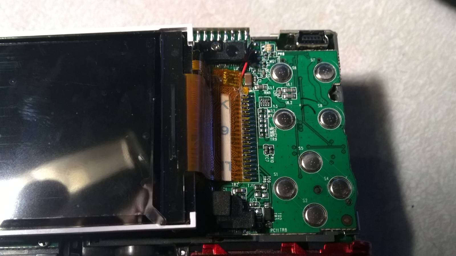

I am looking at increasing the length of a digital camera's display to be more heads up for a helmet. Say something similar to the Halo universes Gungnir or scanner helmets where there is not transparent visor but there is need to move the display from the SOC ribbon cable that has ever so tiny leads. I understand enameled wire may be needed(probably for the size) but the amber ribbon cable has me worried.

    Hi Blain, Can you send a picture of the ribbon cable. Many of the very flat cables do not have solderable wire in them. It is more like conductive paint. If this is the case it will be quite difficult…

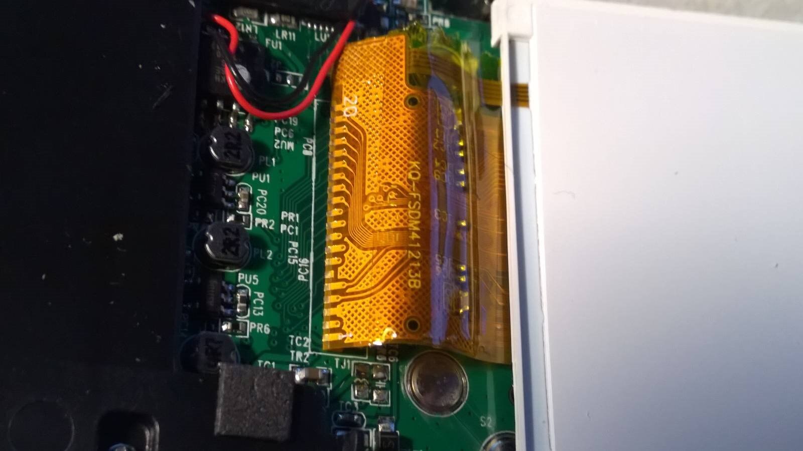

    It does look like the conductive paint you are talking about. The traces are terribly fine and there looks to be a few inline resistors inside as well. I know it's a long shot, and thanks for the quick reply!

    I could do it if I really had to but I would much rather not. I've had similar problems in prototyping with small displays.
    My approach would be:
    1) very carefully unsolder the display from the existing board - this is about the hardest part since you don't want to break or cook anything.
    (If it really is conductive glue I don't think it's really worth trying.)
    2) solder  a little pcb (that you will need to design and have made for the job) to the display. You will need to glue the flexible board to this bridge board as well as solder it.
    3) The bridge pcb will have little pads that you can solder wires to and the other ends of the wires can be soldered to the main pcb. You might be able to find a ribbon cable for this .
    Take care if you do this - most people break (beyond repair)  about the first five they try.

    John you know what, it might just be the best to grab a pi and a display and run if off a small battery pack with a webcam. I picked up this camera for cheap thankfully awhile back, plus the back of the display(seems like a tft display[I think] that was way to fragile for my careful hands) leads are full up integrated so no chance of reattaching anything. Being a tinkerer pays off sometimes finding problems after some things are brought to light from another. Thanks for the insight, looks like a different road for me is soon.

    Hi Blain, The one thing you have going for you is that they have terminated the cable with metal solder terminals. This gives you a place to solder though you will have to be very careful and somewhat quick on each terminal so that you do not over heat it and damage its connection to the conductor in the ribbon. I could not see the connections on the smaller ribbon cable or determine if it is a necessary part of the extension as well. At this point I would say that what you want to do is probably possible but be prepared to sacrifice your unit for science if the soldering doesn't go well.

    It already went south, and the smaller 4 lead cable on the side was for LED's for backlight. The display was that of a gameboy almost. But my swapping to a Pi will be a totally different experience. And Michael thanks also for the ideas.
