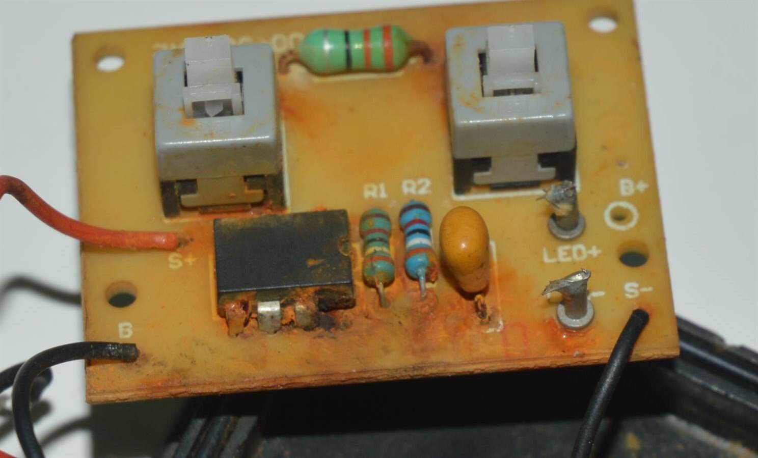

I have 3 sets of these solar faery lights:  http://www.amazon.ca/dp/B00CDC63HW/ref=sr_ph?ie=UTF8&qid=1433398110&sr=1&keywords=fairy+lights
2 of the sets have died after a year (Water got into the "waterproof" case)
Then I realized:  How the heck are they driving 100 LEDs off one 1.2V 600mAh battery???
Opening the unit didn't provide much information.  3 resistors, a capacitor and an unmarked 8 pin IC.
Did lots of googling, but didn't find an equivalent circuit.  Anyone have any ideas as to how they're doing this amazing feat?

    Here's the board -- not much to it. The one leg of the IC has completely fallen off. So you think the green component at the top is an inductor?

    Norman Davie wrote: Here's the board -- not much to it. The one leg of the IC has completely fallen off. So you think the green component at the top is an inductor? Sure looks more like a resistor…

    Under the green component, there is an 'L' !!

    That sounds about right, except I think you're off by an order of magnitude.  2A at 2V (approx voltage to turn on LED) is about 4W, or a total of 32 Wh if they're on for 8 hours.  Dividing by 3 gives you 10 Wh, but that's much more than the 720 mWh available in that little battery.
    So it's probably more like 1 mA current, which is enough to light a modern LED.  100 LEDs x 1 mA / LED x 2V x 8 h = 1600 mWh.  Dividing by 3 gives you 500 mWh or so, which fits the 720 mWh available from the battery less whatever losses I haven't included.
    How dim are these LEDs?
    Regarding the circuit, one of those resistors is probably an inductor.  That's the most efficient way to boost voltage.
    JMO/YMMV/I-hope-I-did-my-math-correctly

    Sure looks more like a resistor than an inductor.  Inductors are usually labled with an "L" instead of an "R".  Another possibility is that they're using the capacitor to make a charge pump.  I don't think a charge pump is as efficient as a boost regulator with an inductor, but they're simple.

    The green component at the top doesn't have any labeling on it at all.  The writing at the top says ZY-LBS-003 -- I assume that's the board revision.
    The capacitor is only 1uF.   If the green component is an inductor,  according to the chart below it appears to be 33 uH +/- 10% -- which doesn't mean anything to me image
    http://www.instructables.com/id/Inductor-Color-Code-Guide/
    This is becoming quite educational for me.

    Under the green component, there is an 'L' !! image
  • cowboy3398
    0 cowboy3398 over 11 years ago
    This instructable gives me a simple circuit to try:  http://www.instructables.com/id/Joule-Thief-Circuits-crude-to-modern/?ALLSTEPS

    Although my assumptions in the math was off, I was able to realize the switch fast to appear on was correct. Now I realize it used the inductor to up the voltage which is a neat trick.
