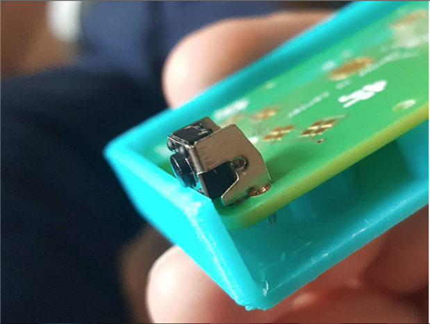

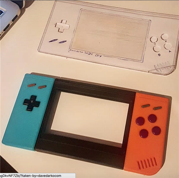

I have spent waaaay too much time on the design so far and I'm only at 75% of finishing it. It seems like the parts will arrive this Friday, so it's going to be a long weekend. I've set up a "war zone" for the project, a "FAME BOY only" table of 100 x 60 cm2. Today the button boards arrived from aisler.net, with a bit of drilling and snipping some plastic posts I was able to fit almost everything but the shoulder buttons. I've ordered a set of buttons again, this time in black! Every part you see needs to be reprinted though, to fit the shoulder buttons. I have the shoulder button design ready, and the bottom parts are ready for a draft print as well. I will try to fit everything in and then com back to the design later, when everything is placed.
