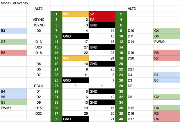

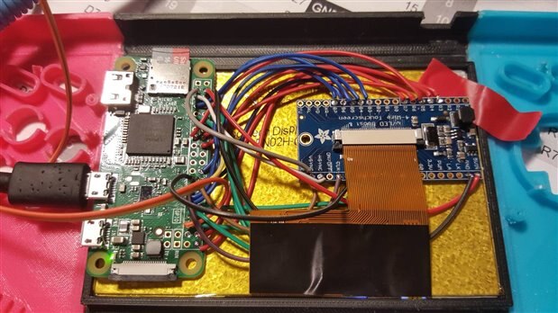

I'm that much out of ideas, that I've bought another display, just to check if I haven't zapped this one. Nevermind, there is an ON/OFF pin that you should definitely want to keep high image now it only needs some tweaking with the colors! This will be updated tomorrow! All clear, I changed the 0x7F013 to 0x7F014 at one point and the colors were off, now that it's changed back, it works!
So I've decided on using the Mode 3 (2nd) of the pinouts for RGB565 as seen here https://www.raspberrypi.org/documentation/hardware/raspberrypi/dpi/README.md
After a while I've figured out where to solder what cable and also managed to do the device tree overlay for the PI Zero W.
So for me the following exerpt proves that the overlay works, not just for the DPI but also the PWM pins. I even get pulses on clk, vsync, hsync and DE, but the screen stays white.

    Thanks image I wanted anyone who like me has never done this before to see how to tackle it. I've spend half a day trying to figure out where to solder what and the other half how to make it work, so I thought I would share! I'm currently soldering up the USB hub etc. and then put it together with the least amount of hot glue I can get away with image
