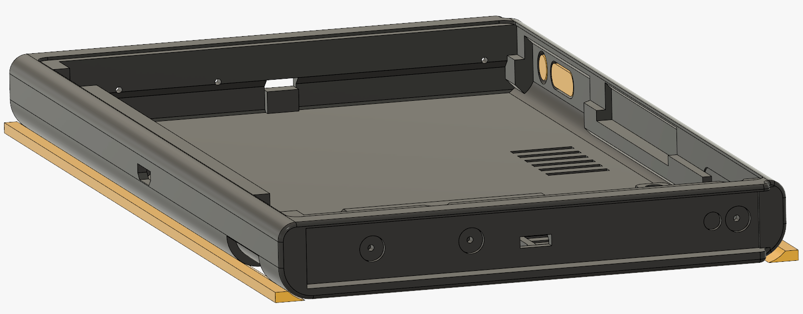

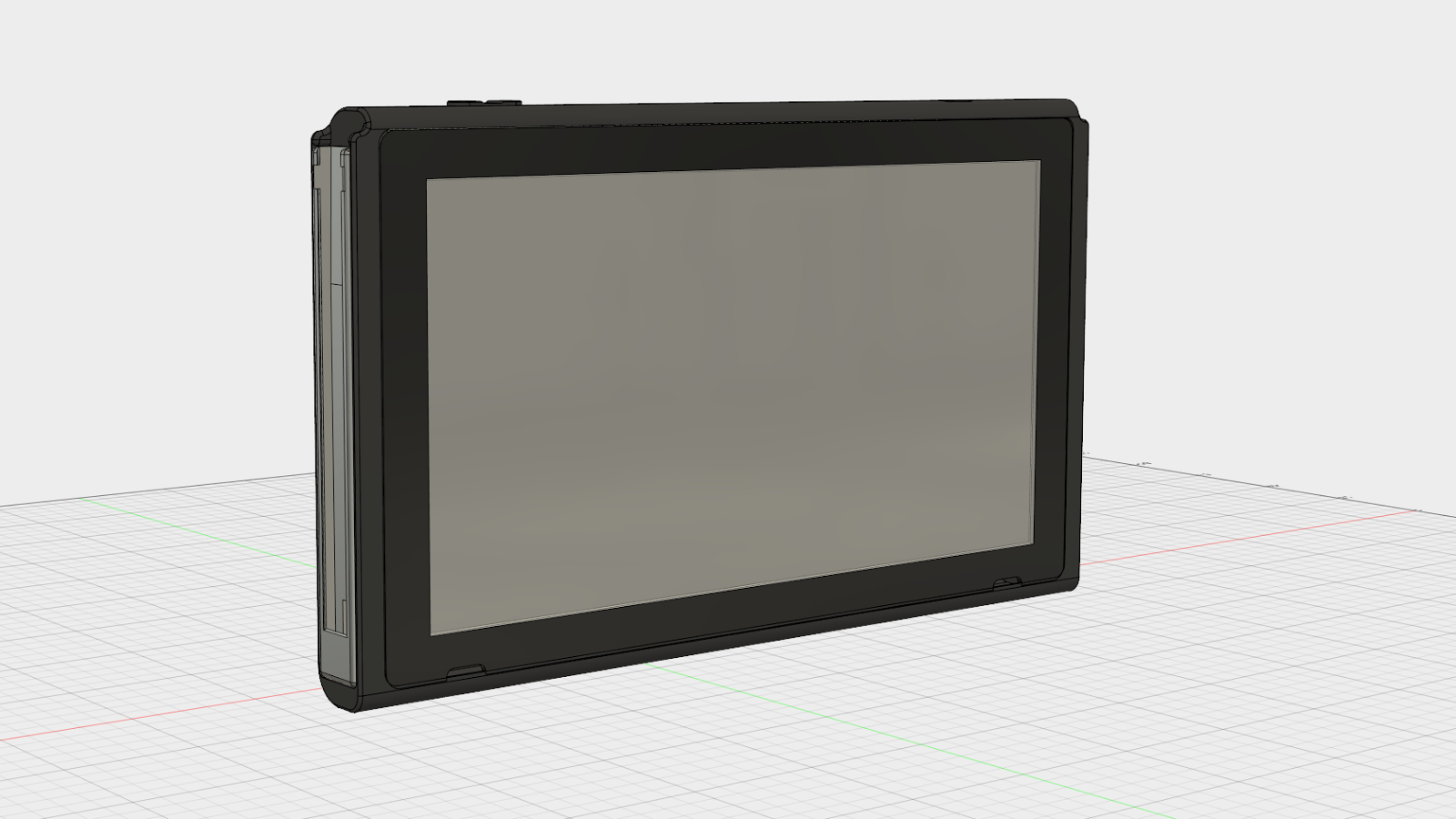

Designing the case

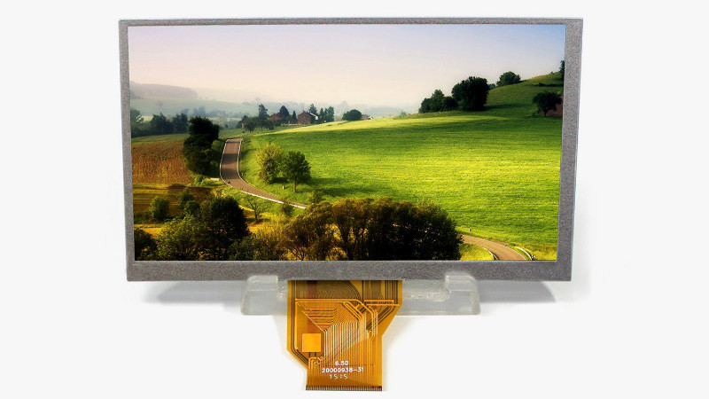

If I was going to reproduce the look of the Switch, then I needed to start by finding a similar looking screen.
there's probably a better display out there...

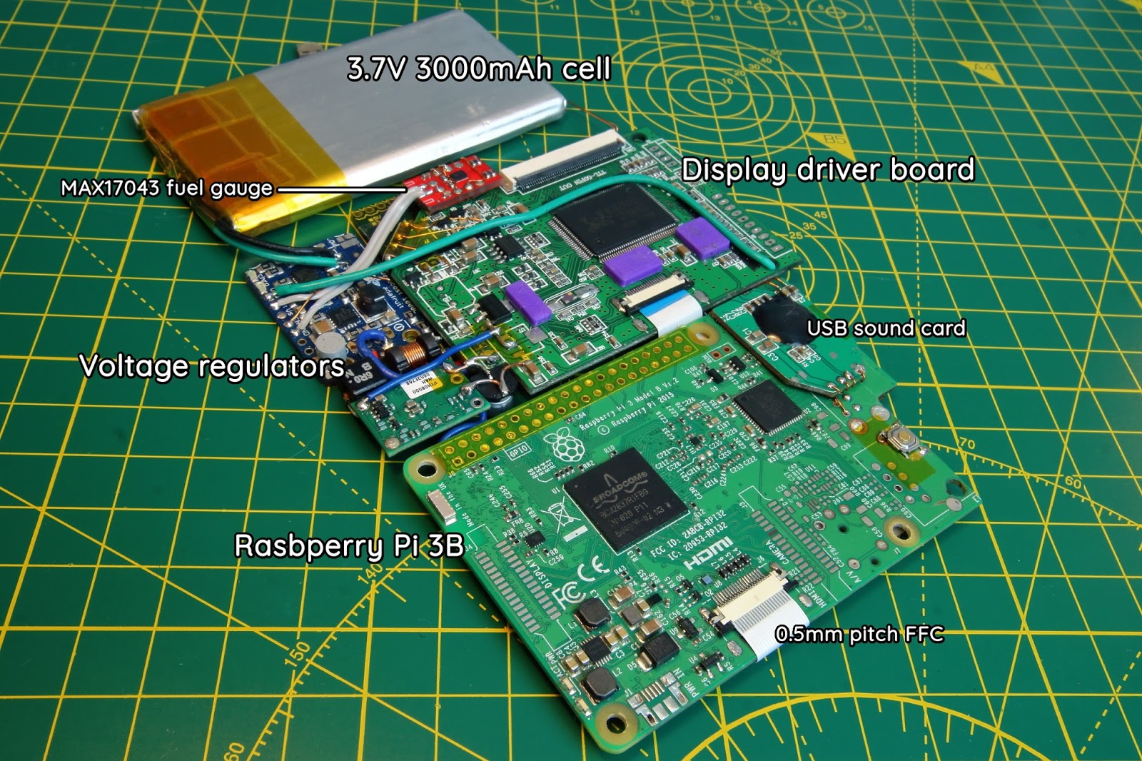

The Switch uses a 6.2" 1280x720 display. I couldn't find a monitor with the same specs, but I did find a decent looking 6.5" LCD kit. It has HDMI input and an 800x480 resolution (a curious 15:9 ratio, more on that later...) That screen is quite thick, (~6mm) but I still thought I could make it work, so started designing a case around it.

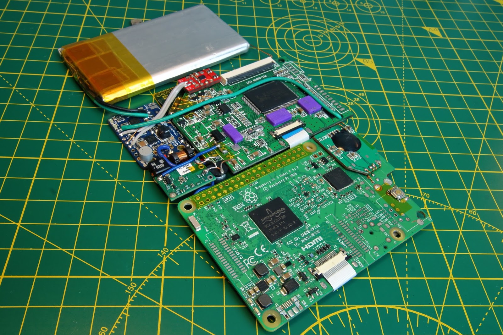

The Switch shell is pretty compact, it's only 14mm deep. (9/16") Almost half of that would be taken up by my chubby screen. So I'd have to severely slim-down the rest of the components to fit everything inside. I didn't take many photos during this process, but this is what I ended up with for the main internals...

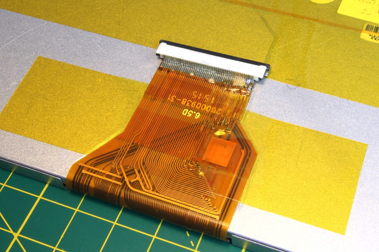

The HDMI ports have been replaced with 0.5mm pitch FFC connectors to eliminate the bulky cables. I removed the rest of the ports, relocated the taller components and tetris'd everything so it'd fit in the case. During the build I clumisly managed to rip the delicate FFC that connects the LCD to the driver board. D'oh. Luckily the tear only severed 12 of the 50 connections. I used some very fine magnet wire to bridge the damaged area, then globbed on some epoxy to protect the joints. I also added a socket so I could extend the cable later on.
be careful with FFCs like this, they're easily damaged

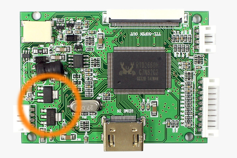

Power
I needed a way to step-up the voltage from my 3.7V battery to the 5V that the Raspberry Pi and LCD require. Initially, I picked up a cheapo eBay USB powerbank board, but couldn't find a reliable way to switch it on/off. I didn't want to physically switch the relatively high current that I'd be drawing from the battery, but because the part numbers had been ground off the ICs it was hard to find any sort of 'chip enable' signal I could tap into. So I scrapped that idea and opted for the well documented (albeit more expensive) Adafruit Powerboost 1000C. Rough tests showed I was pulling ~1200mA from 5V, this is slightly more than the 1000C was rated for...
I like this little module, makes things nice and easy
So I needed to save power. The Pi 3 was pulling ~450mA from 5V, but the display was sinking an extra 750mA! The display driver uses two linear voltage regulators for it's 3.3 and 1.8V rails. These regulators 'burn-off' excess voltage as heat, and dropping the main 5V supply down to 3.3/1.8V could be wasting a decent amount of power.
Replacing both of these chips with more efficient switching regulators would save power. But being mindful of space constraints, I only swapped out the 3.3V, and wired the input of the stock 1.8V regulator to the new 3.3V line. This saved me a fair amount of power, both in the more efficient 3.3V regulator itself, as well as doubling the efficiency of the linear 1.8V reg by having it drop a 3.3V supply instead of 5V. (3.3-1.8 = 1.5V vs 5-1.8 = 3.2V) After this change, the LCD consumed, just 400mA at 5V... much better. This reduced the total current draw of the system below 1000mA at 5V, allowing me to use the Powerboost 1000C in my portable with no problem. Now I had most of the electronics sketched out, I could turn my attention to the software and the interface...

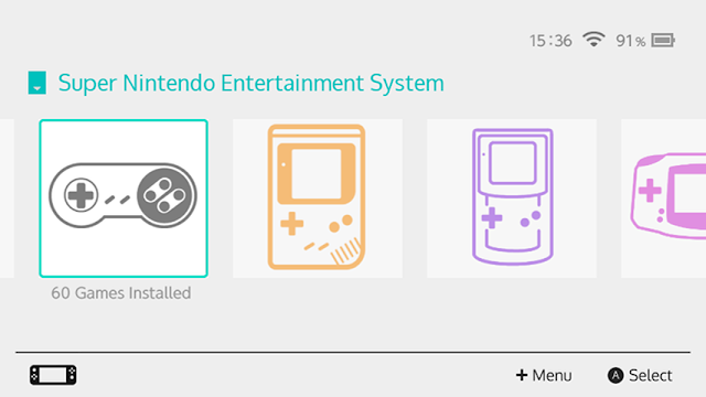

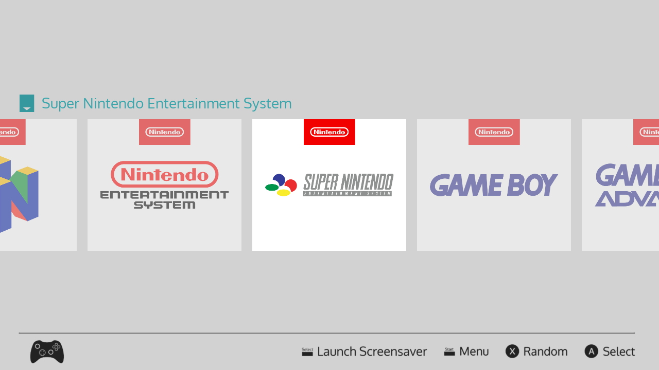

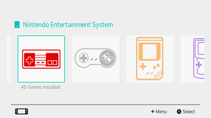

RetroPie
I've used RetroPie before with my mini NES and SNESs, but didn't ever delve into deeply customising the layout. It was this part of the project that took the most time though, and I actually really enjoyed it. Part of the inspiration for the SwitchPi came from seeing this fantastic EmulationStation theme by lilbud.
lovely theme by lilbud
I mentioned earlier that my screen had an unusual 800x480 resolution. This is slightly taller than the standard widescreen ratio of 16:9, potentially good news for a retro system, however the viewable area itself *is* 16:9?! It didn't make sense until I found out that the pixels weren't square like you might expect, but rectangular?! This is frustrating because there doesn't seem to be an easy way to correct for this ratio/resolution mismatch. The Official Raspberry Pi screen is similar, so I guess many people don't notice, but it really stands out to me :/
the actual screen makes everything wider, in this .gif it's the opposite, but you can see what I mean
If you look at the circles on the SNES controller then you might notice the distortion that needed correcting...
I edited the font and pre-scaled all of the new assets so they wouldn't appear stretched on my oddball screen. Hats off to the guys that write RetroPie themes btw. There is tonnes of work involved. I spent ages drawing icons and tweaking layouts, and I only did a handful of systems and I started from a very good existing theme.

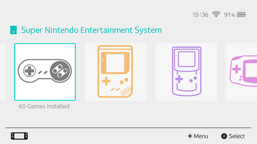

A fake homescreen?
The real Switch displays the time, wifi status and battery level on it's home-screen. Unfortunately there's no option for that in EmulationStation at the moment, but it would be nice to have those features on my SwitchPi. Modifying EmulationStation to show all that information properly is a bit too involved for my understanding at the moment, but I did come up with a decent-enough hack solution... for this project at least. In an ES theme you can obviously set background images, but you can also add other images to the screen. I noticed that these images get 'refreshed' every time EmulationStation restarts after exiting an emulator. So if I made a bunch of images to represent the time, wifi, and battery, I could swap them into the theme folder when appropriate to 'update' the clock/wifi/battery icons and re-create the real Nintendo Switch home-screen. I didn't want to be constantly writing to the SD card, so I set up a small ramdisk to store the temporary files. I wrote a Python program to convert the current time into digits and copy the relevant images into the ram folder. Similarly, I wrote a script that looks at the wifi signal strength and copies over an appropriate icon. Finally, a program talks to a MAX17043 chip to grab the battery charge data and copy it into the ram folder.
All of that together gave me a working fake home screen. Except mine only updates after you exit a game. Also the Raspberry Pi doesn't have a real-time clock, so it can only pull the correct time from the network. I didn't bother adding a hardware RTC, it's not essential by any means, and I was happy with my hacky solution.

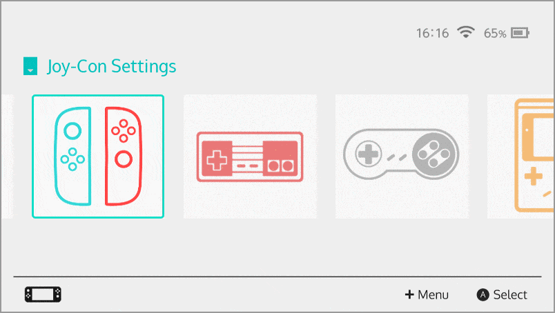

My next task was to have the Joy-Cons pair with the system at boot and automatically combine into one controller. Then afterwards, I wanted be able to combine/separate them for single and multi-player games. I'm far from an expert when it comes to writing code, but I came up with a solution with some basic Python. One problem with Linux Joystick Mapper is, if the controllers aren't found ie. before they've been connected then it will crash, so I needed a way to run it at boot, but only after both of the Joy-Cons have been paired. I came up with this script. It checks the output of 'hcitool' for the MAC addresses of my Joy-Cons. When it finds both of them, it runs joymap and copies the correct config file into the retroarch folder.
# Run at startup to combine the Joy-Cons into a single controller # (replace 'xx:xx:xx:xx:xx:xx' with the Joy-Con MAC addresses)  import subprocess import os from time import sleep from shutil import copyfile   def check_joycons():  joyConL = 'xx:xx:xx:xx:xx:xx'  joyConR = 'xx:xx:xx:xx:xx:xx'  btDevices = subprocess.check_output(['hcitool', 'con'])    if joyConL in btDevices and joyConR in btDevices:   return True  else:   return False     while True:  if check_joycons():   subprocess.call('sudo /home/pi/joymap/loadmap /home/pi/joymap/joycon.map &', shell=True, stdout=open(os.devnull, 'wb'))   copyfile('/home/pi/joycons/combine.cfg', '/opt/retropie/configs/all/joystick-selection.cfg')   copyfile('/home/pi/joycons/combine_retroarch.cfg', '/opt/retropie/configs/all/retroarch.cfg')   break  else:   sleep(1)
It's probably not the best way of doing it, but it's simple, works well and only runs once at startup. To combine/separate the Joy-Cons later on, I made a new menu item in EmulationStation with two options.
Now I can switch* between single and multi-player games and share the Joy-Cons with player two. Cool.       * ; )

Printing & Assembly
I only had enough room for the essentials in my case, this meant I had to be courageous and forego a headphone jack. But more seriously I also had no room for a fan, so my Raspberry Pi Switch would run HOT. Without any forced convection, the temperatures inside the case get too high (~50°C) for it to be printed in PLA. Instead, I used a black ABS from 3DPrima.com. It prints very nicely and held up to the high temps perfectly.
I printed the case in one piece, but because of the curves on the back I had to use some solid supports (the yellow pieces). I also went over everything with a sanding sponge to smooth some of the layer lines around the curve. I don't normally do this, but my printer struggles with curved underhangs, so it needed at least some attention. I should have done more sanding, but the little I did, went a long way and I was happy enough with the result. The last part of assembly was to make and fit a screen bezel. I picked up some Switch screen protectors, they were glass and didn't have a cut-out for the IR sensor so they'd be perfect to incorporate into my build. My plan was to mask off the visible screen area on the back of the glass and paint the outside border in black. This turned out to be trickier than I thought, it was difficult to get the mask straight and centered on all sides. After a couple of failed attempts I printed a jig to help align the masking tape. Eventually I got a result that was OK but not quite perfect. Most of it looks good, there's just one or two places where the edge is a bit rough :/
