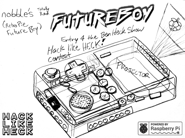

My entry build is Officially Titled: Nobble's RetroPie Futureboy
It is a portable emulation handheld resembling the well-known Gameboy with features NEVER BEFORE SEEN BY MANKIND! I have been time traveling to the past to find the source of Portable Video Game Consoles, as well as going further beyond into the future, learning how to hone modern technology in ways only dreamed of! I've based this on the Raspberry Pi 3, running a custom version of RetroPie from tweaks I made, and loaded with extra features!
Case: The handheld case is a custom mold for a Nintendo Gameboy DMG made by Kitschbent. I will be modifying the insides to make it more roomy for the components.
Main board: I am using an almost fully stock Raspberry Pi 3 that will have a hat screen attached on top. The only modifications I will do is removing one set of USB ports for hard wiring components.
Screen(s): I am using a 3.5" HDMI touchscreen "hat" for main display. GPIO will control the touchscreen panel. ON TOP OF THAT I am adding in a pico projector you can switch to, that will illuminate gameplay onto any surface of your choosing. That will be housed inside a Shark MX cartridge made by GameShark. It was a modem cartridge for internet access and email on the gameboy. Service was called GB-Mail. I'm sure it was indeed terrible.. CUE THE MEMES.
Controls:
I will be using an Arduino Pro Micro that will be setup as a USB gamepad with a layout seen commonly on most controllers these days. Dual Analog thumbsticks and dual triggers along with the usual d-pad and ABXY, Start, Select. I need a few 3D printed parts to install the button wells and button supports with ease. *Thanks Spencer!
Audio:
The goal is to have a working stereo audio Amp connected to the Pi so that when I insert headphones into the jack, the audio cuts out and goes to headphone line. I may end up going with mono, time will tell.
Batteries/Power: I am using a 3.7v 7000mah Li-Po cell that will be connected to a portable battery bank BCM PCB to regulate power @ 5v 2.1A to power everything. Charge port will be a Micro USB jack, and battery life is expected to be around 3-6 hours.
Other Modifications & Features:
I will be adding Programmable NeoPixel RGB LEDs all over inside the case so you can hail a UFO from space. What is a Futureboy without some new age colorful tech? I will be either programming them from the Pi itself, or Arduino. I also have a silicone cover to finish off the build aesthetically. It slides snugly right over the case for added protection.

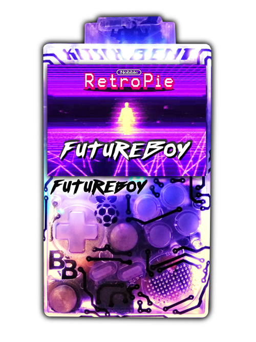

DMG Case Demo w/ Neopixels
Just look at how awesome Matt Kitschbent's custom clear DMG case looks with neopixels inside illuminating it!
I am almost done getting everything wired up and securely fit inside the case. I had a little snafu with Amazon, but after many hours with customer service I am finally getting the last parts I ordered 2-day shipping and still aren't in hand. I have wasted a few days with this and have been editing my video in the meantime. But I did order a new soldering iron since I seemed to have ruined all of my tips during this hasty build! A brand new TS100 is soon to be mine!
The final video is due April 2nd. I have much faith in this entry and feel it a top 10 prize winning project for sure! The video will testify.. #hack2thefuture #futureboy
I hope I can get the support from the people of this site and the community of all makers, modders, hackers, DIY-enthuseists alike to help vote for my entry upon time. I have had so much help and support so far from the community, and my official sponsor Kitschbent LLC. It's been lots of fun! image
