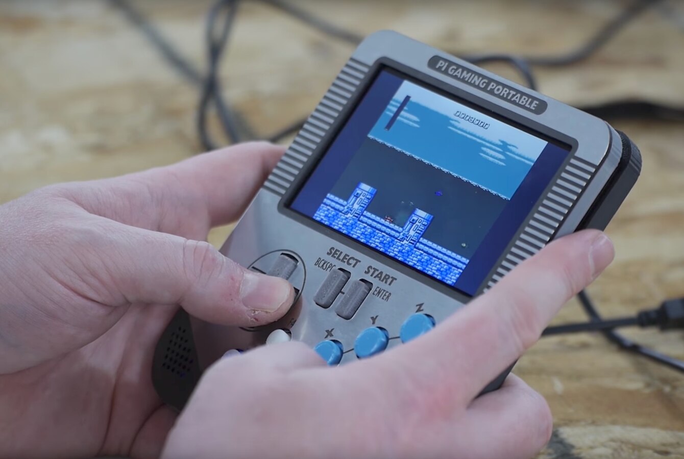

In terms of answering the question of how to make Ben Heck's original build better (see Part 1 and Part 2), it is important to note that Heck's design already has a lot of merit – which is what makes this challenge particularly interesting. It's a great compact little device, and not using HDMI was a neat technical feat. More importantly, it's hard to understand how difficult it is to complete creative work with a deadline unless you do it yourself.
However, I am arguing that the intent of the build very abruptly changed from making a portable Super Nintendo Mini, to instead making another fairly generic portable MAME device (especially with that 6 button layout typically used for street fighting arcade games). That is still an impressive thing to pull off, but I was left wondering what we could do to make the gameplay experience more SNES–like for the fans of the show.
Heck's latest portable gaming build that contestants should be using for inspiration. We also saw similar popular builds in 2013 and 2015.

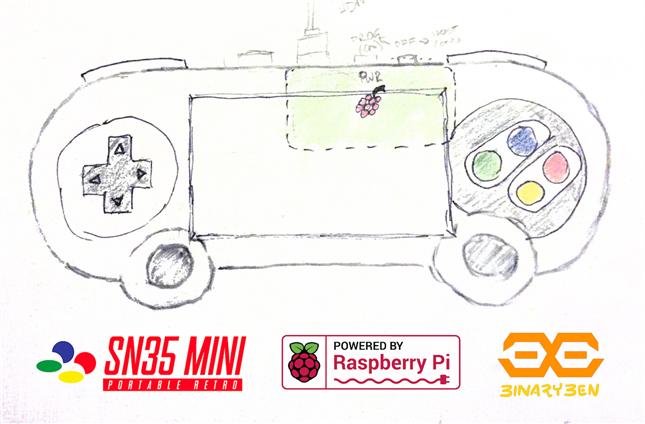

With that in mind, my idea is to replicate Heck's latest portable MAME build for the most part, but focus on better emulating the look and feel of the classic SNES controller. In terms of what will change electronically, I'll probably end up using a RPi Zero W and will therefore need to add a DAC for sound, as well as an ADC for joysticks (potentially!). I will also hopefully allow retro USB controllers and a HDMI screen to be plugged in for a big screen, multiplayer experience if the Pi Zero has the power to handle it.
A concept drawing of the proposed SN35 portable gaming system. Snazzy logos included! What would you change, if anything?

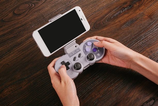

The concept for the SN35 Mini draws on inspiration from many classic gaming devices. The obvious examples include the layout of the Dualshock controllers and PSP from Sony, the original Nintendo Game Boy Advance, and of course the aesthetics of the SNES system itself. However, a lot of the build is also going to be loosely based on a commercial product called the SN30 Pro by 8Bitdo. In many ways, I am hoping to build an open source, elongated version of that with a built in screen! That is also the inspiration for the naming (my device's name can be read as "SNES Mini" if you're a gamer though.. so it's better hehe).
The SN30 Pro by 8Bitdo. I've never used one, so please don't consider this an official endorsement. They seem to review well though.image

    davedarko and binaryben Yes you can put out hdmi , gpio(tft) and composite at the same time (I tested it out yesterday with the A+ and RPI3 ), but you have to decide how you want to output the sound (you…
  • binaryben
    binaryben over 8 years ago in reply to davedarko +1
    From what I've read, it's possible to have both with a bit of hacky code (and Mayer apparently has it working already). To be honest, I'll probably just be aiming to allow for either or to start with,…
  • davedarko
    davedarko over 8 years ago
    Cool image  a lot to read. About that speaker on the PI zero, wouldn't that clash with the buttons and display connection that take all the gpio? maybe a little hub would help with a tiny usb sound card instead?
  • binaryben
    Thanks for reading it Dave! It is a lot. It'll probably be the longest I post, but I wanted to get most of that out the way asap so I can go into more about the project in later posts. image
    Good question, hasn't considered a tiny USB sound card and I think I actually have one. The other potential was to use an Atmel chip as a USB HID because I'm looking at having joysticks.
    Which do do you think is better? USB HID or sound card?
  • davedarko
    davedarko over 8 years ago in reply to binaryben
    Depends on how well you are versed in the AVR stuff, it's always possible to hack something together in Arduino. I say take what needs less time to setup, there's enough stuff to concentrate on. As long as you don't skip on the essential goals you've set for yourself earlier, no one will notice or care, I think image
    From what I've read, it's possible to have both with a bit of hacky code (and Mayer apparently has it working already). To be honest, I'll probably just be aiming to allow for either or to start with, even if I have to change the config files before booting each time. Unfortunately due to time constraint I'll just be aiming to design and build the hardware so that it can support features I want to try in the future.
    You're right about that arm! Now I can't not see its weirdness either. And good point on picking whatever I am most familiar with.. I'll try to play with both really quick and pick one from there.
