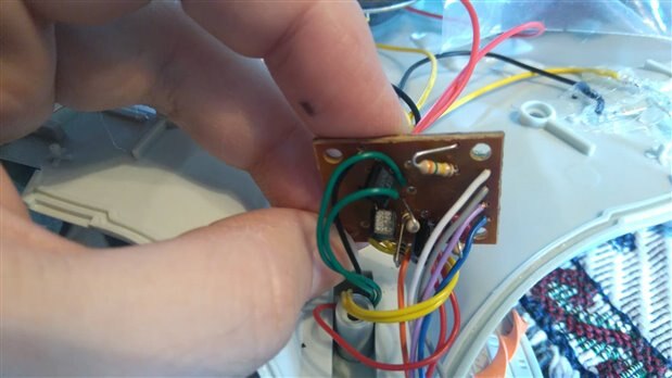

Im trying to repair my Enterprise-D starship toy from the early 90's. The nacells will not light up. I replaced the capacitor and the sound is working properly but still no lights when button is pressed.

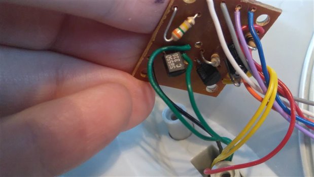

When I use my tweezers to jump the image directly to the lines going to the nacells, they light up when buttons are pressed. Jumping the image,  bypasses the S8550 transistor. The 2 green wires are the positive wires leading to the nacells. Which are on the emitter side of S8550, i assumed it's the emitter side of the transistor.

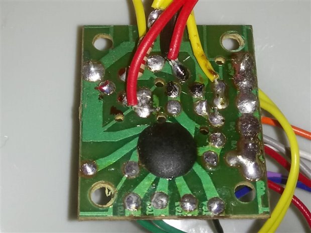

I've traced the pins on both transistors and i have no idea about transistors and included photos of the markings on the transistors.
S8550
- pin 1: on the trace to the nacells
- pin 2: on trace to ground
- pin 3: on the trace to image
S8050
- pin 1: on the trace to image,  shared with pin 3 of S8550.
- pin 2: on the trace to chip
- pin 3: on the trace to ground, shared with pin2 of S8550.
I've colored the solder points of the 2 transistors to show where they are located if that helps, i dont know. S8550 red marker points, S8050 black marker points. The far right black marked solder point is pin 1 image S8050, which follows up around to the left of the board to the far left red marked solder point, pin 3 image S8550.
Im just trying my best to disply them in case it will help you. Im very confused about what transistors to order, i want to just replace them both and be done with it but the pins are soldered differently and its confused me.
Do I need PNP or NPN? what voltage rating should I use? 40v 0.5A or 24v 1.5A?
If anyone can help so I can get my Enterprise-D working again, i'd greatly appreciate it. Thank you very much!
