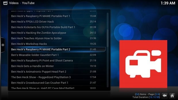

There are two main ways you can watch The Ben Heck Show on your media centre, the first is to use the YouTube add-on, you can sign in to your Google account (if you want) and browse your subscriptions. Or you can search YouTube for "The Ben Heck Show" and play an episode you can see how this this can look (depending on how you setup the YouTube add on) in the following gallery:

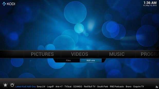

{gallery} The Ben Heck Show - YouTube

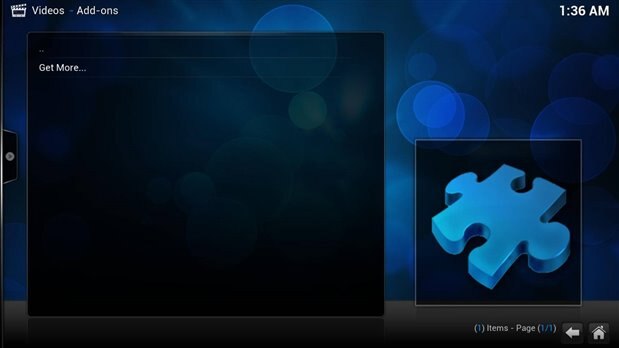

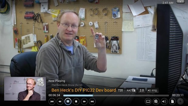

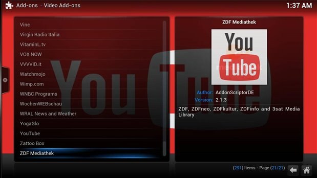

YouTube Add-on in Kodi: Under 'Videos' you can find 'Add-ons'

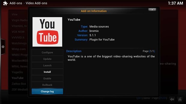

YouTube Add-on in Kodi: If we don't have any add-ons we'll want to 'get more', alternatively manage add-ons under 'System'
YouTube Add-on in Kodi: YouTube is listed, select it
YouTube Add-on in Kodi: Then choose 'Install', once installed we can use this screen to configure it as well

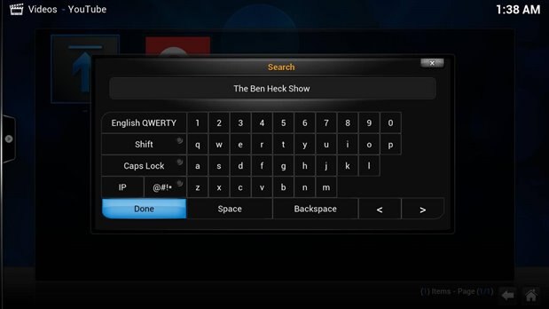

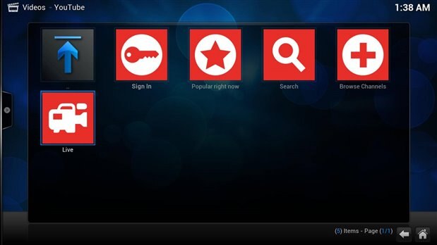

YouTube Add-on in Kodi: When we run the add-on we can choose to sign in, or go to search
YouTube Add-on in Kodi: If you've got a keyboard plugged in this step is a LOT easier
YouTube Add-on in Kodi: We can now select and play an episode or playlist! Settings like quality are in the add-on options.

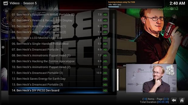

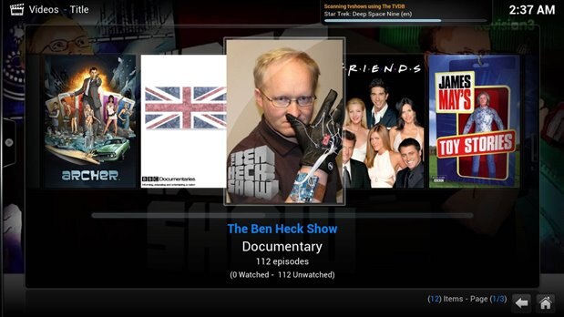

The second way you can watch The Ben Heck Show, is if you download it yourself and set it up as a TV Show!
Yes, even though The Ben Heck Show is not on cable or your digital television (at least that I know of, would that be cool?) you can setup your media centre to browse films and tv shows and have The Ben Heck Show appear as one of them. When you have your media centre installed, it does not list 'TV Shows' or 'Films' by default until you actually add folders to your library (as covered by Ben and Felix) and set their source.

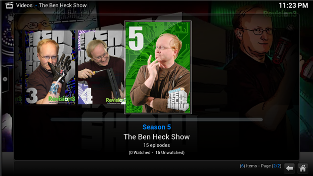

Leaving your 'library' without setting a source where you can browse video files is fine if you just want to browse files as they are. However I like metadata and pretty pictures. I like The Ben Heck Show appearing like this:
{gallery} The Ben Heck Show in Kodi
The Ben Heck Show in Kodi: Tadaa! It's a documentary, who knew?
The Ben Heck Show in Kodi: Seasons have art for them, Revision 3 used to host TBHS, now it's element14
The Ben Heck Show in Kodi: Season 5 episodes! I didn't grab the latest one yet.
The Ben Heck Show in Kodi: Ah Ben, you teach us so much.

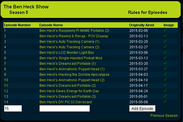

I'll tell you, do not worry! Before I go into downloading the YouTube videos (frankly, you may already have a method yourself, feel free to use any method you personally find, but I have one I will introduce), I want to introduce to you TheTVDB !

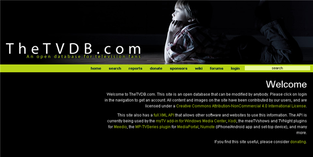

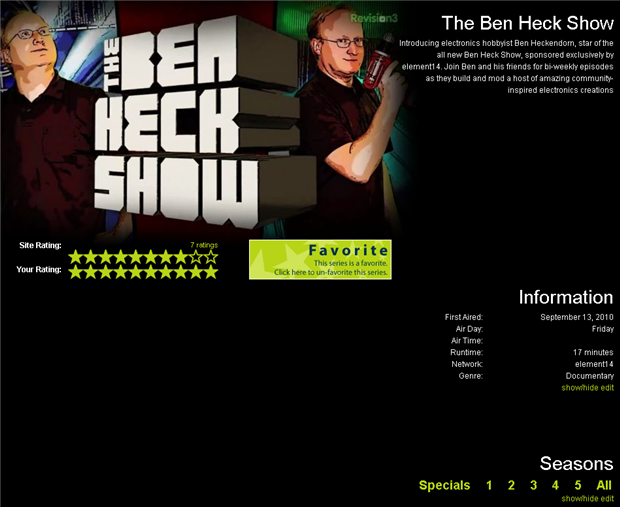

Some time ago, in the days of the original XBox games console, it was hacked and cracked. Thus, XBMC was born (XBox Media Centre) and every pirate and possibly legitimate person whom backed up their DVDs put all of their media onto the XBox hard drive and needed a way to browse their films, television shows and other files. What people then wanted, was a fancy way to browse said files using graphics and titles from the shows or themed by them. Thus, websites such as The TVDB was born.
These days, XBMC is known as Kodi, which has spawned into various different derivatives across platforms. One being OpenElec. When you follow Ben Heck's video on setting up your network share and you add a video source as 'TV' the default website the media centre will use for 'scraping' (that is searching and identifying) episodes will be TheTVDB.
It is also entirely community run. If you want to add an episode, make sure the descriptions are correct or upload graphics, then you can! There are also forums where you can contest whether or not episodes or series are named correctly. It is here where I recently had the administrators ensure that The Ben Heck Show had a Season 5.
Under each season it then lists the episodes, and how they are named for TheTVDB to recognise them:
These are definitely not necessarily accurate, I have been going in and editing some of the episodes to make sure they're correct but it's definitely a community effort, for example there's no graphic for Season 5 at present - especially since Revision 3 stopped running the show. You can have DVD Covers or Wide Banners.

This is now playable in OpenElec/Kodi, but we need to rename the file to something which TheTVDB.com can scrape.
mv "Ben Heck’s Raspberry Pi Media Center-P7m6HTV7ysM.mp4" "The Ben Heck Show - 5x15 - Ben Heck’s Raspberry Pi Media Center.mp4"
Now all you need to do is update your library and it will be scraped successfully and show up in the menus as the screenshots above.
