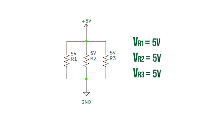

In the episode, Derek simplifies the process of dealing with complex resistive circuits. He compares the flow of current to water flow, with the resistors represented by water valves that allow different amounts of water to pass. He highlights the difference between series and parallel resistor arrangements. In a series configuration, the total resistance is the sum of individual resistances, but each resistor experiences the same current while bearing different voltage drops. On the other hand, parallel resistors share the same voltage while dividing the current based on their respective resistances.

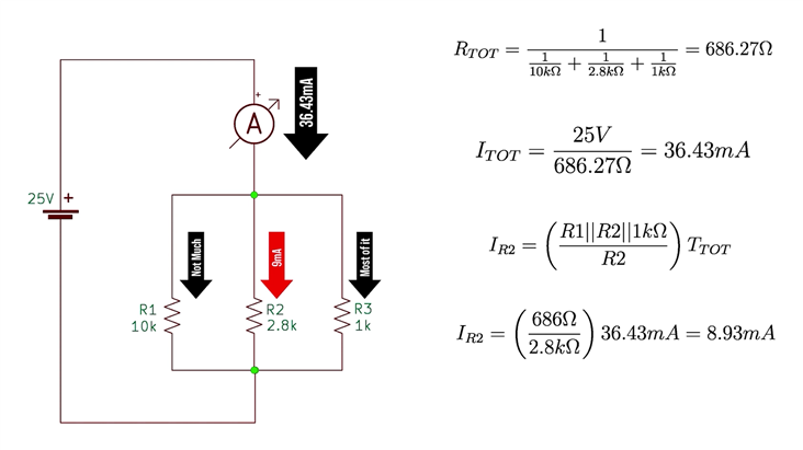

The video continues with a breakdown of a more intricate circuit, where the combination of resistors requires deeper analysis. Applying Kirchhoff's laws and the current divider rule, Derek showcases step-by-step calculations for determining currents through resistors in parallel. He emphasizes the importance of understanding the interplay between resistances and currents to achieve accurate results. Through meticulous application of Ohm's law and Kirchhoff's laws, Derek determines voltage drops, currents, and power ratings across all resistors. He underscores the practical relevance of mastering these concepts for various real-world scenarios.
