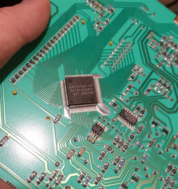

The micro controller is a Mitsubishi M37410M4HFP:
Here it is in person:

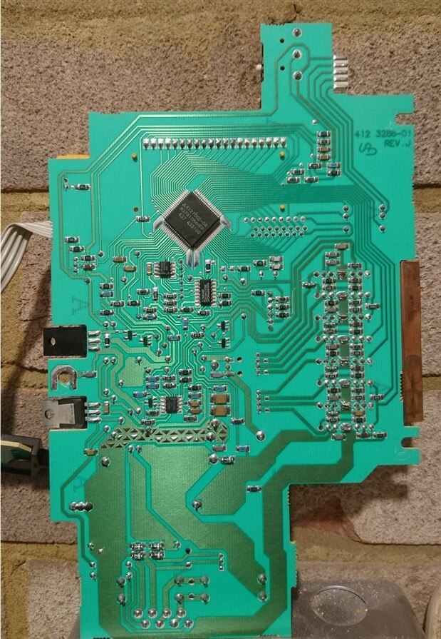

Here is the whole PCB close up:

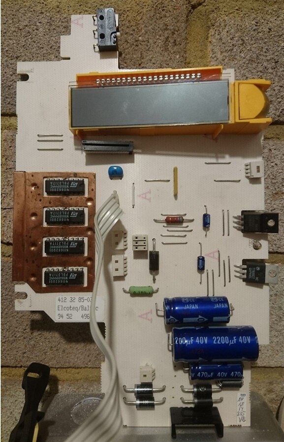

And the Front, just for context:

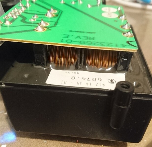

Unfortunately the transformer is potted into the top half of the enclosure:

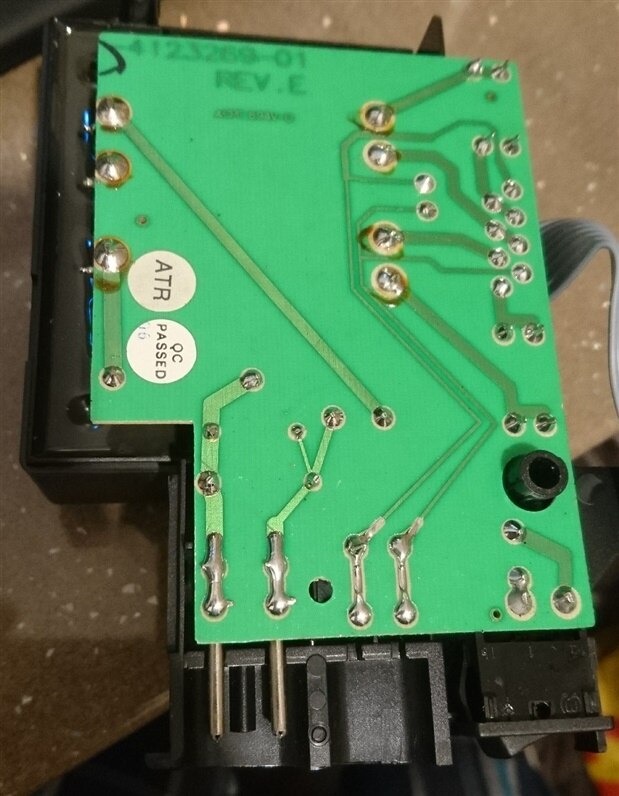

But in case you are interested, the PCB attached to the windings has the AC input and switch at the bottom, the output through the ribbon cable, and 2 quick blow fuses adjacent:
