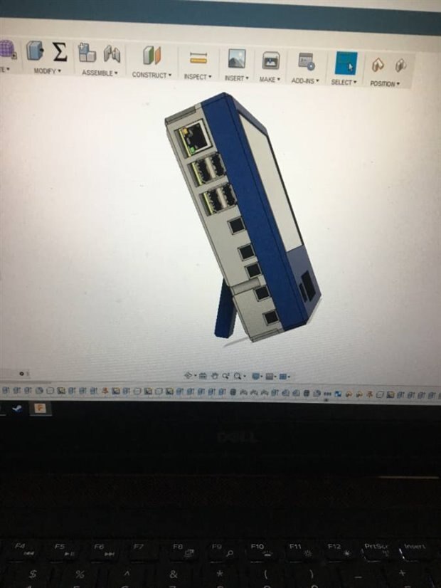

    It features a custom 12.6V battery pack made from 3 li-ion 18650 batteries, a 7 inch display, a built in 8ohm speaker, a potentiometer volume knob, 5 buttons to control the settings of the LCD panel, HDMI out for playing on a larger TV, audio out for headphone use, and up to 4 player gaming with wireless xbox controllers.
    Here is a view of the 3D model in Fusion 360 that I designed. The case is entirely 3D printed using my TEVO Tornado and the device currently stands today as my primary game console image.

    Great project, have you considered upgrading to a Pi4? With a mod for cooling you could have a killer machine there?
    Good luck, I like table PC cases, so why not an Xbox version!
  • zacoulou
    zacoulou over 7 years ago in reply to a531016
    Thanks! I hope to make an improved version at some point with the pi 4, but I added a heat sync and a small fan to this version recently that allows most games to run smoothly.

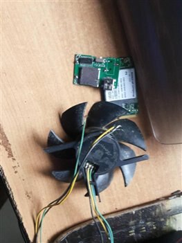

    Am sorry I have done a really small Hardware mod with my laptop on which I play Games. My laptop often gets super hot during gaming sessions. I just added a external CPU fan taken from a old desktop. i had also added a extra WiFi card for wireless pen testing.
    I had detached the parts from my PC during holiday break out!

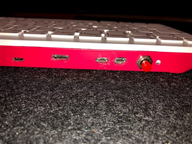

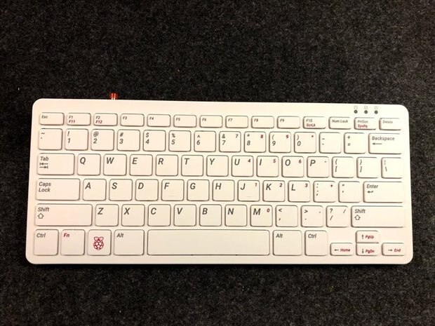

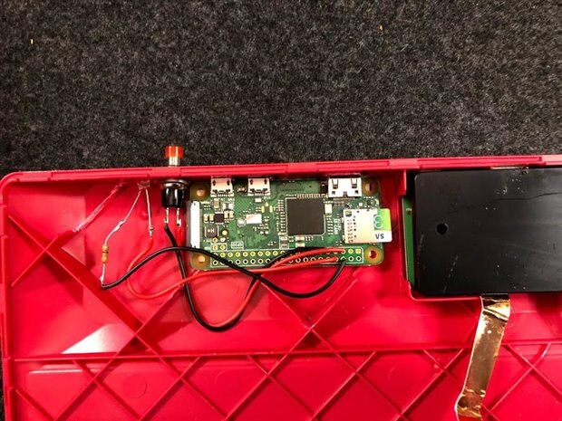

    I am not sure if this would count as modding a handheld or gaming system, but I did mod an official Raspberry Pi keyboard and added a Raspberry Pi Zero W to it. I cutout holes for the HDMI, USB and power ports as well as added an LED and power button for safe shutdowns.

    Here is a top-down view of the keyboard with the power button sticking out
    Inside of the Pi with power and LED wires hooked up
    Here is the back view with the holes cutout for the cables

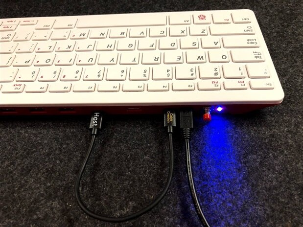

    Here is another back view with the cables attached and power on. Had to purchase a short USB Micro to USB Micro for the Pi to Keyboard. I may solder those pins later on to lessen the clutter, but I enjoy using this as a keyboard for my other PIs and having this one internal
