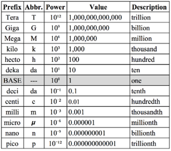

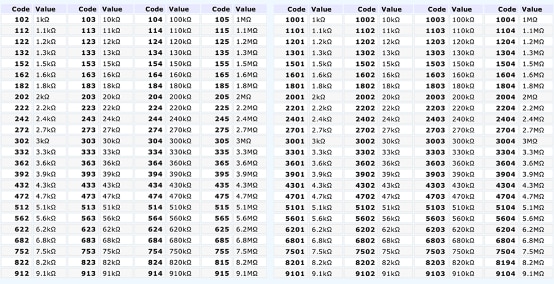

Look at a list of standard resistor values.  Compare the abbreviated numbers with those on the prefix chart.  A resistor that is 4700 ohms is called 4.7 K ohms or kilo ohms.  A 100,000 ohm resistor is 100 kilo ohms.  A one million ohm resistor is 1 mega ohm.

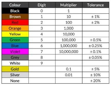

There are through-hole resistors and surface mount resistors.  Through-hole resistors have color bands on them. Resistors use a color coding system to indicate their value as well as their tolerance. Tolerance is the accuracy or margin of error of the resistor rating. This can Range anywhere from a fraction of a percent up to 20 percent.  You can use the color coded resistor chart below to determine the digit multiplier or the tolerance that the color band represents.
Resistors can have a varying number of bands on them. We’ll focus on four and five band resistors as they are the most common.  On a four band resistor the first two stripes are combined together to form a number between 1 and 99.  The third stripe is the multiplier and the last stripe marks the tolerance.  On a five band resistor, the first three stripes get read as a single number, while the fourth stripe is the multiplier and the fifth band represents the tolerance.  Most five band resistors are precision resistors with tolerances of 1% or 2% indicated by a brown or a red band on the far right. While most of the four band resistors have tolerances of 5% or 10% indicated by a gold or a silver band.  If the resistor has no fourth tolerance band then the default tolerance would be 20%.
Resistors with a single black band are zero ohm resistors. Since they have the same packages as other resistors they can easily be placed on a PCB by automated machines. They’re often used as wire simply to connect traces.  Karen shows you how to figure the values of some four and five band resistors.
