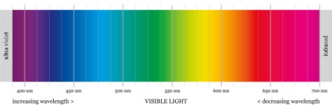

LEDs, light emitting diodes, use energy from the particles moving through the p-n junction to create light. They can do this because they are made with gallium arsenide. Unlike silicon diodes, diodes made with gallium arsenide release energy in the form of light or photons. Like other diodes, they typically have 2 leads, though these can vary in length depending on the manufacturer. LEDs come in a wide variety of packages. Through-hole LEDs can be 3mm, 5mm, 10mm. They can have round and square lenses. Lenses can be clear or colored. 5mm round ones are the most common through-hole LEDs.  Surface mount LEDs come in a variety of sizes as well. When choosing an LED, one of the first things you’ll look for is color, or wavelength. (Chart-VO) Here’s a chart of the color spectrum. Another choice you’ll have is beam angle or viewing angle. Beam angle is the amount of degrees where the light is visible. Depending on your application, you may want a narrow beam angle, like 10deg or a wide beam angle, like 120deg. Where common light bulbs are measured in watts or lumens, the brightness of LEDs is its luminous intensity and it is measured in millicandelas or mcd.  The higher the number, the brighter the light. A standard LED could have a luminous intensity of 7mcd, whereas a super bright LED could be 120mcd. LEDs can have a range of voltage and current ratings. They have both a minimum current and voltage required to function properly, or even at all, as well as a maximum voltage and current, that if surpassed, can shorten the life of the LED or burn it out completely.

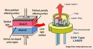

While LEDs emit incoherent light, laser diodes emit high-intensity, coherent light. They do this by having a P-I-N, or pin junction rather than the standard p-n junction. The PIN junction has the standard P-type and N-type regions we’re familiar with. But between them there is an area of undoped, or intrinsic, semiconductor. At the junction, in that intrinsic layer is where all the magic happens. When current flows through the diode, energy is released in the form of photons or light into that intrinsic layer. But it doesn’t stop there. In a laser diode, the p and n-type regions have polished, reflective ends, which causes the photons to reflect back and forth, hundreds of times, in that intrinsic layer. The photons eventually escape in the form of a laser beam. You can usually see where a laser hits a surface, but you can’t always see the laser beam itself. If you can see the laser beam, be extra careful. A high powered laser has the potential of causing permanent damage to your eyes.
