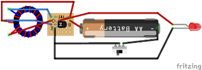

Inductor Project: Battery Juicer
The Learning Circuit | element14 presents |  Project Videos
Learn how to get more bang from your battery by using an inductor to make a battery juicer that can run a flashlight off a single, used battery.

    makerkaren great episode, a useful example of these fundamentals. What controls the frequency of oscillation? Shouldn't there be a series resistor for the LED for when the battery is full?
    And a general thought, perhaps you could make the circuit long and thin and fit it into the battery case alongside the other battery.
