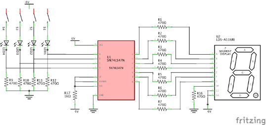

Karen walks through how to use one type of decoder in a circuit, a BCD to 7-segment. While this circuit would typically use a microcontroller to provide the four necessary input signals, Karen’s circuit uses 4 switches to allow the user to manually input the BCD number. This circuit is helpful for practicing counting in binary as well as learning how to drive a 7-segment display. This circuit uses a common-anode 7-segment LED display that is driven by an SN74LS47NSN74LS47N decoder. If you would like to create a circuit using a common-cathode LED display, a 74LS48 decoder could be used and the power would need to be flipped. Not covered in this or the previous episode, but a CMOS CD4543 could be used for driving liquid crystal display (LCD) types.
Bill of Material:
Product NameManufacturerQuantityBuy KitBuy Kit
Slide Switch, SPDT, On-On, 2.54mm, Through HoleAPEM4Buy NowBuy Now
Red LED, Through Hole, 5mm, 20 mA, 2.1 VLED Technology4Buy NowBuy Now
7 Segment LED Display, InfoVue, Red, 10 mA, 1.8 VLUMEX1Buy NowBuy Now
Through Hole Resistor, 1 kohm, 500 mW, ± 1%TT ELECTRONICS / WELWYN1Buy NowBuy Now
Through Hole Resistor, 470 ohm, 500 mW, ± 5%VISHAY12Buy NowBuy Now
SN74LS47N-BCD to 7 Segment Decoder / Driver, LS Family, 7 Output, 3.2 mA, 4.75 V to 5.25 V, DIP-16TEXAS INSTRUMENTS1Buy NowBuy Now
IC & Component Socket, 16 Contacts, DIP Socket, 2.54 mmMulticomp1Buy NowBuy Now
Prototype Board, Phenolic, 55 x 40 grid, 1.6 mm, 160 mm, 115 mmMulticomp1Buy NowBuy Now
Terminal Block, Header, 2.54 mmMCM1Buy NowBuy Now
BATTERY HOLDER 4 X AA, 6V, w/ switch, wire leadsOSEPP1Buy NowBuy Now
AA batteryPro-elec4Buy NowBuy Now

    Yay! At 3:07 you mentioned current limiting resistors! Thumbs Up. Like. Will Subscribe.

    While I mentioned the 74LS48, I actually had a hard time finding them in stock anywhere. I'm guessing common cathode is much less popular, or is just outdated. So maybe that's why no one stocks them anymore?
