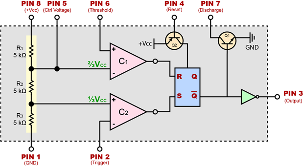

  • makerkaren
    makerkaren over 6 years ago in reply to beacon_dave
    It's very possible I got them flipped. I didn't compare my diagram with the in depth schematic that shows all the transistors. I was focused more on the transistor's role in the 555 than ensuring I had the pins laid out correctly. Pobody's nerfect? image
    If my diagram is wrong, I would be happy to be corrected. It's all part of the learning process.

  • jc2048
    jc2048 over 6 years ago in reply to beacon_dave
    This is from the ST datasheet for the NE555.
  • jc2048
    The emitter doesn't go to Vcc. The base-emitter diode forms part of a wired-OR circuit internally to force the state of the flip-flop (and the collector goes to the discharge transistor base so that it triggers the discharge at the same time).
  • beacon_dave
    beacon_dave over 6 years ago in reply to makerkaren
    Hi makerkaren - I was referring to the bit where you say "...if pin 4 is ever grounded, going low, the transistor is turned off..." and vice versa.
    However with a PNP type transistor if the base is made more negative than the emitter, it turns on. In the diagram the emitter is tied to +Vcc so pulling pin 4 to ground would presumably turn it on ?
    Pin 4 needs to be pulled high for the 555 to function (reset is active low), however by doing this it presumably turns the transistor off ?
  • makerkaren
    Do you mean the emitter and collector are flipped?
    The Learning Circuit continues to go from strength to strength.  image
    Regarding the section on the reset pin 4 (at 6:20 into the video) though, am I missing something or is the on/off operation of the PNP transistor illustrated here as being the wrong way around ?
