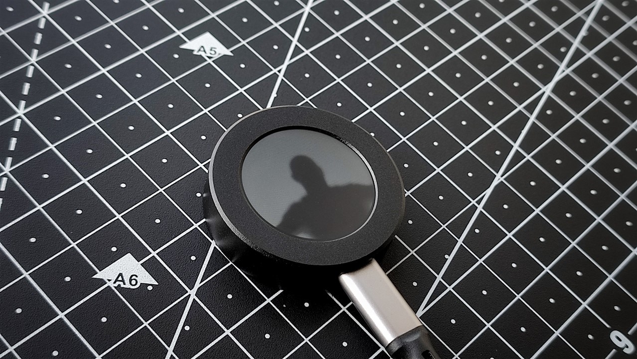

The story of this project really began with one of my earlier builds. I uploaded an Uncanny Eye Pendant, and in the comments, someone suggested that I should try making a Trapped Soul Pendant. The idea immediately caught my attention. When I searched about it online, I found it both spooky and fascinating. That’s when I thought to myself: Why not take this concept further? Why not make the soul inside the pendant feel real, alive, and struggling to escape?
And so, my project was born: SoulCage – The Digital Trapped Soul Pendant. This pendant doesn’t just look scary; it contains animated souls inside. The soul is always moving, always trying to escape from the pendant. To make it even more interesting, there are actually two souls: one male and one female. By pressing the side button, you can switch between them. The male soul is aggressive and furious, he bangs at the glass as if he’s desperate to break out. The female soul is calmer, quiet, and patient, as if she is waiting for the right moment to be released by the owner. Together, they make the pendant feel alive in a creepy yet fun way.
The build itself is simple and easy, even for beginners. It is made from only a handful of components, almost like putting LEGO bricks together. The heart of the device is the Waveshare ESP32-S3 Round Display, which drives the animations of the souls. Everything is enclosed in a 3D-printed case that also holds the battery and a small switch. The switch works in two ways: it turns the device on or off, and it also lets you change which soul is shown inside the pendant.
So, what looks like just a small spooky accessory is actually a tiny digital device with personality and story. It’s wearable, fun, and guaranteed to get attention during Halloween.

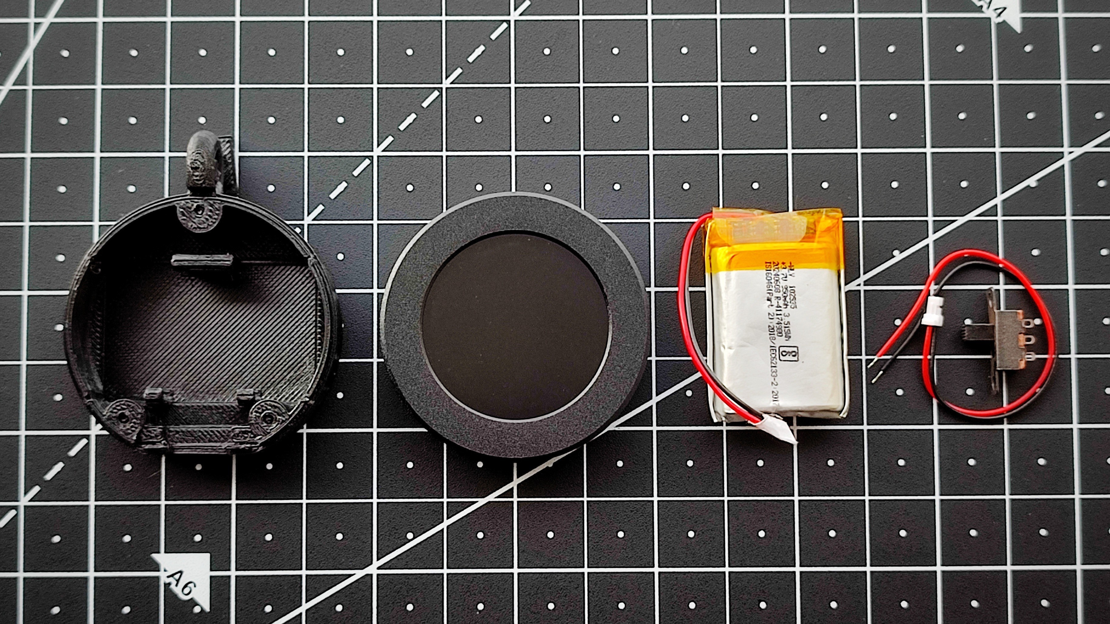

COMPONENTS:
- Waveshare ESP32-S3 Round 1.28-inch Display With CNC Metal Case [No Touch] (amazon.com/ amazon.in)
 - 3D Printed Back Cover
 - 3.7V 950mAh Lipo Battery (amazon.com/ amazon.in)
 - Mini SPDT Slide Switch (amazon.com/ amazon.in)
 - MX1.25 2P connector (amazon.com/ amazon.in)
 - Heat Shrink Sleeve Tube [1mm] (amazon.com/ amazon.in)

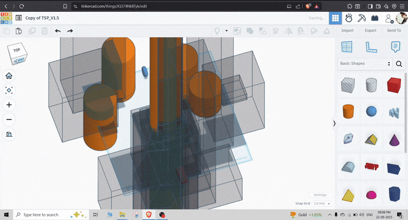

Designing the Custom Back Cover in Tinkercad
I designed a 3D-printed back cover for this project that fits perfectly with the CNC metal case. The design was created in Tinkercad, an easy-to-use online 3D design tool.
The back cover is made in such a way that the battery can snap-fit inside without the need for screws or glue. In the same way, I created a slot for the mini slide switch, so it can easily slide into place and stay secure, again with no extra mounting required. Finally, the back cover attaches to the CNC case using the original screws that come with the case, making the whole assembly neat and reliable.
STL with support : https://www.tinkercad.com/things/iuLhoR2B9iq-soulcage-with-support
STL without support : https://www.tinkercad.com/things/izTjHNzJxj2-soulcage-without-support

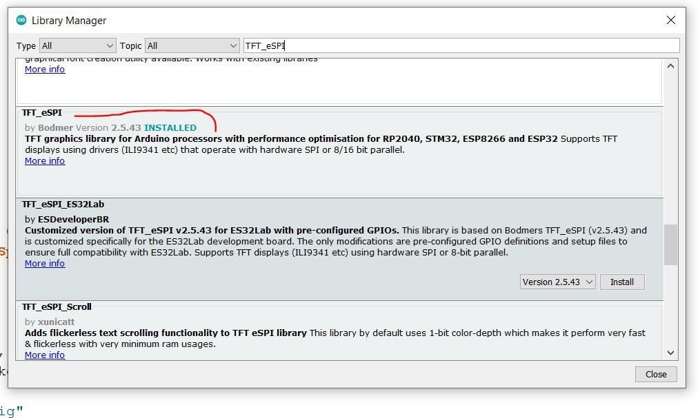

Setting Up the TFT_eSPI Library
To run the graphics on the round LCD screen, we need the TFT_eSPI library. This library is designed to drive many different displays, so we must configure it properly to work with the Waveshare ESP32-S3 Round Display (No Touch). Follow the steps below to install and set it up.
1. Installing the Library
- Open Arduino IDE.
 - Go to Sketch > Include Library > Manage Libraries.
 - In the Library Manager, search for TFT_eSPI.
 - Install TFT_eSPI by Bodmer (version v2.5.43 is recommended).

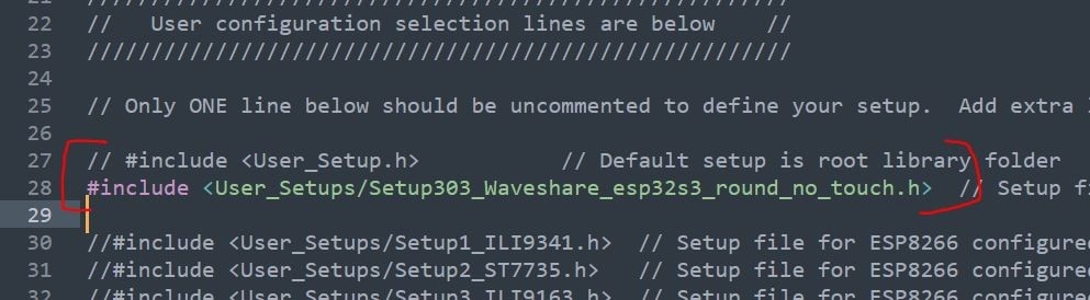

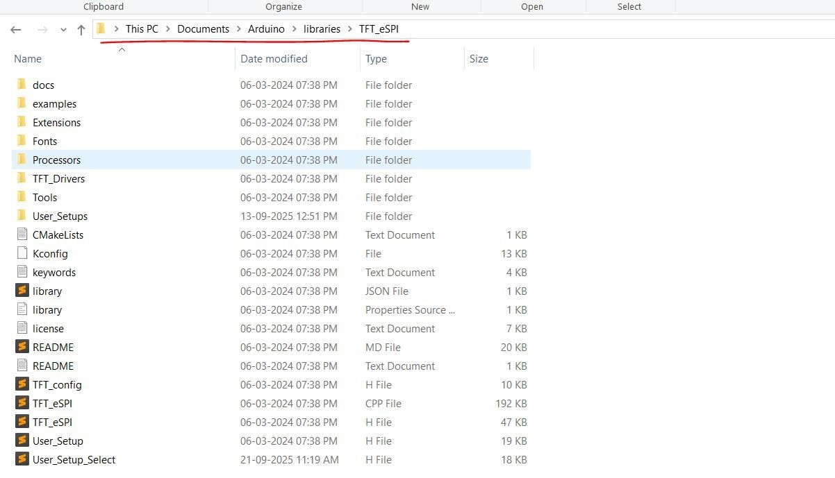

2. Setting Up the Library
- Open your computer’s Arduino Libraries folder (usually located in Documents > Arduino > Libraries).
 - Find the folder named TFT_eSPI and open it.
 - Download the User Setup file from my GitHub repository.
 - Copy and paste this file into the User_Setups folder inside TFT_eSPI.
 - Now, open the file User_Setup_Select.h (you can use Notepad or any text editor).
 - Look for the line and comment it out by adding // at the beginning.
#include <User_Setup.h>
- Add the following line instead:
#include <User_Setups/Setup303_Waveshare_esp32s3_round_no_touch.h>
That’s it! Now the library will use our custom setup file for pin configuration, and your display will work correctly with the SoulCage project.

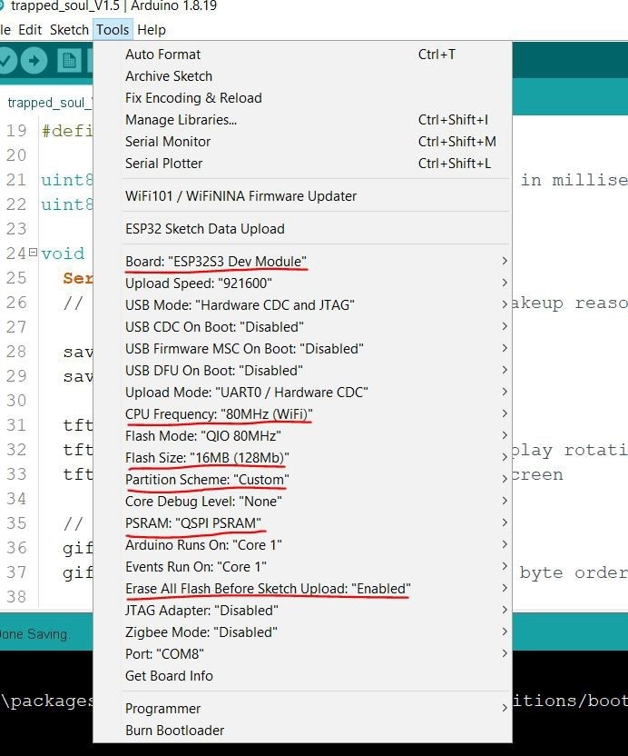

Now that the library is configured, we will program the device. This step verifies that all of our previous setup is correct and that the SoulCage display works as expected. Follow the instructions below carefully:
- Make sure your ESP32 Board Package in Arduino IDE is installed and updated to version 3.3.0.
 - Download the SoulCage code from my GitHub and open the project in Arduino IDE.
 - Go to the Tools menu and set the following options:
 - Board: ESP32S3 Dev Module
 - CPU Frequency: 80 MHz
 - Flash Size: 16 MB
 - Partition Scheme: Custom
 - PSRAM: QSPI PSRAM
 - Erase All Flash Before Sketch Upload: Enable
 - Connect the device to your computer using a Type-C USB cable.
 - Select the correct COM port for the device in Arduino IDE.
 - Click the Upload button to program the ESP32-S3.
 - If everything is correct, the code will compile and upload successfully. After a few seconds, check the round display: the trapped soul animation should appear, confirming that your configuration and code are working.

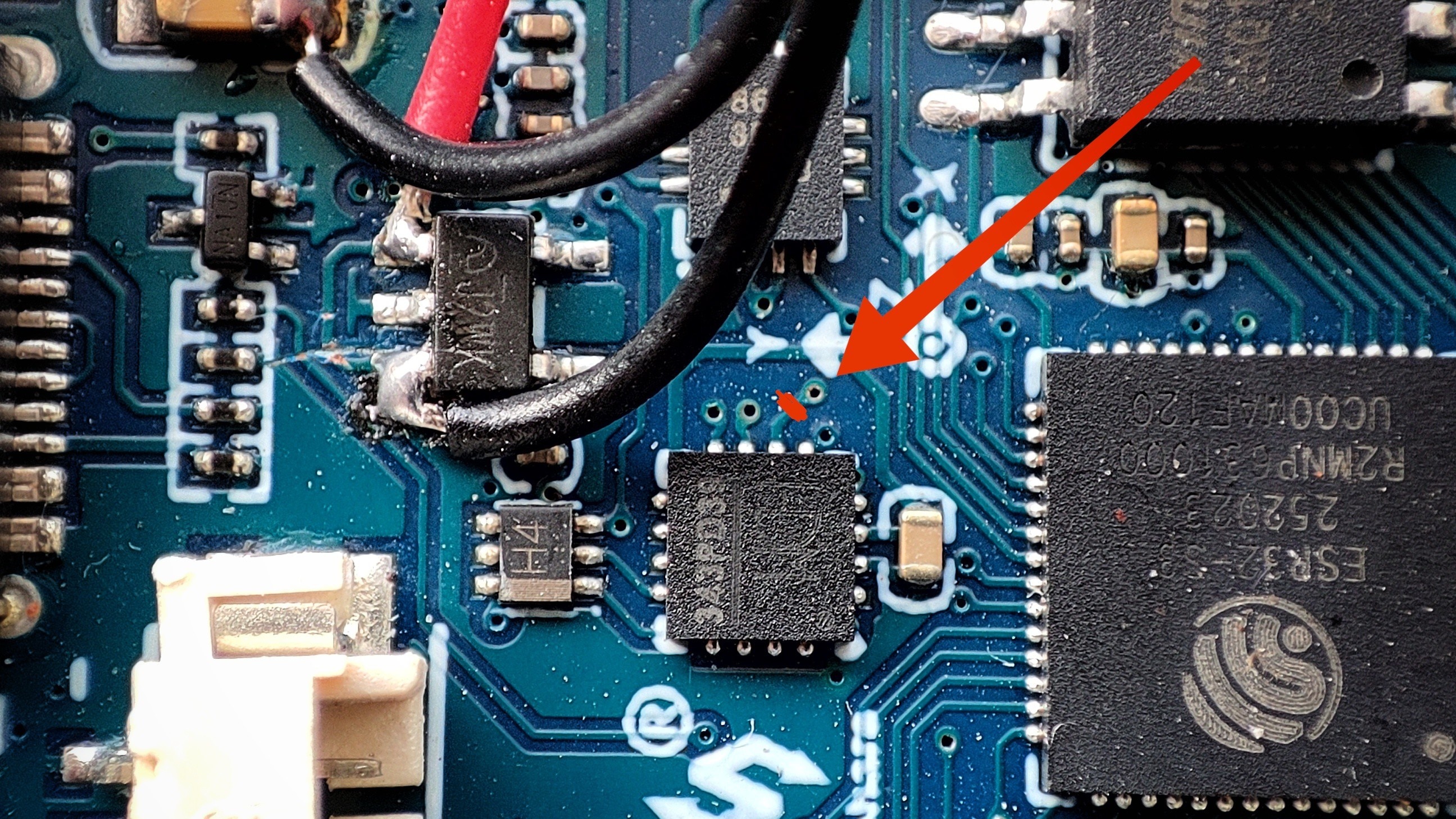

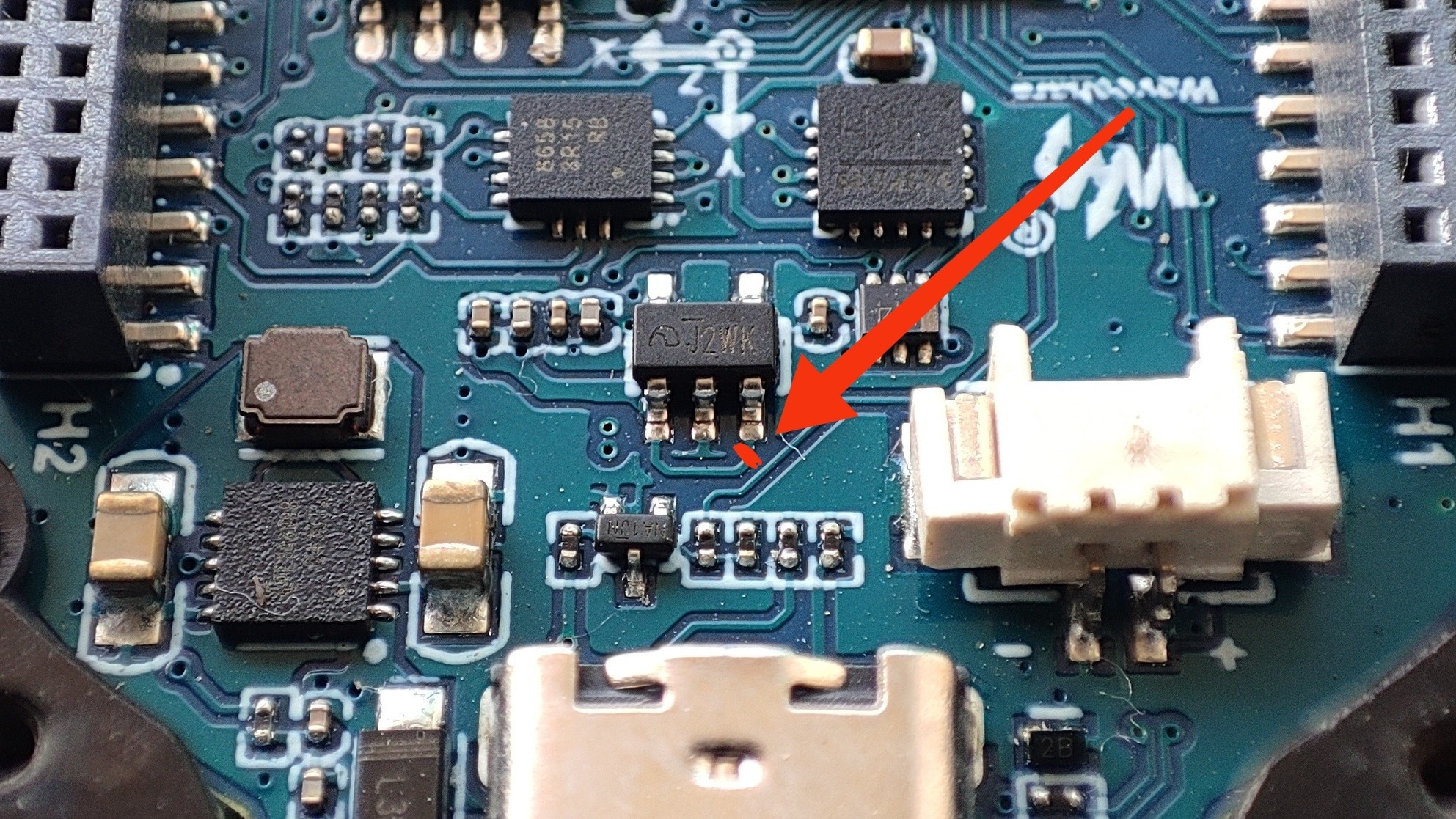

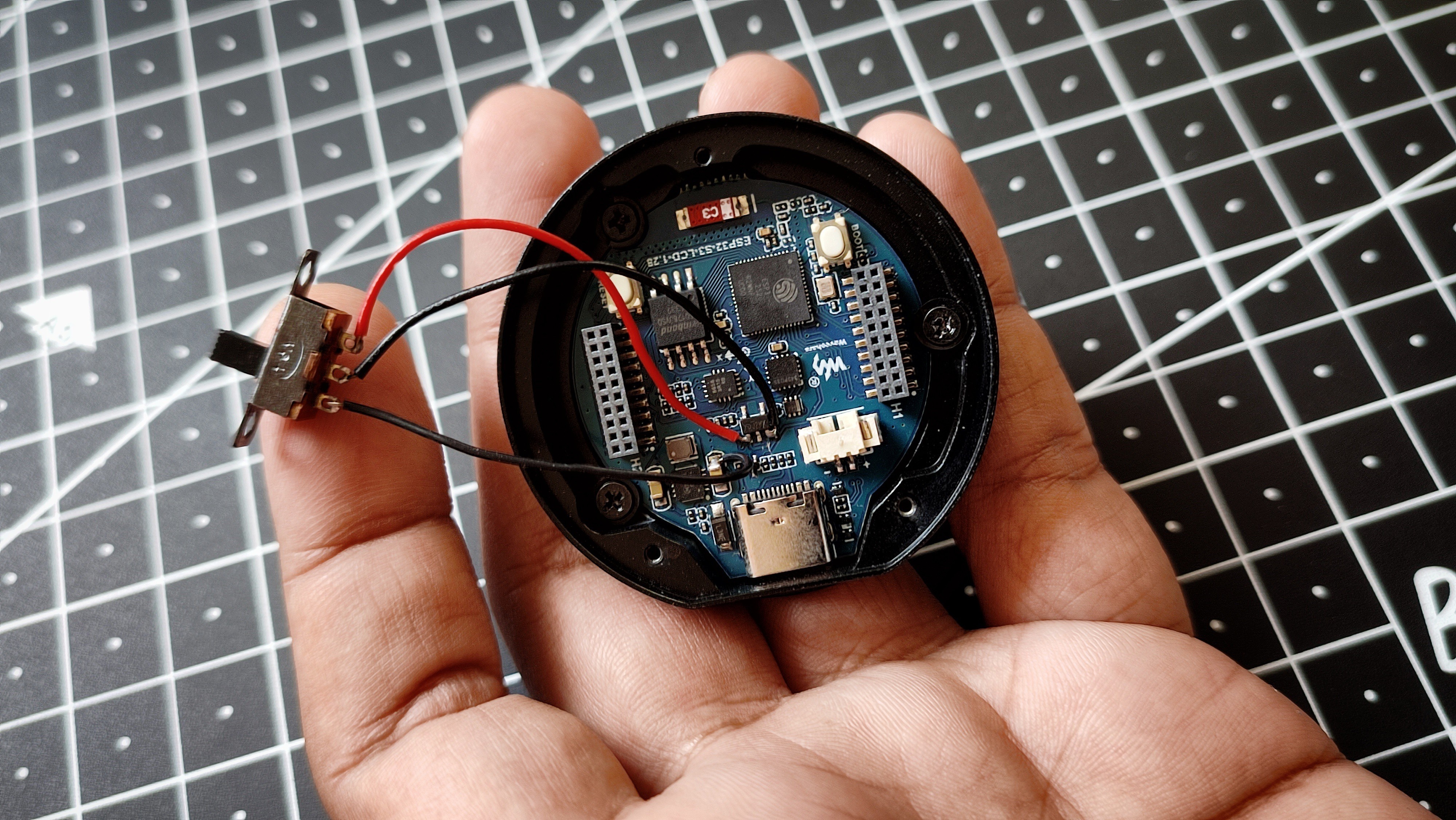

Making Small Modifications to the PCB

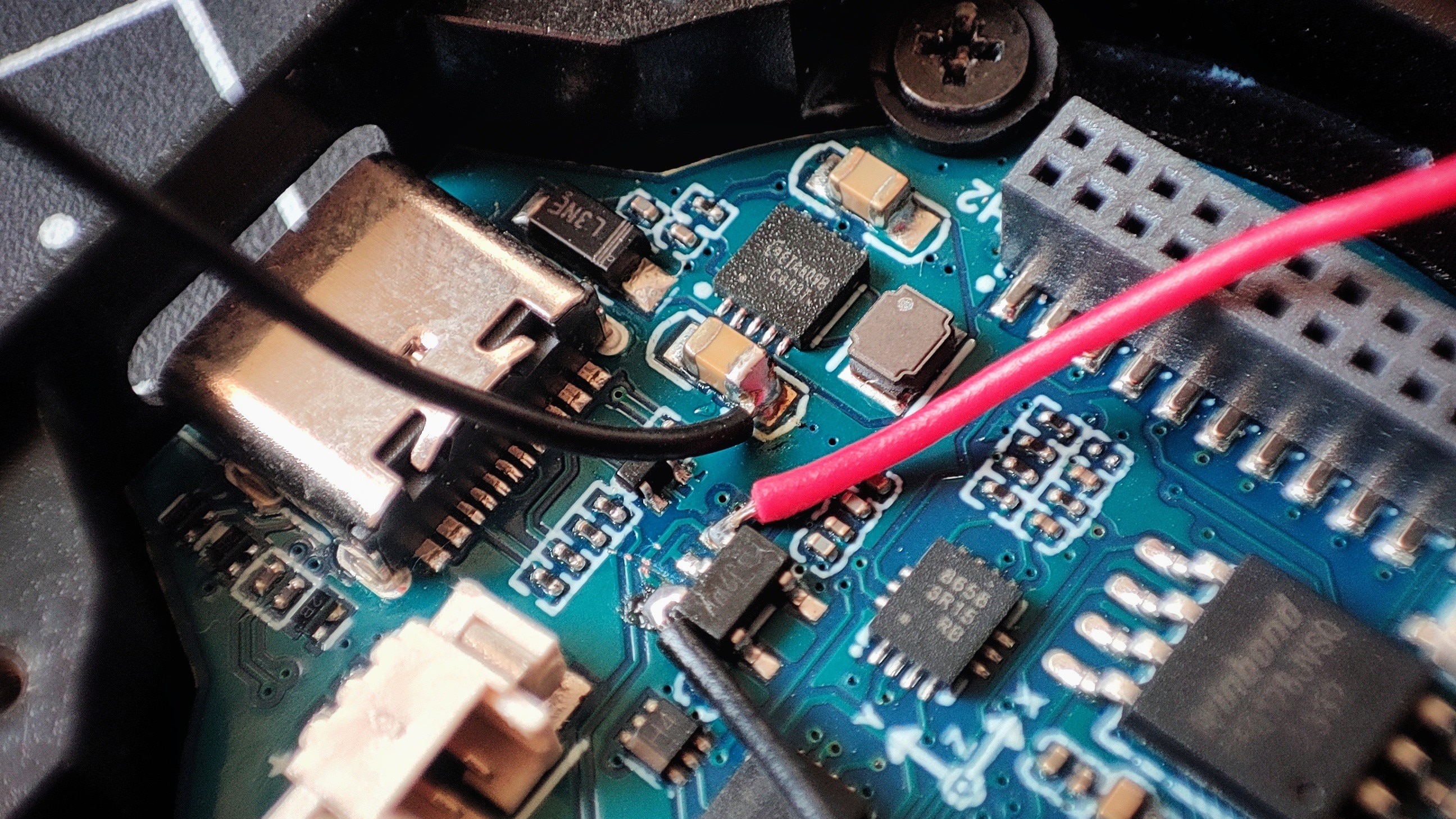

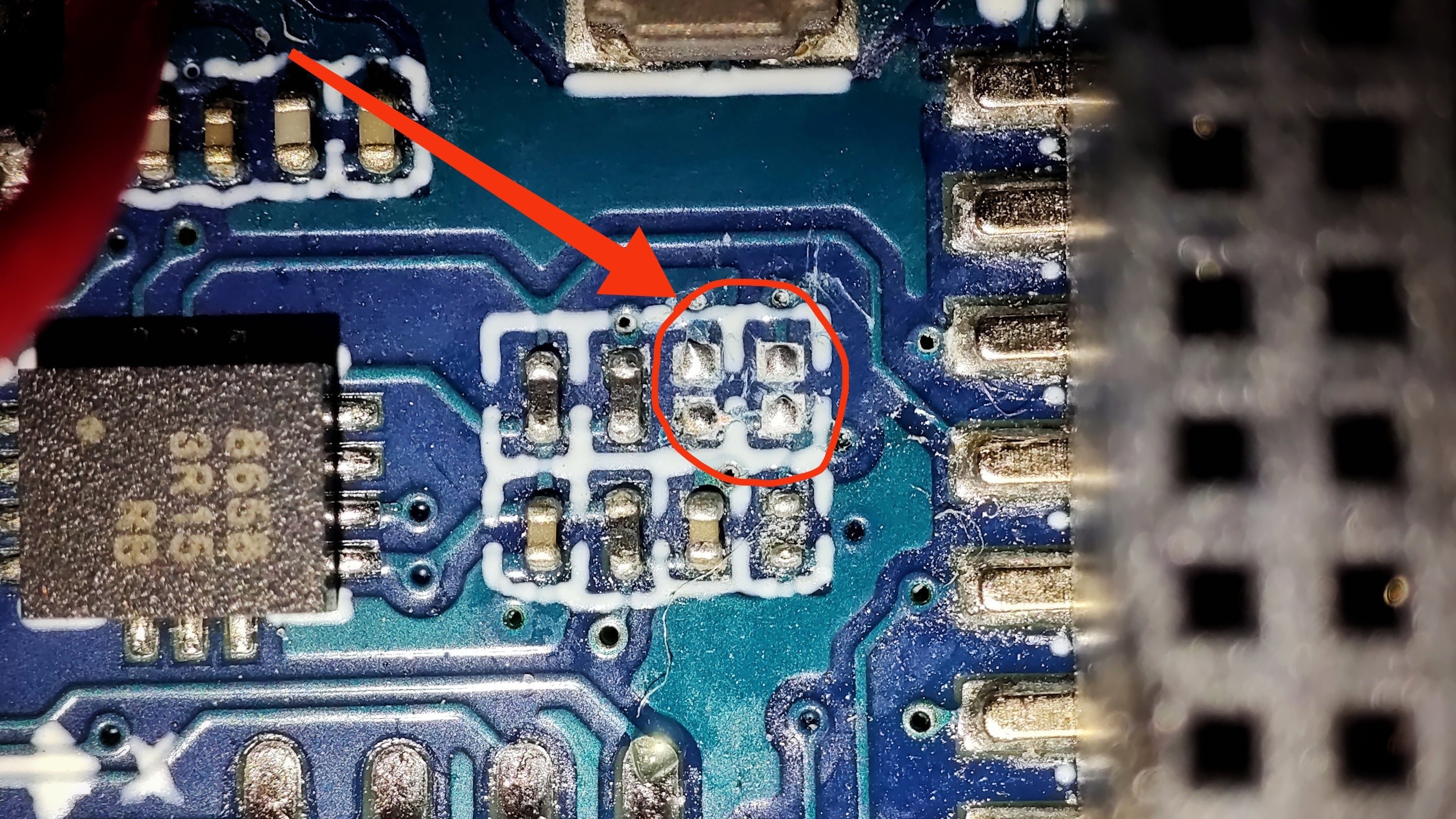

At first, I thought putting the ESP32 into deep sleep mode would be enough to reduce current consumption down to about 10 µA. However, the PCB has several other components that continue drawing current even when the ESP32 is asleep, so the power usage never dropped as expected.
To solve this, I decided to add a switch that disconnects the main power supply of the PCB while still allowing the charging circuit to work. For this, I made a small cut on the EN pin of the ME6217C33M5G LDO regulator and wired it through the switch.
But this still did not fully solve the problem. When a USB cable was connected, the CH343P USB-to-serial chip continued converting 5V to 3.3V and supplying it to the same rail. This caused the display to flicker when the device was turned off but charging. To fix this, I also had to cut the V3 trace (pin 6) of the CH343P.
During testing, I found another source of unnecessary current draw. The voltage divider used to detect battery level was constantly consuming around 20 µA, even when the device was not in use. I simply removed resistors R4 and R7 (as shown in the image). After doing this modification, the standby current dropped significantly, down to about 1.5 µA.
- Locate the first spot (EN trace of the ME6217C33M5G LDO regulator) as shown in the image.
 - Locate the second spot (V3 trace of pin 6 on the CH343P) as shown in the image.
 - Take a sharp, pointed cutter.
 - Carefully cut the traces at both spots, making sure not to damage nearby tracks.
 - Use a soldering iron to carefully remove R4 and R7, as shown in the image.
Once these two cuts are made, the switch can completely disconnect power from the PCB without affecting charging, and the display will no longer flicker when the USB cable is plugged in.

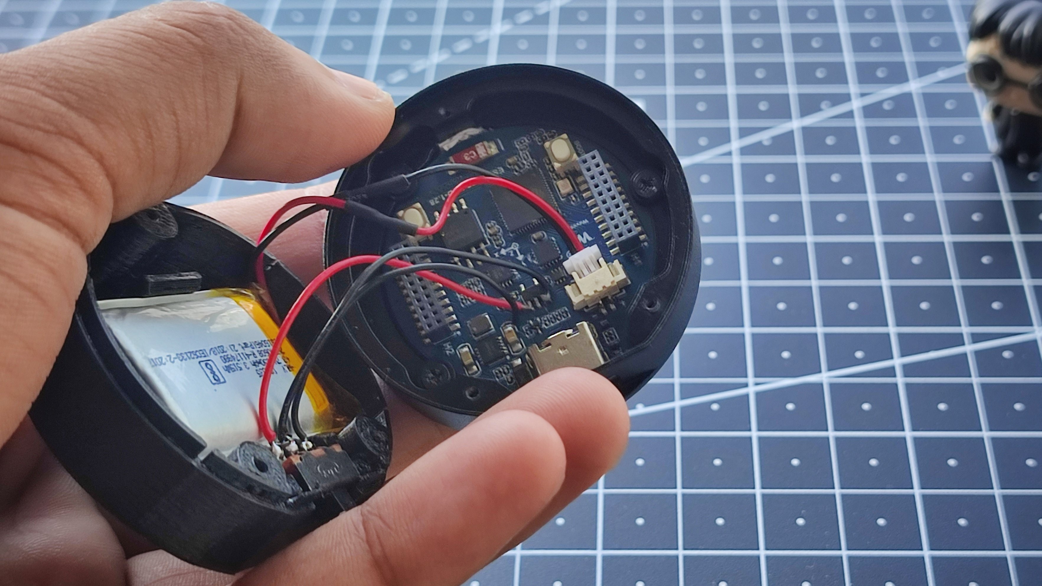

Soldering the Mini SPDT Switch & Battery Connector
In this step, we will solder two important components: the mini SPDT switch and the battery connector. Follow the instructions carefully.
Soldering The Mini SPDT Switch
- Cut three small pieces of wire.
 - Strip the edges of each wire and tin them using a soldering iron.
 - Solder the first wire to pin 1 of the ME6217C33M5G.
 - Solder the second wire to pin 3 of the ME6217C33M5G.
 - Solder the third wire to the GND pad of the C3 capacitor (see reference image).
 - Now connect these wires to the switch:
 - Solder the wire from pin 3 of the LDO to the middle pin of the SPDT switch.
 - Solder the other two wires to the remaining pins of the switch. The order does not matter—one side will turn the device ON, the other side OFF.
Soldering The Battery Connector

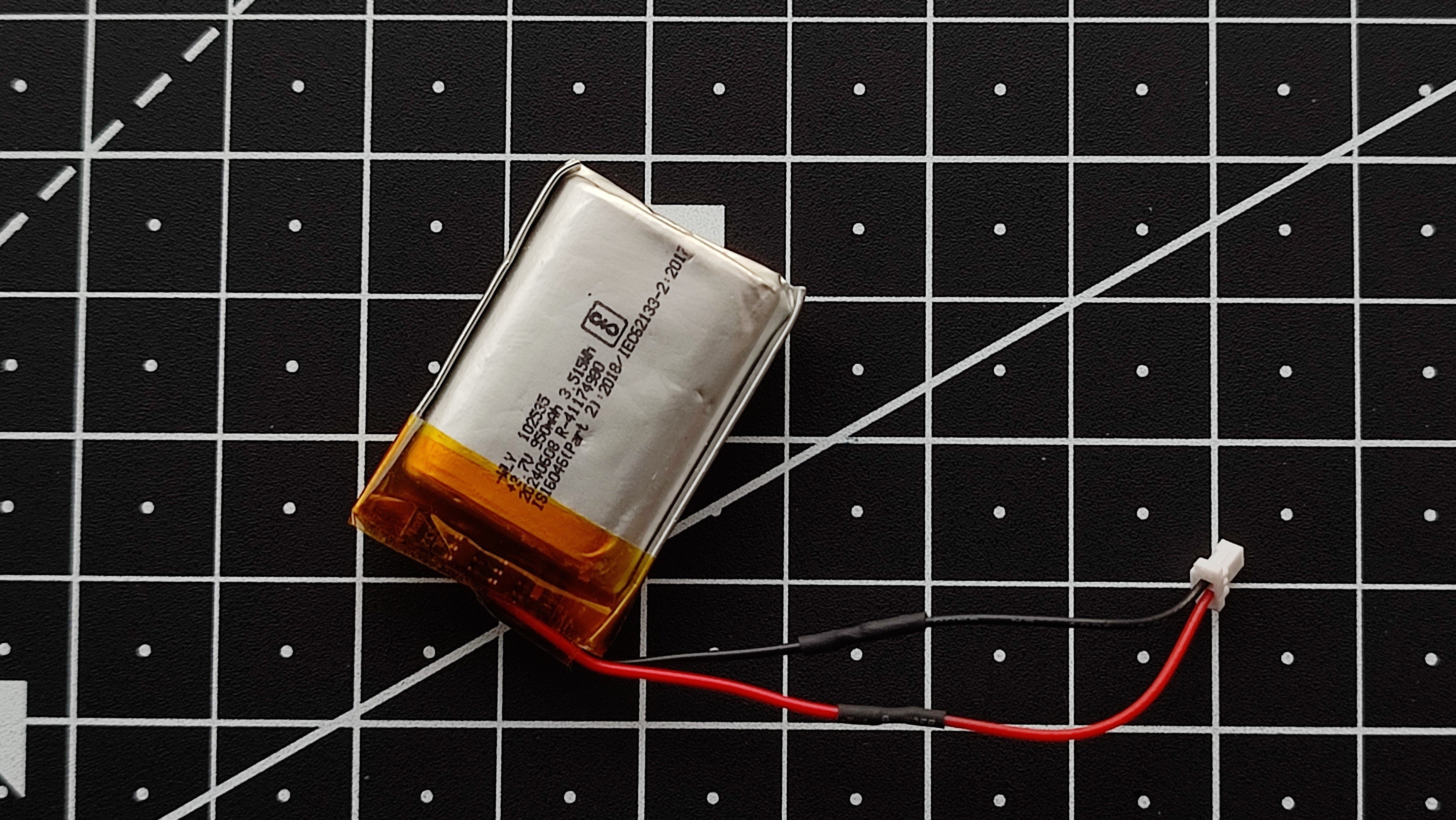

- Carefully strip the ends of the connector wires and the battery wires.
 - Slide a piece of heat shrink tube onto each battery wire.
 - Solder the red wire of the connector to the red wire of the battery, and the black wire of the connector to the black wire of the battery.
 - Move the heat shrink tube over the solder joints.
 - Apply hot air (or briefly touch the side of the soldering iron) to shrink the tubing and secure the joints.

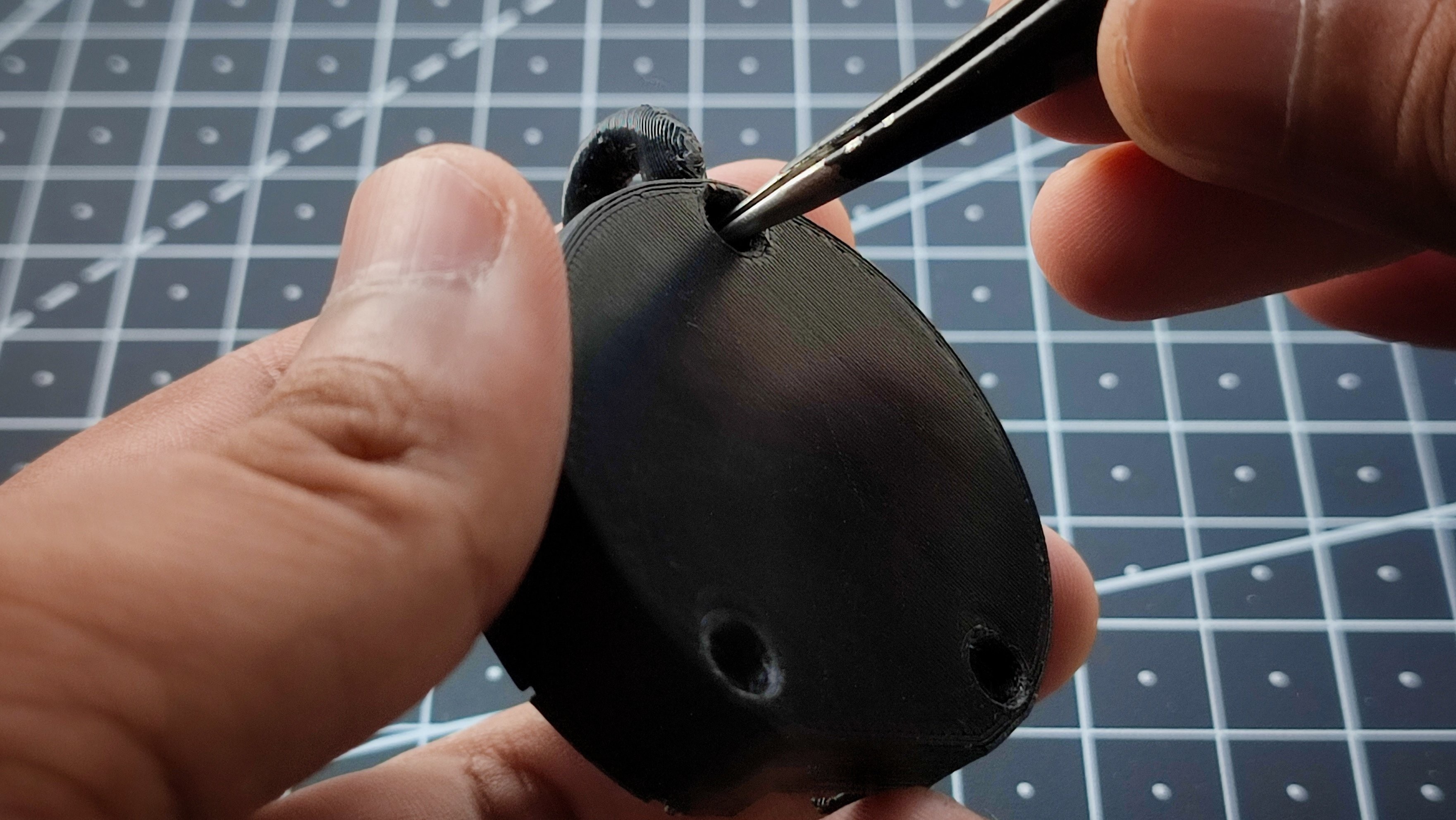

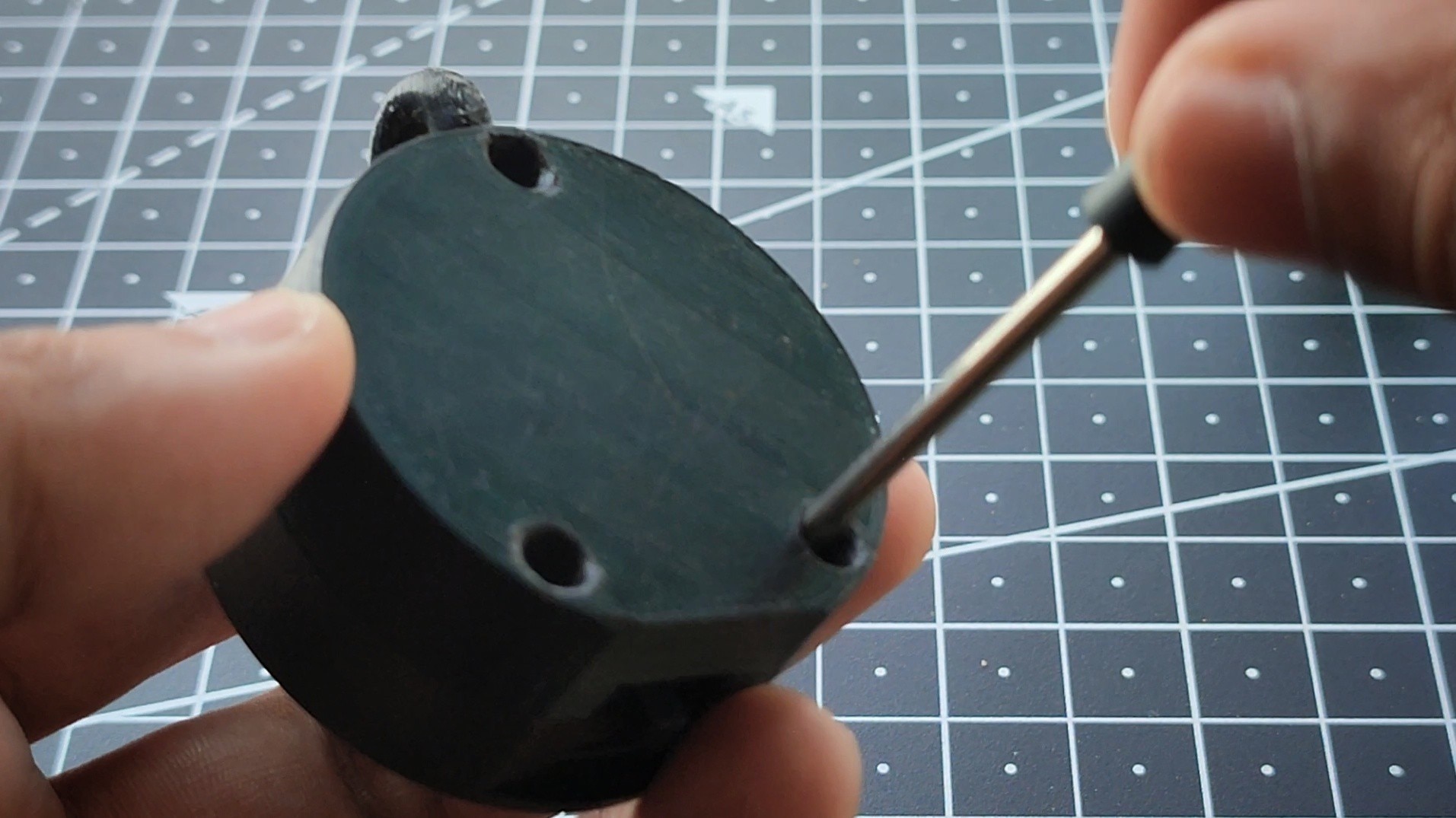

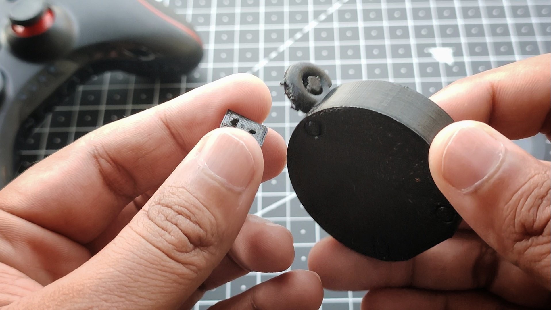

Cleaning the 3D Print for Assembly
The 3D-printed back cover includes some support structures to ensure accurate printing. Before assembly, these supports need to be removed and the part cleaned.
- Remove the support material from the bottom of the pendant hanging hook.
 - Remove the supports from the screw holes.
 - Use a small screwdriver or tweezers to clean the screw holes thoroughly.
 - Test the holes by inserting the screws, make sure they pass through smoothly, as shown in the reference image. This confirms that the holes are properly cleaned.

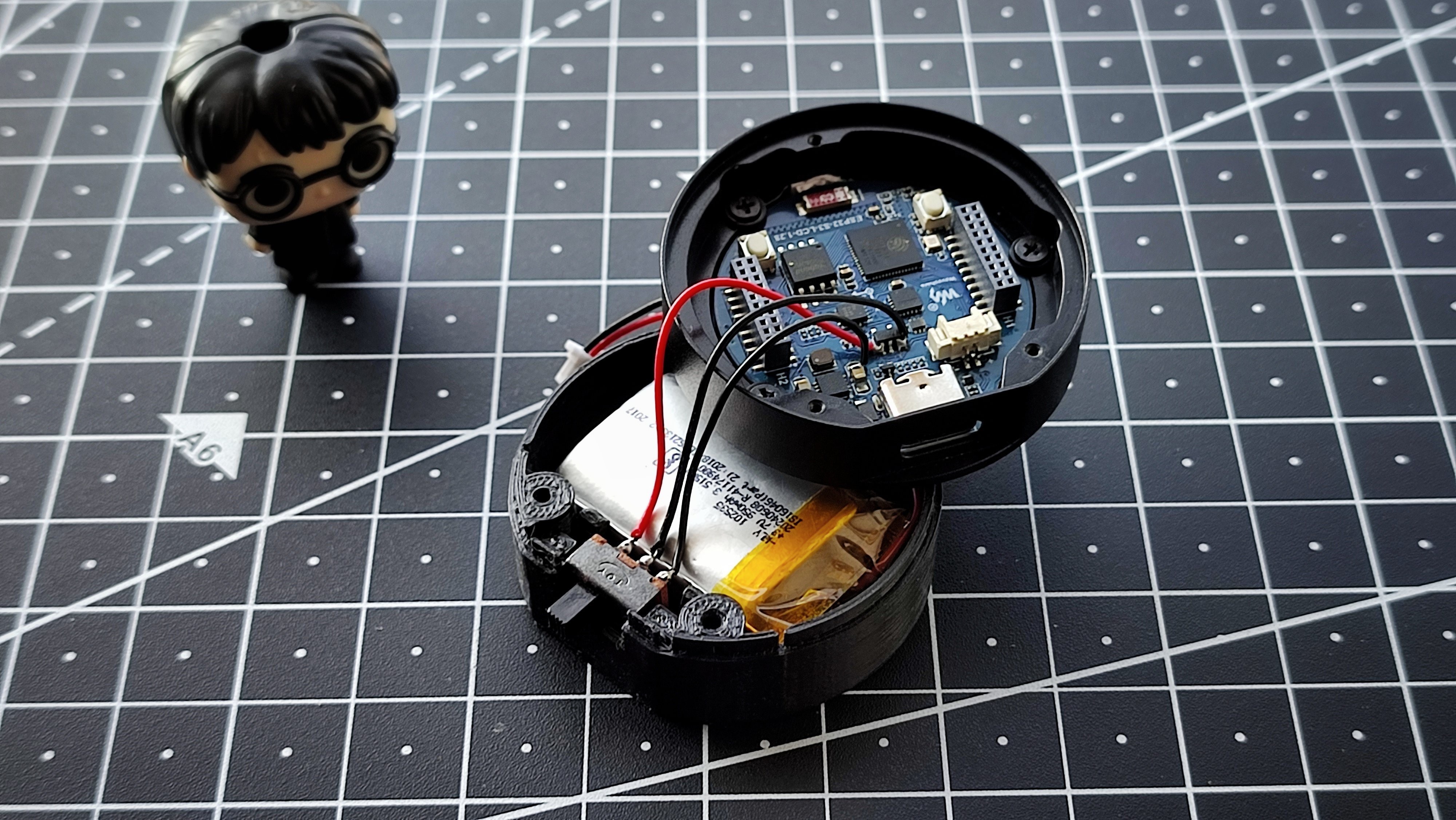

Final Assembly
Now it’s time to assemble all the components so the SoulCage pendant is ready to use. Follow these steps carefully:

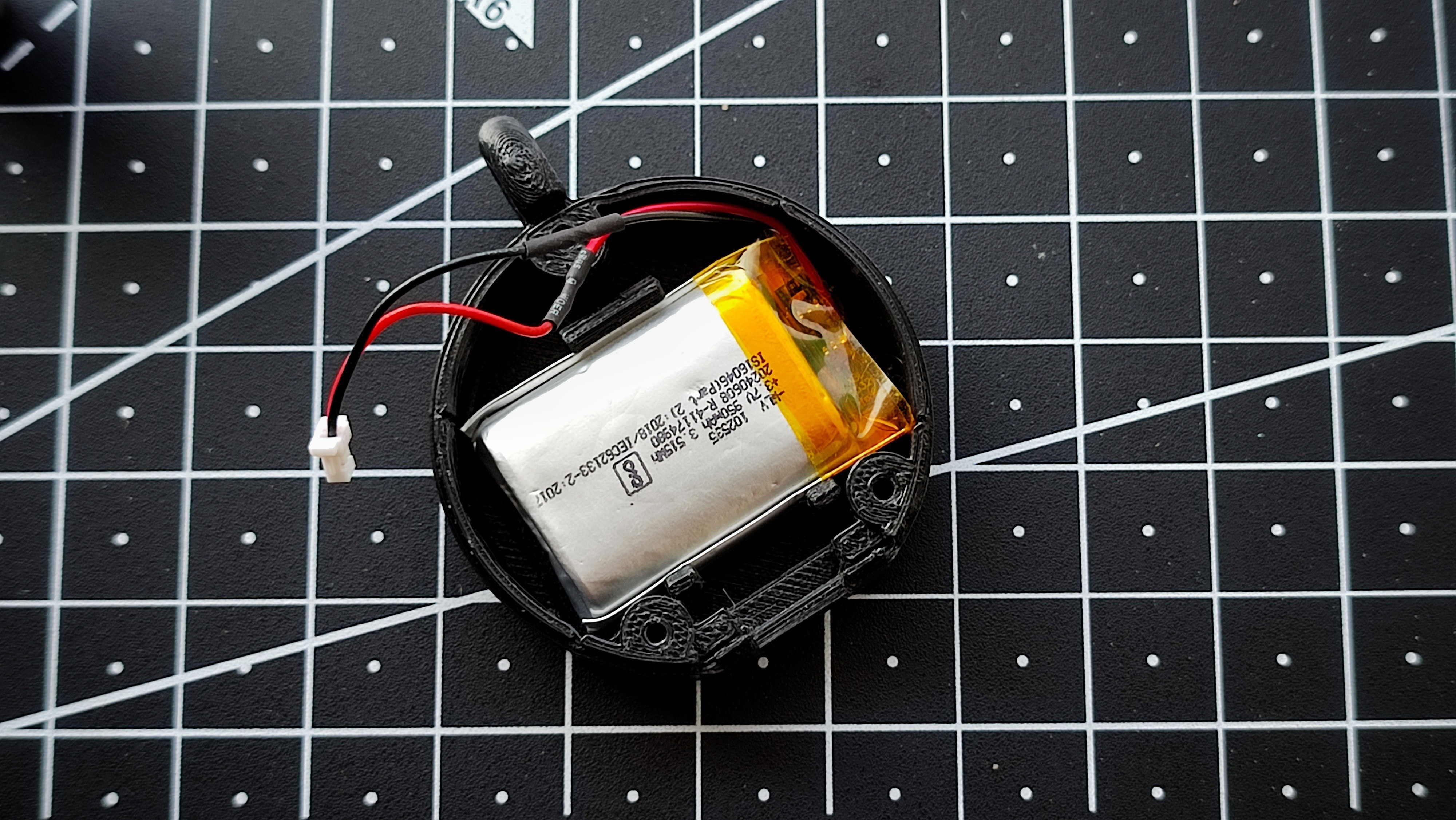

- Snap-fit the battery securely inside the 3D-printed back cover. No screws or glue are needed.
 - Slide the mini SPDT switch into its slot at the bottom of the back cover. Make sure it sits firmly in place.
 - Attach the battery connector to the PCB, ensuring correct polarity.
 - Align the back cover with the CNC metal case. Use a magnetic screwdriver to insert the screws. Check that the screws come out correctly on the other side and fit smoothly.
 - Tighten the screws one by one carefully, making sure the cover is snug but not over-tightened to avoid cracking the 3D print.

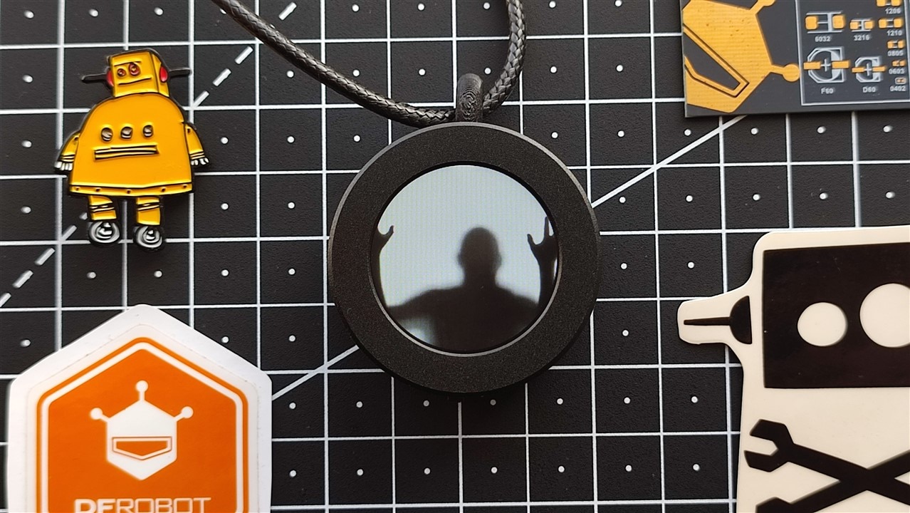

Once this is done, the device is fully assembled. we will do the final testing in the next step to confirm that everything is working correctly.

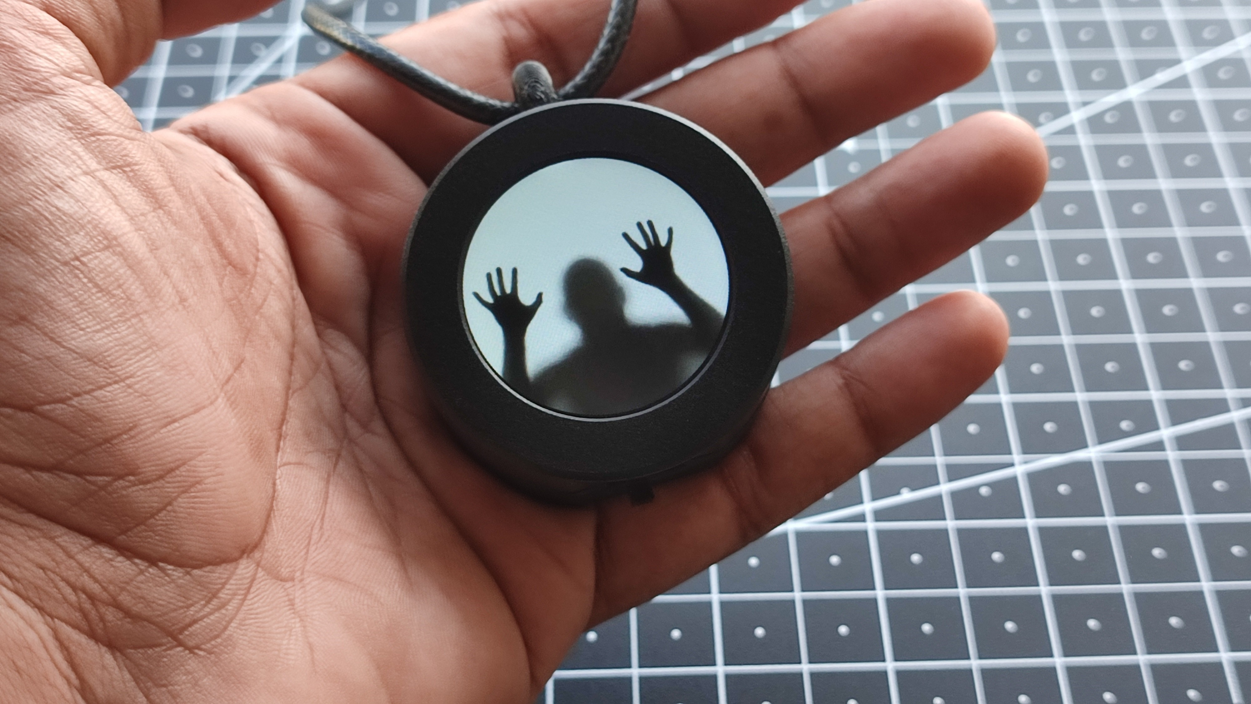

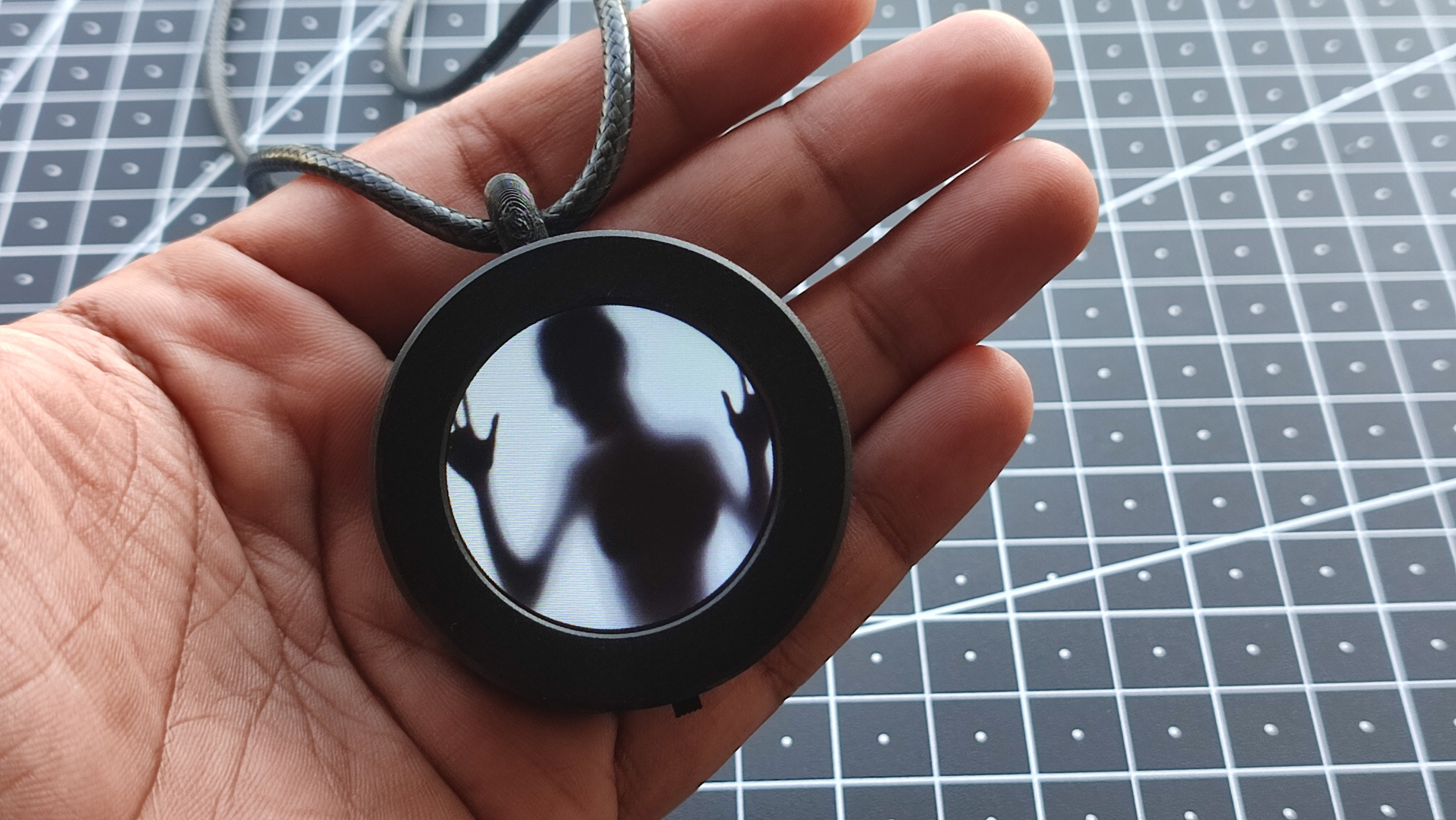

Using the Device
After completing all the previous steps, your SoulCage pendant is ready to use. Here’s how the device works and how to control it:
- Power On/Off: Use the mini SPDT slide switch to turn the device on or off.
 - Changing the Soul:
 - When the device is turned on, the current soul is displayed.
 - To switch to the other soul, turn off the device and turn it on again within 10 seconds.
 - The selected soul will be saved, so the device will remember it every time it powers on.

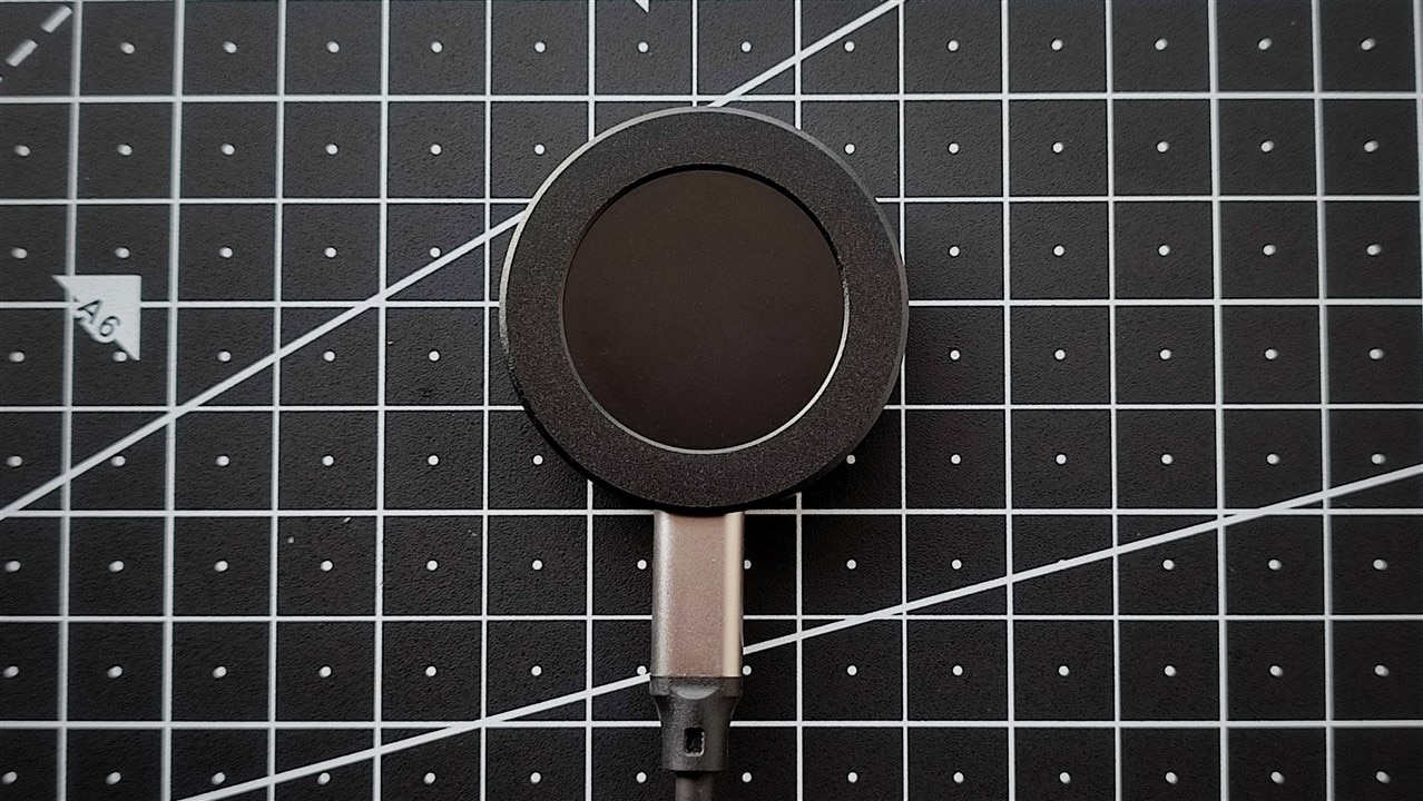

 - Charging: The pendant can be charged using the Type-C connector located at the bottom. Simply plug in a USB charger to recharge the battery.
With these simple controls, you can enjoy the trapped souls animation and switch between the male and female souls whenever you like.

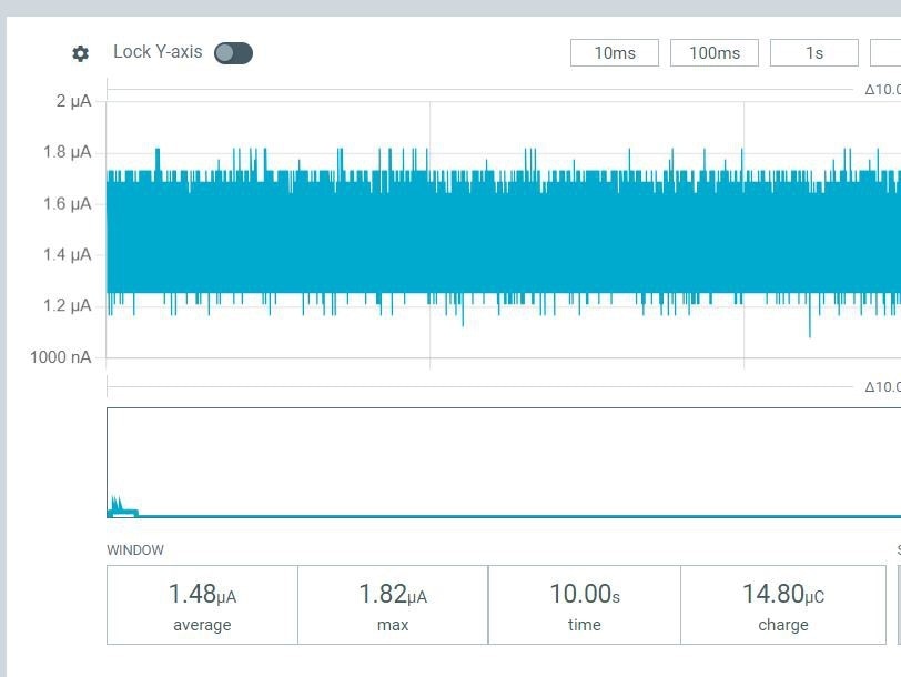

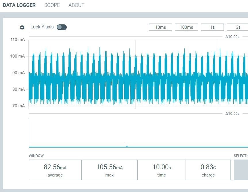

Current Test & Battery Life Prediction
To estimate how long the battery will last, I tested the device in two different states .
- Turned Off Condition:
 - When the device is powered off, it draws only about 1 µA of current.
 - At this rate, the battery life is theoretically around 108 years! Of course, this is more of an ideal number, but it shows that the device uses almost no power when off.
 - Turned On Condition:
 - While the device is running and the display is active, it draws approximately 85 mA.
 - Based on this current, the battery can last about 11 hours on a full charge.
This means that after fully charging the battery, the pendant can be used comfortably all day without worrying about recharging. The combination of low standby current and moderate active current makes it very efficient for wearable use.
