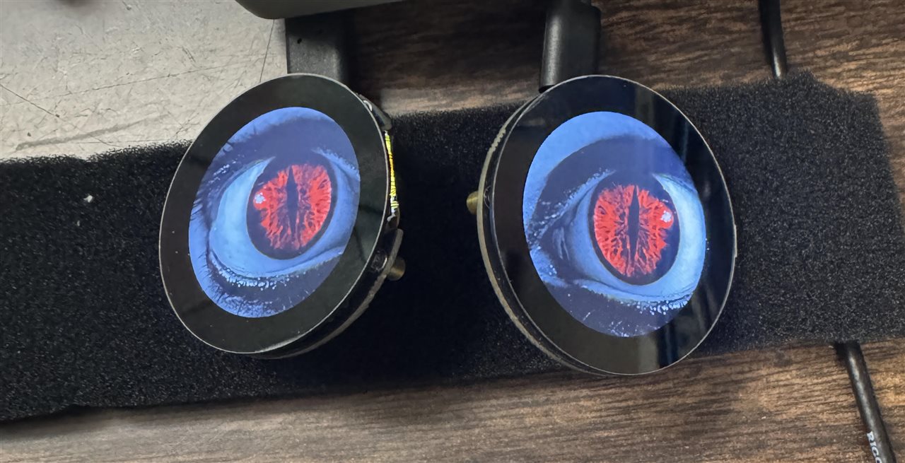

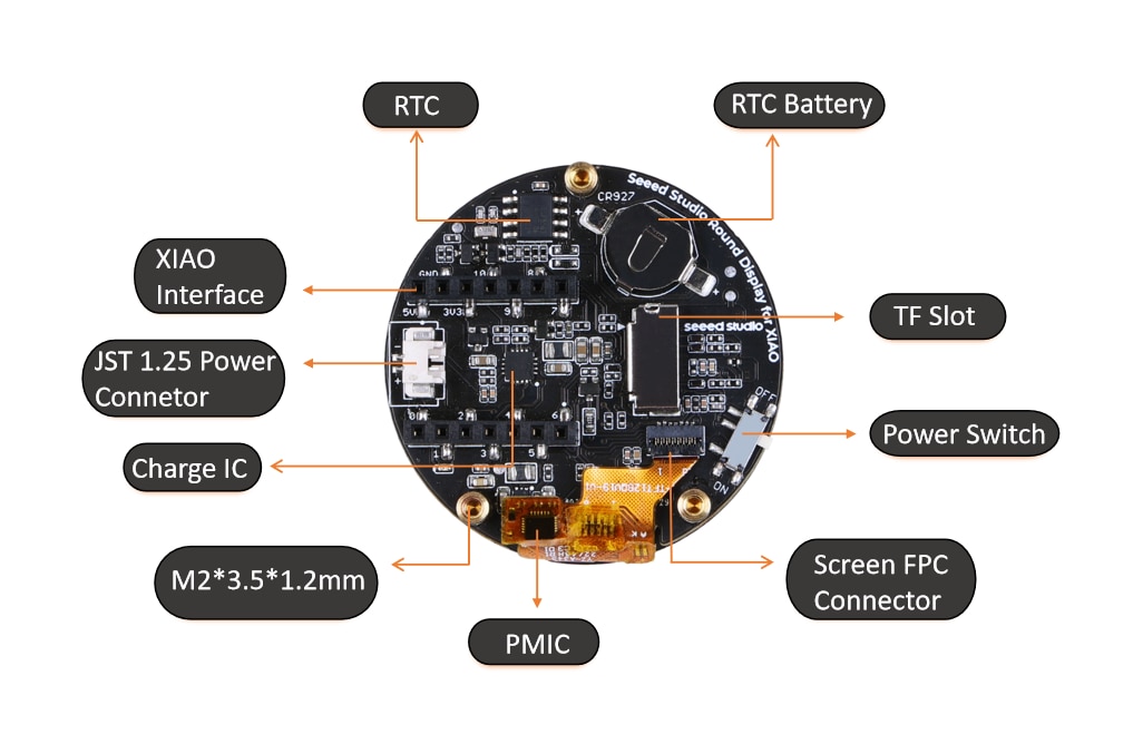

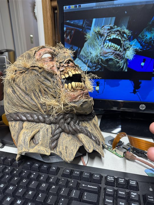

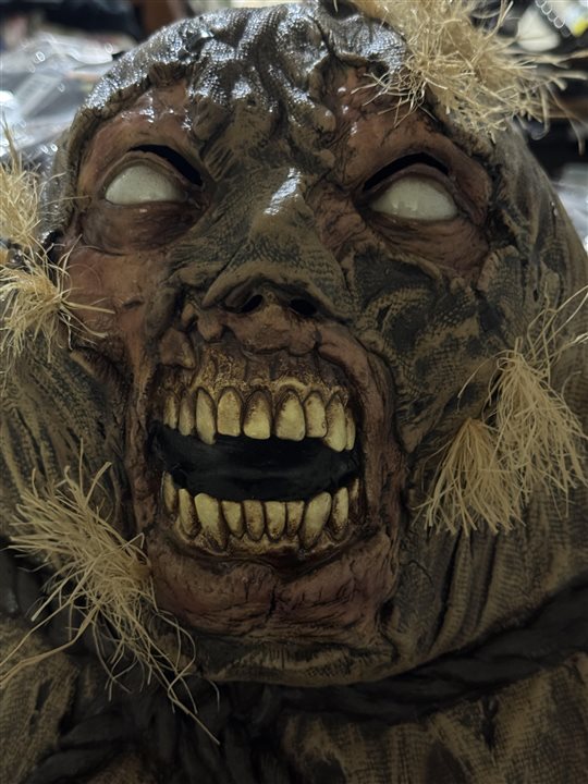

I got a new scary mask and some Seeed Studio XIAO round tft displays for eyes.

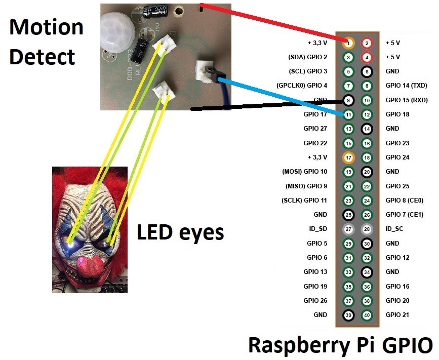

My plan was to use my old python code to sense a trick-or-treater with a proximity detector, then play a scary maniacal witch's laugh/scream with the raspberry pi and take a photo with the Rpi camera.

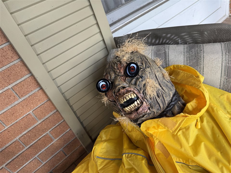

In addition, I would show some strange eyes on the tft displays for added effect.

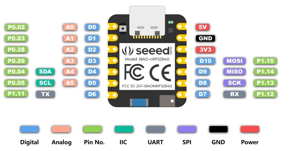

I used two Seeed Studio XIAO nRF52840 processors with the tft displays.

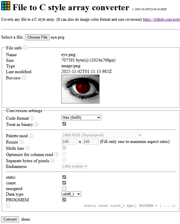

The image converter I used is:
GitHub - notisrac/FileToCArray: Coverts any file to a C style array. (It can also do image color format and size coversion)
I had to make a Left eye array file and a Right eye array file.
The XIAO program I used was a modified Arduino GUI example called TFT_flash_jpg.

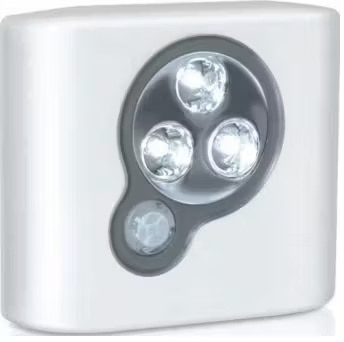

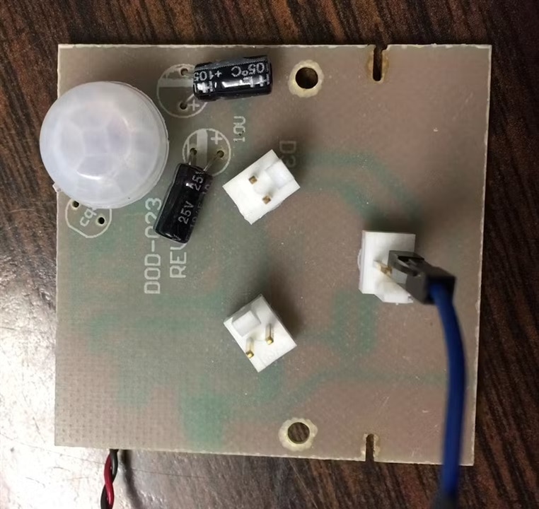

The motion sensor was part of a night light available at the local hardware store.
I powered the motion detector circuit from the 3.3V from the Rpi and used one of the LED outputs as a GPIO trigger input.
Last time I used the other LED outputs as eyes for the mask.

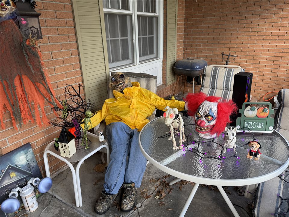

Here's the scarry witch laugh I found on the net.
We had a great Halloween!
Enjoy!
