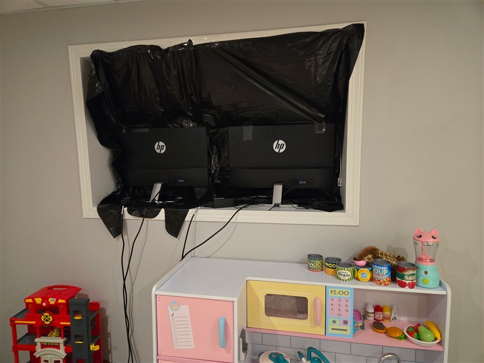

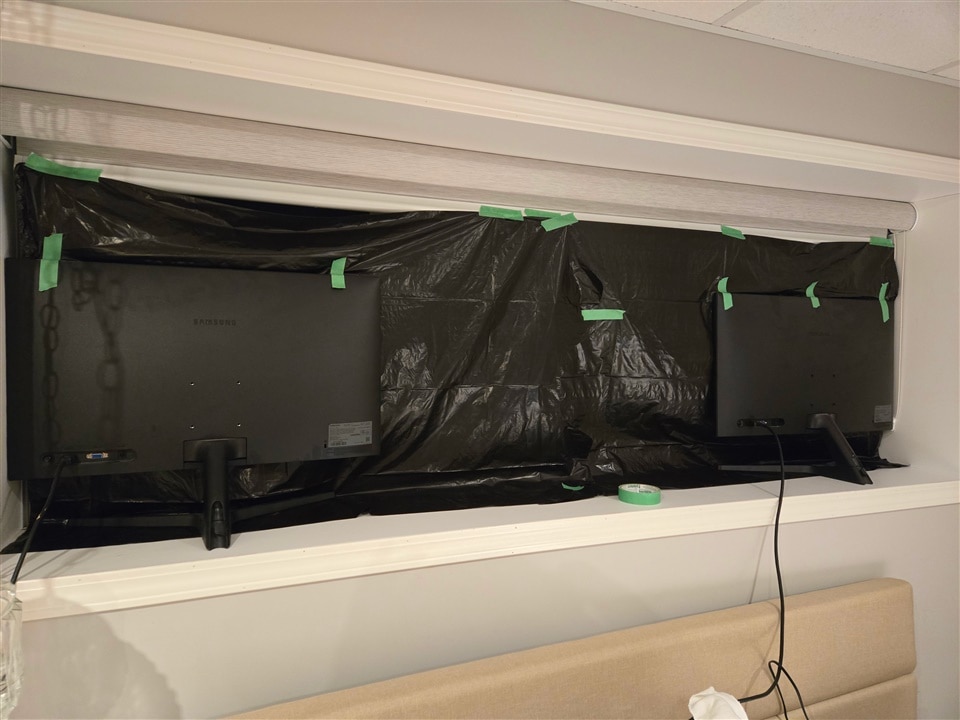

In the windows at one end of the house I used two 3B+ Pi’s one for each eye and in the windows at the other end I used one 3B+ and an HDMI splitter to generate the two outputs. I had to borrow a few monitors from work and used dark garbage bags with only eye cutouts to block out the windows.
I confess I didn’t expect this to be as difficult as it was. Knowing I had got it working before made me overconfident. In the end I told the kids that came to the door on Halloween night that I had pet dragons in the basement.
