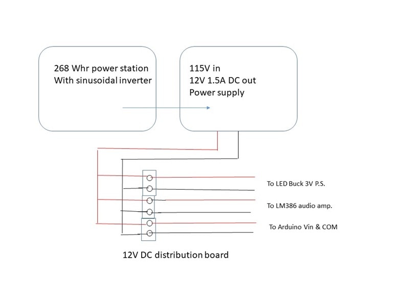

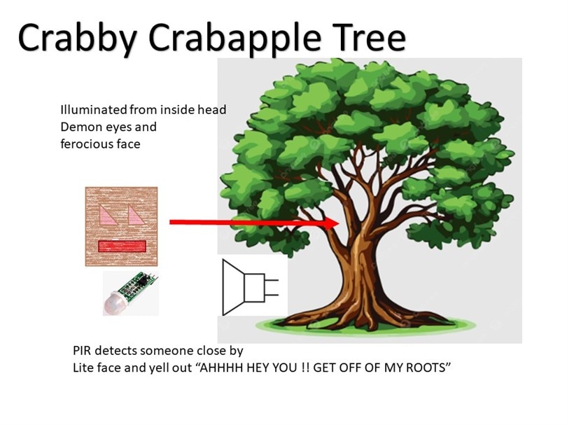

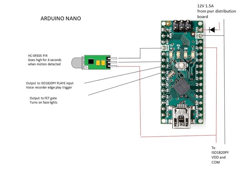

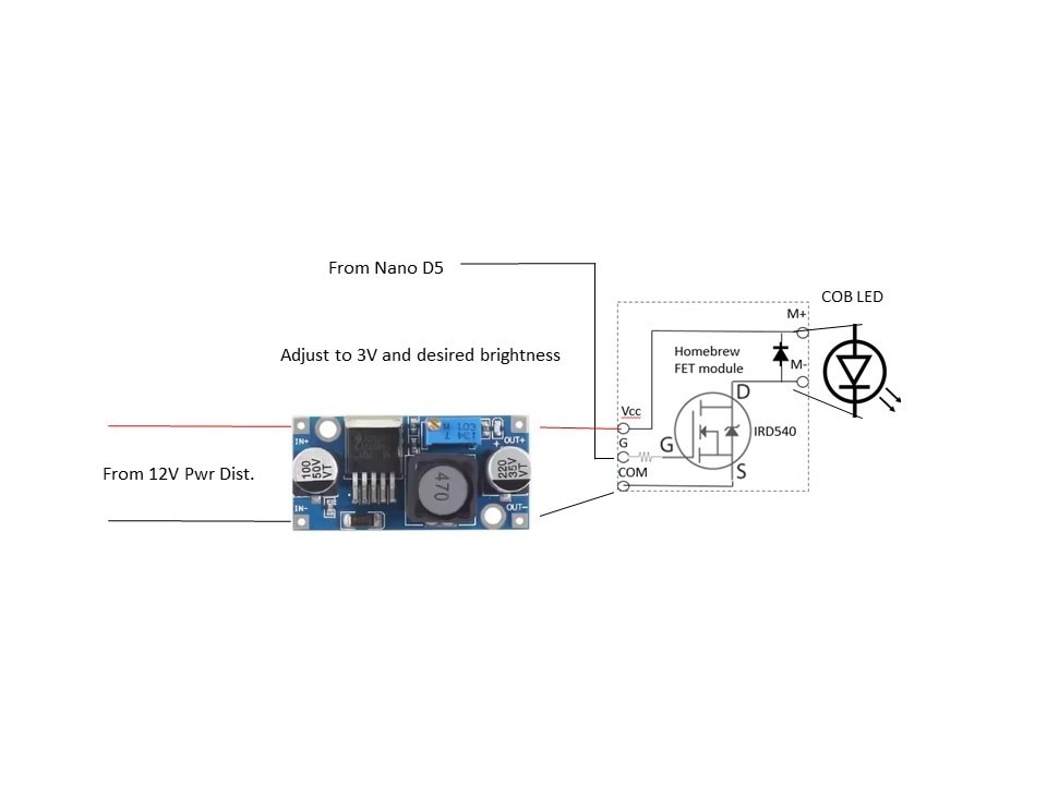

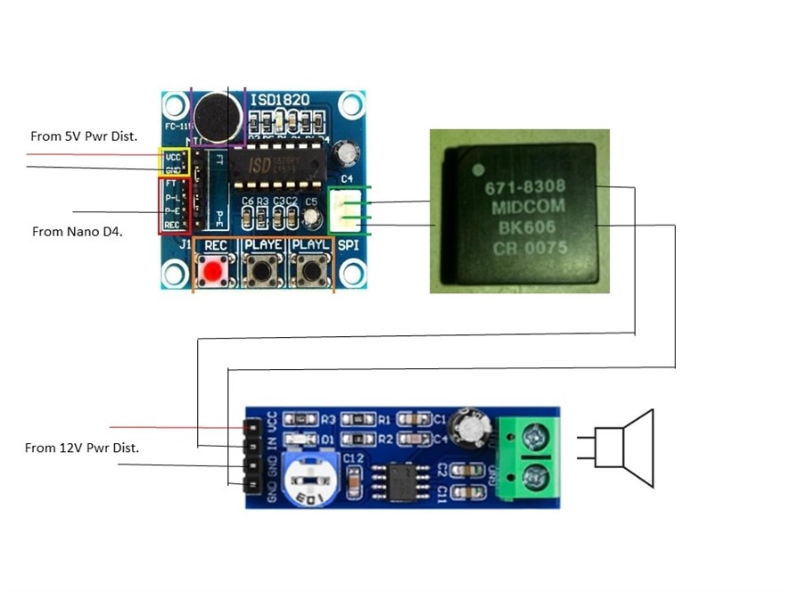

Crabby the crabapple tree wakes up if you get too close and yells at you to quit stepping on his roots. The build features Arduino Nano, PIR sensor, ISD1820 voice recorder module, LM386 audio amp.
Project
Is there nothing more scary to a trick or treater when you cross into a front yard , the trees have an attitude ?
This video says it all:
schematic and photos as shown
// OPERATION DESCRIPTION
// use PIR to trigger sequence
// on trigger, turn on LED output D4
// wait a few seconds , then edge trigger the recorded message on the ISD1820PY
// turn off LEDs after 30 seconds
int motionDetected=LOW;
int LiteLEDs=LOW;
int playMessage=LOW;
void setup()
  pinMode(3, INPUT); //PIR motion detected, HIGH for 6 seconds
  pinMode(4, OUTPUT); //to MOV gate to turn on lite LEDS
  pinMode(5, OUTPUT); //to playE ISD1820PY
  Serial.begin(9600); // serial monitor for troubleshooting
 // delay(15000); // wait 15 seconds for PIR to initialze
void loop() {
delay (3000); // only read every 5 seconds
motionDetected=digitalRead(3); // high means PIR is triggered
//Serial.print("motion detected =");
//Serial.println(motionDetected);
//Serial.print("DFplayer Busy =");
//Serial.println(DFplayerBusy);
if (motionDetected==HIGH)
    digitalWrite(4,HIGH);
    delay(1000);
    digitalWrite(5,HIGH);
    delay(1000);
  else
    digitalWrite(4,LOW);
    delay(200);
    digitalWrite(5,LOW);
    delay(200);
}  //bracket for void loop
