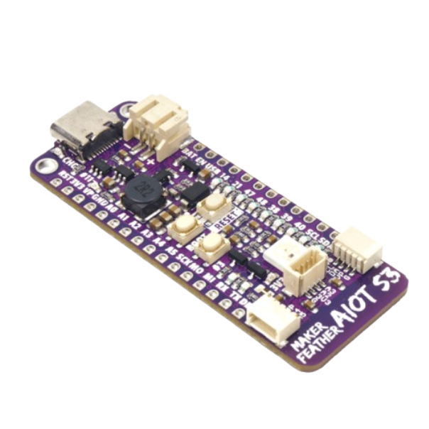

ESP32-S3 Maker Feather AIoT S3
Main controller board

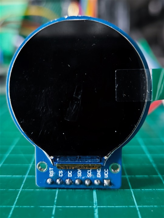

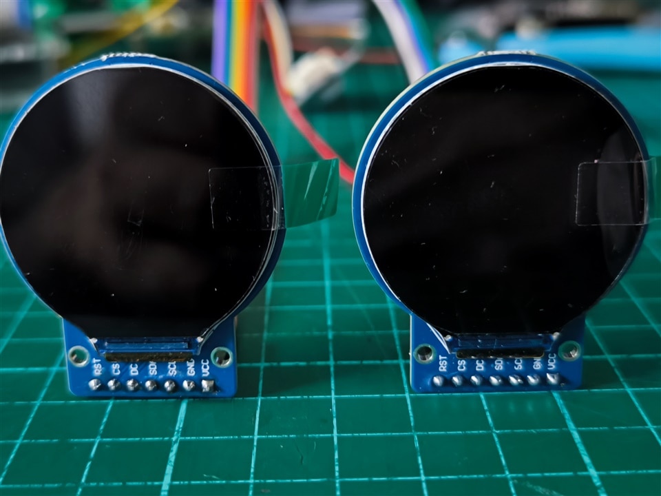

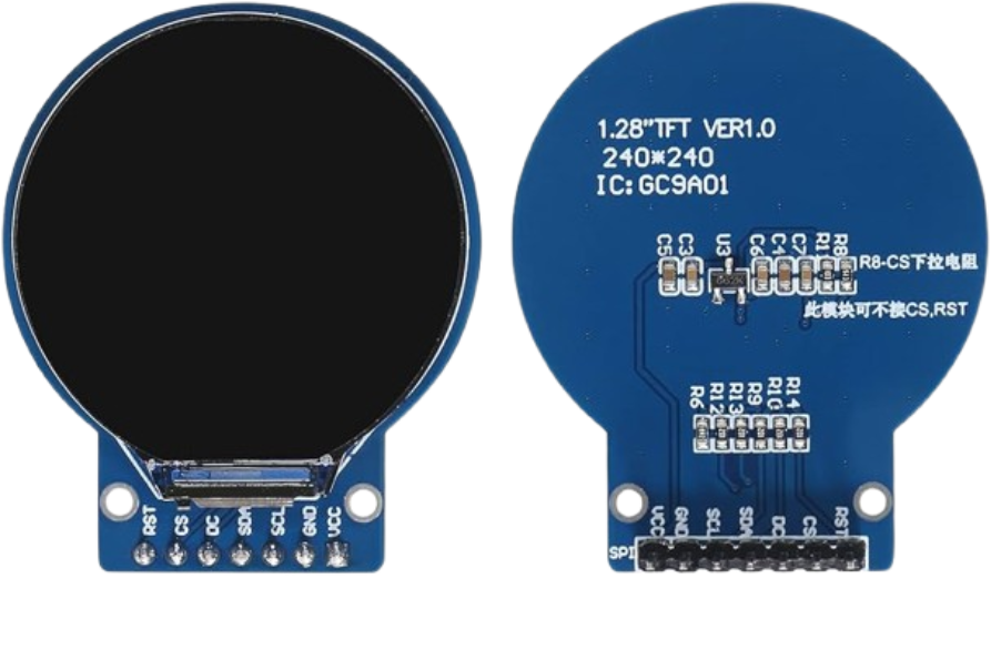

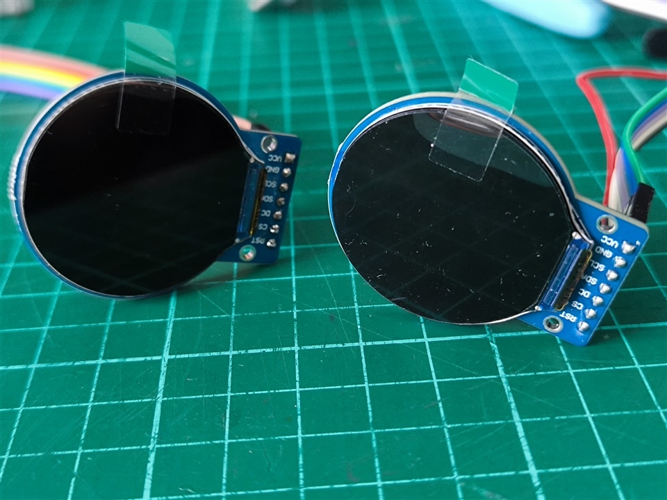

2 × GC9A01A 240×240 Round TFT Displays
Displays for the eyes

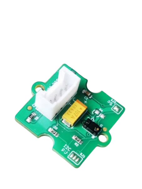

APDS9960 Gesture & Proximity Sensor
Detects hand movement

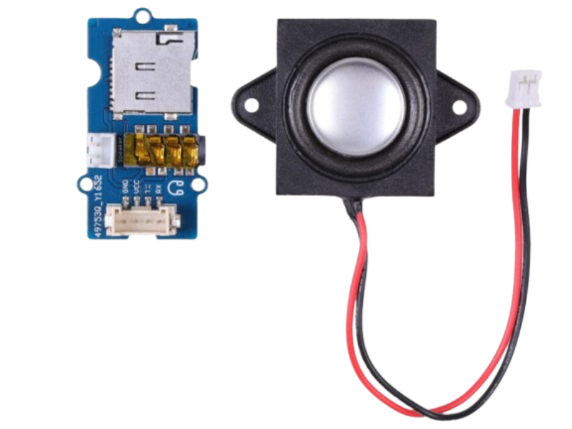

WT2605C Serial MP3 Player
Plays sound effects
Micro SD Card Stores MP3 audio files

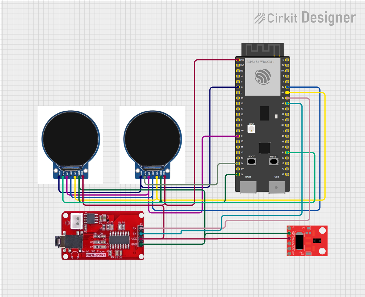

Electric plug Circuit Connections
Module Pin ESP32-S3 Pin
Left Eye (TFT) CS 14
Right Eye (TFT) CS 21
Both Eyes DC 9
Both Eyes RST 6
Gesture Sensor (APDS9960) SDA 42
Gesture Sensor (APDS9960) SCL 41
MP3 Player RX 40
MP3 Player TX 39
All modules share common GND and 3.3V lines.
Frame photo️ Wiring Diagram

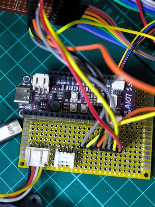

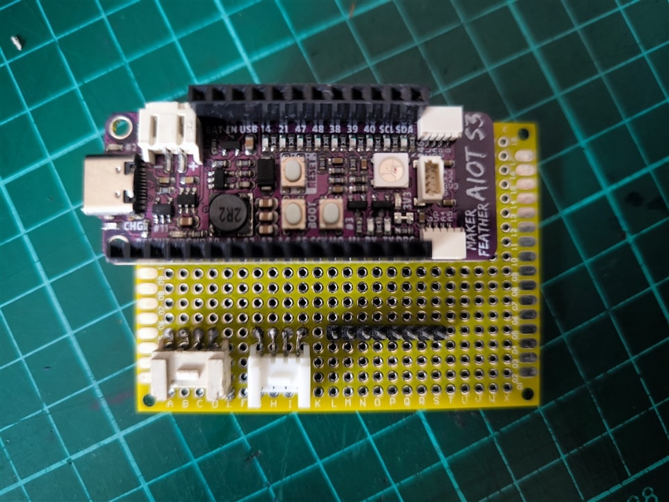

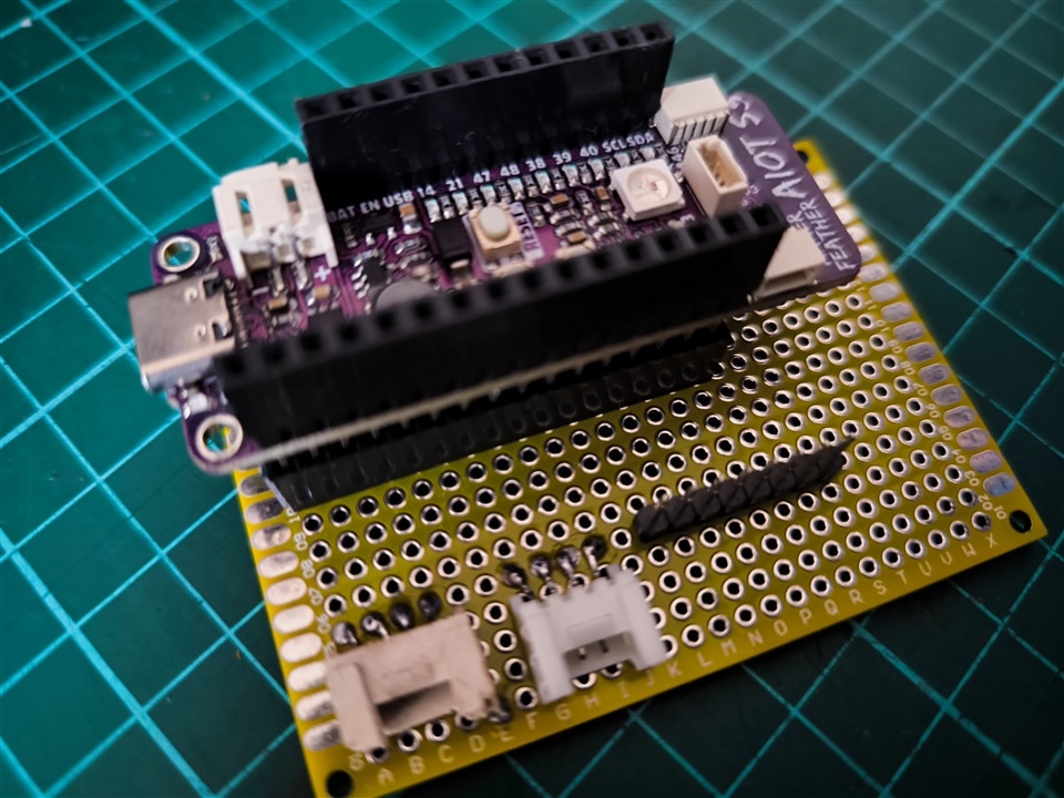

Since both the lcd are sharing the same pins, except for the CS pin, I have created simple connection board that can connect both the lcd.

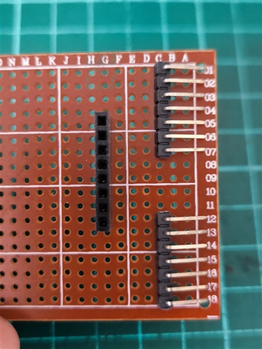

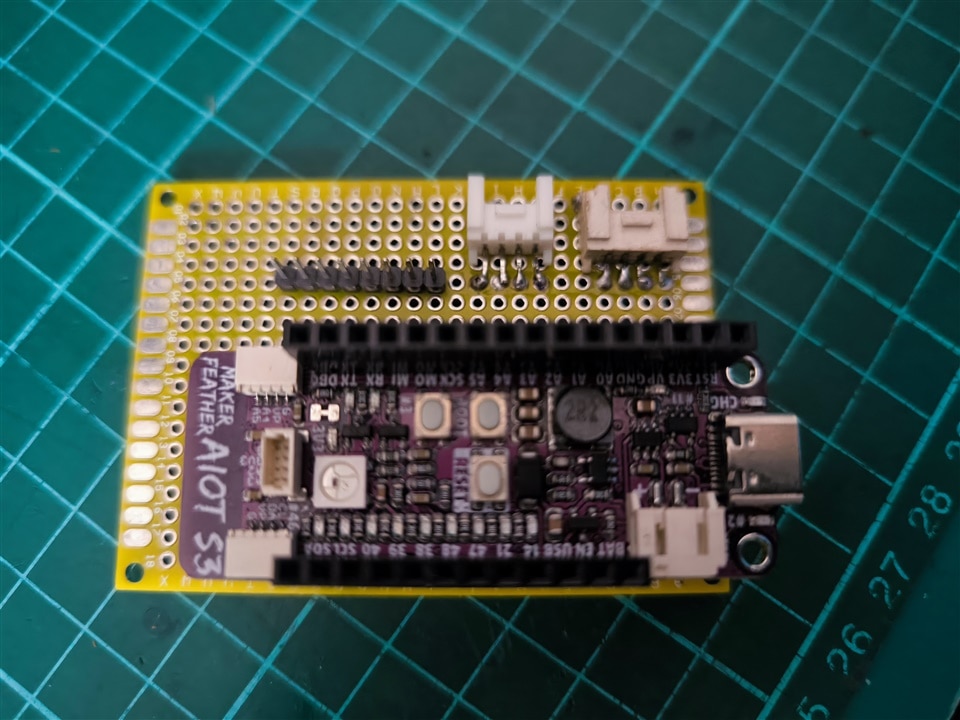

And also i have make simple interfacing board to connect the Maker Feather ESP32 to the Seeed Grove MP3 module and LCD module. The another grove port just the extra port.

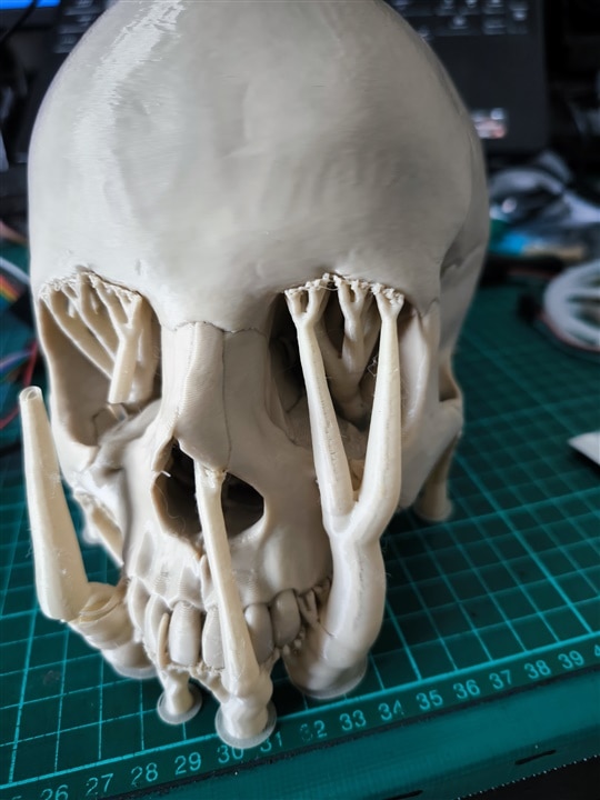

Wrench Step-by-Step Build Instructions

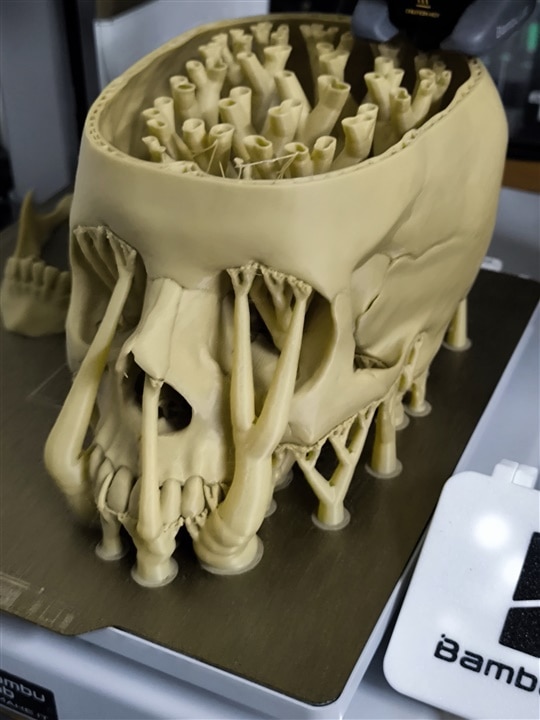

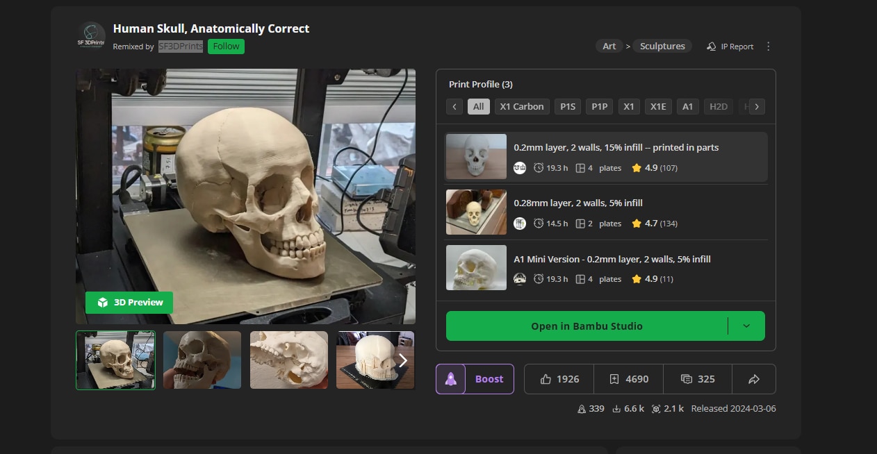

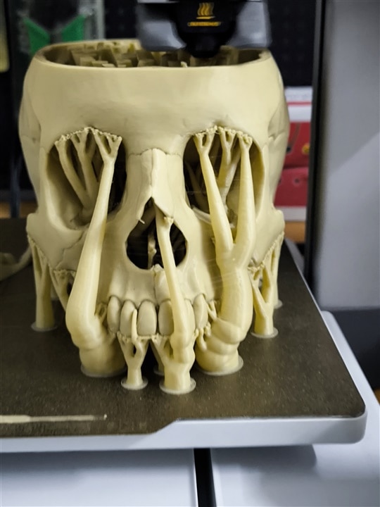

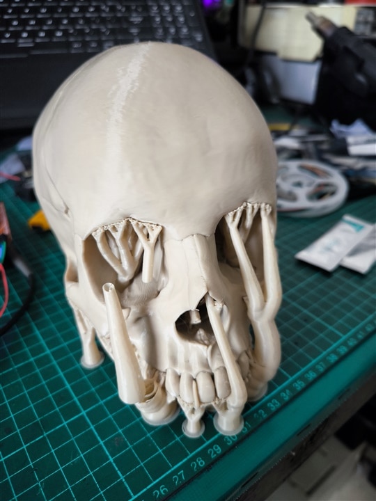

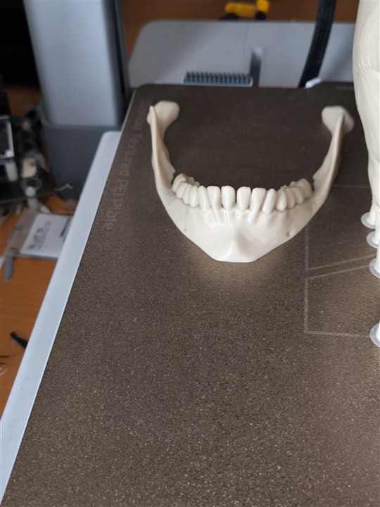

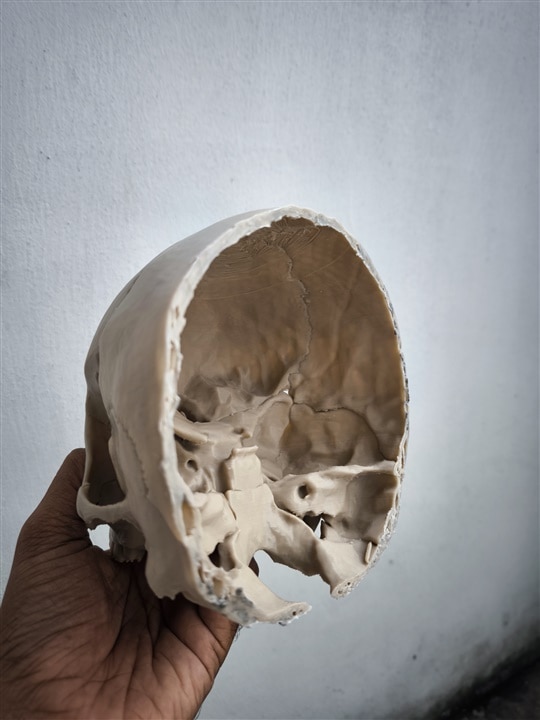

1. 3D Printing
The first step that i did in building this project is deciding the model of the skeleton. I decided to 3D print the skeleton. I have used the design from SF3DPrints. The model can be downloaded from here.
Below are some of the pictures and videos of the 3D printed skeleton
{gallery}3D Printed Skeleton
Next, i removed all the supports and check if the 3D printed model looks fine. Next make the cut the skull to half.

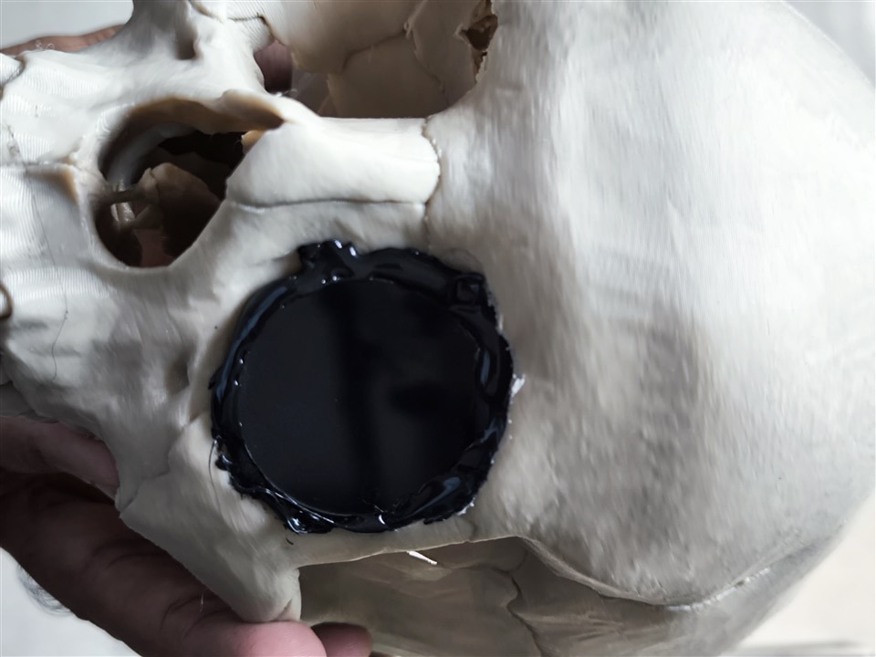

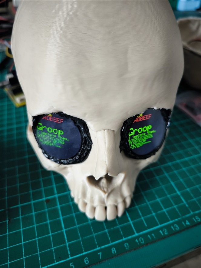

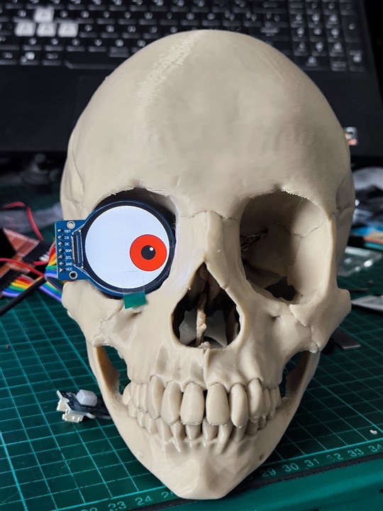

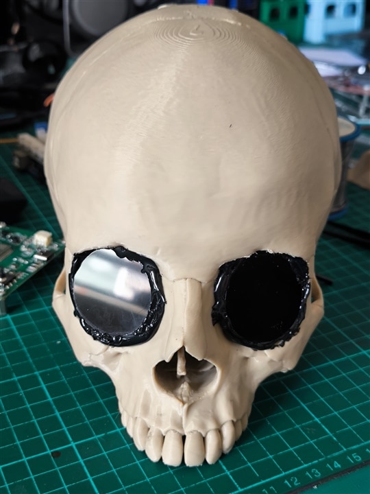

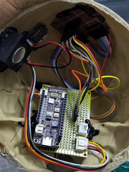

2. Assembling the part
First i try to fix the lcd to the eye socket. I have to make some cutouts before i can fix the lcd to eye socket and i have use hot glue gun to hold the lcd at its place

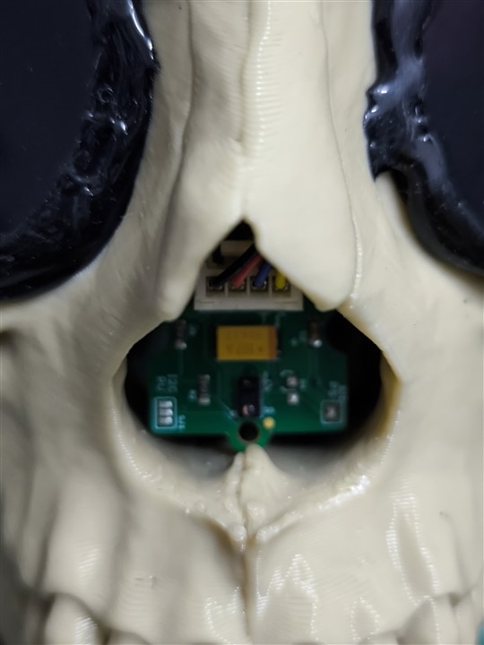

Next i have place the APDS9960 sensor inside the nose hole as can be seen in the picture
Once it is in place i have use the hot glue gun as well to hold it in place. And i have placed all the components inside the skull
