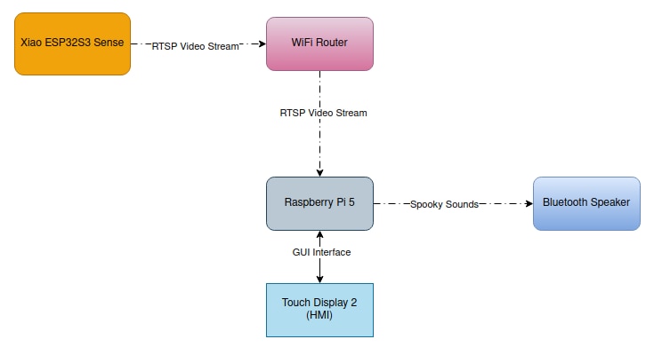

Hardware for this Spooky Build
At the edge of this scare system is the Xiao ESP32S3 Sense, a compact camera with built-in WiFi that provides an RTSP video stream wirelessly and is small enough to hide inside decorations. Its low power consumption allows it to run on a USB power bank for hours, eliminating the need for visible power cables that might give away its location.Remember to attach a heatskink to it as it gets really hot while streaming the video.
For processing the video stream and running the motion detection algorithms, I chose a Raspberry Pi 5 with 4GB of RAM with the Touch Display 2 attached for portability.
While this might seem excessive for a Halloween decoration, the Raspberry Pi provides the computing power needed to run OpenCV and perform real-time computer vision. It can process 25-30 frames per second while managing the GUI interface and triggering audio playback at the same time. The Pi's Bluetooth capabilities also allow it to connect wirelessly to the speaker, keeping the entire system hidden.
The audio delivery system consists of a portable Bluetooth speaker that can be placed anywhere within 30 feet of the Raspberry Pi. This wireless connection allows the speaker to hide behind victims or beside the walking path, maximizing the surprise factor. I selected a speaker with good bass response to deliver those deep, resonant screams that make people jump. The ability to run on battery power means the entire system—camera, processor, and speaker—can operate completely wirelessly if needed.

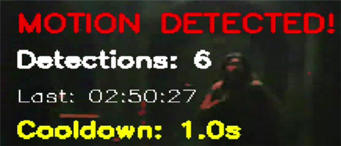

motion_detected, fg_mask, motion_contours, motion_area = self.detect_motion(frame)
    current_time = time.time()
    time_since_last_scare = current_time - self.last_scare_time
    # only trigger if motion detected AND cooldown period has elapsed
    if motion_detected and time_since_last_scare >= self.cooldown_seconds:
        # play sound in separate thread to avoid blocking
        threading.Thread(target=self.play_scare_sound, daemon=True).start()
        self.last_scare_time = current_time
        self.detection_count += 1
        self.last_detection_time = datetime.now().strftime('%H:%M:%S')
This ensures each person gets one good scare as they pass through, then the system resets for the next victim.The system tracks statistics including total detections, successful triggers, and false positives, providing valuable data for tuning sensitivity.

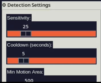

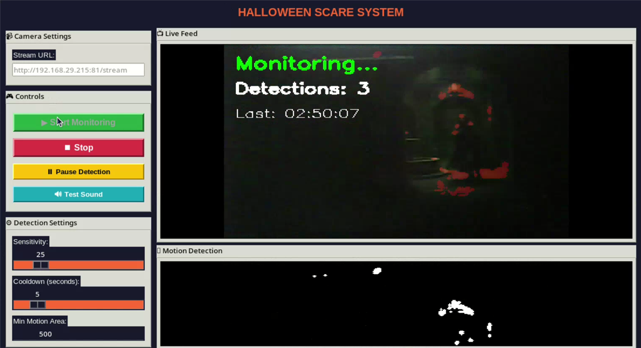

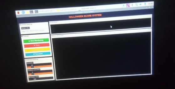

User Interface
A simple GUI transforms this project from a headless script into an accessible system anyone can operate. Built with Tkinter, the interface displays the live camera feed in real-time, overlaying detected motion with red bounding boxes. A separate window shows the background subtraction mask, providing visual feedback about what the algorithm sees. This dual-view approach proved invaluable during calibration, allowing me to understand exactly why the system triggered or failed to trigger.
The control panel includes sliders for adjusting sensitivity, minimum motion area, and cooldown duration—all without restarting the program. This real-time adjustment capability allowed me to fine-tune the system during actual Halloween night operation. If too many false positives occurred, I could increase the minimum area threshold on the fly. If lighting conditions changed, sensitivity adjustments compensated immediately.
A statistics display tracks the number of detections, successful scares, and the current system status.
Solving the Technical Challenges
Network latency was the first major challenge. RTSP video streaming has built-in delays, and processing time adds to this. The total delay from movement to sound needed to stay under 300 milliseconds to keep the feeling of real-time response. I optimized OpenCV's video capture buffer to hold just one frame, which stops old frames from piling up. The background subtraction algorithm uses simple morphological operations for quicker processing, and I turned off shadow detection since it increases processing time without providing a significant benefit for this task.
Bluetooth audio introduced its own latency of 100-200 milliseconds. While this delay can't be completely removed, I made up for it by pre-loading all sound files into memory instead of reading them from disk when they were triggered. Pygame's audio system starts with a small buffer size to reduce any extra delay. I also adjusted PulseAudio settings to focus on low latency rather than audio quality, since having perfectly synced timing is more important than high-fidelity sound for sudden scares.
False positives were tricky, especially when the camera was aimed at trees, curtains, or other things that move in the wind. The morphological filtering helps, but the real fix came from careful camera placement and tuning the thresholds. I learned to keep the camera away from known problem areas, to increase the minimum motion area when it was windy, and to let the background model warm up for enough time before starting the triggering. Testing in different conditions showed that 30 seconds of initialization creates a stable background model.
                # Play sound in separate thread to avoid blocking
            self.display_frame = self.draw_overlay(frame, fg_mask, motion_contours, motion_detected)
            self.motion_mask = fg_mask
            return self.display_frame, fg_mask

class HalloweenGUI:
    def __init__(self, root):
        self.root = root
        self.root.title("Halloween Scare System")
        self.root.geometry("1200x750")
        self.root.configure(bg='#1a1a2e')
        # Style configuration
        style = ttk.Style()
        style.theme_use('clam')
        style.configure('TFrame', background='#1a1a2e')
        style.configure('TLabel', background='#1a1a2e', foreground='#ffffff', font=('Arial', 10))
        style.configure('Title.TLabel', font=('Arial', 16, 'bold'), foreground='#ff6b35')
        style.configure('TButton', font=('Arial', 10, 'bold'))
        style.map('TButton', background=[('active', '#ff6b35')])
        self.scare_system = HalloweenScareSystem()
        self.update_thread = None
        self.is_updating = False
        self.setup_gui()
        self.update_stats()

        settings_frame = ttk.LabelFrame(left_panel, text="Detection Settings", padding=10)
        settings_frame.pack(fill='x', pady=5)
        ttk.Label(settings_frame, text="Sensitivity:").pack(anchor='w')
        self.sensitivity_scale = tk.Scale(
            settings_frame,
            from_=10,
            to=100,
            orient='horizontal',
            bg='#1a1a2e',
            fg='white',
            highlightbackground='#1a1a2e',
            troughcolor='#ff6b35',
            command=self.update_sensitivity
        self.sensitivity_scale.set(self.scare_system.sensitivity)
        self.sensitivity_scale.pack(fill='x')
        ttk.Label(settings_frame, text="Cooldown (seconds):").pack(anchor='w', pady=(10, 0))
        self.cooldown_scale = tk.Scale(
            settings_frame,
            from_=1,
            to=30,
            bg='#1a1a2e',
            fg='white',
            command=self.update_cooldown
        self.cooldown_scale.set(self.scare_system.cooldown_seconds)
        self.cooldown_scale.pack(fill='x')
        ttk.Label(settings_frame, text="Min Motion Area:").pack(anchor='w', pady=(10, 0))
        self.area_scale = tk.Scale(
            settings_frame,
            from_=100,
            to=2000,
            bg='#1a1a2e',
            fg='white',
            command=self.update_area
        self.area_scale.set(self.scare_system.min_motion_area)
        self.area_scale.pack(fill='x')

    def update_video(self):
        """Update video feed - optimized for low latency"""
        if not self.is_updating:
            return
        frame, motion_mask = self.scare_system.process_frame()
        if frame is not None:
            # Update main video feed with reduced processing
            frame_rgb = cv2.cvtColor(frame, cv2.COLOR_BGR2RGB)
            img = Image.fromarray(frame_rgb)
            # Fixed display size
            display_width = 640
            display_height = 360
            img = img.resize((display_width, display_height), Image.Resampling.NEAREST)  # Faster resize
            photo = ImageTk.PhotoImage(image=img)
            self.video_label.config(image=photo)
            self.video_label.image = photo
        if motion_mask is not None:
            # Update motion detection feed
            motion_rgb = cv2.cvtColor(motion_mask, cv2.COLOR_GRAY2RGB)
            motion_img = Image.fromarray(motion_rgb)
            motion_img = motion_img.resize((display_width, display_height), Image.Resampling.NEAREST)
            motion_photo = ImageTk.PhotoImage(image=motion_img)
            self.motion_label.config(image=motion_photo)
            self.motion_label.image = motion_photo
        # Reduced delay for faster updates
        self.root.after(16, self.update_video)  # ~60fps update rate
