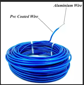

    Full Length.     Close Up.  Aluminium Wire
    You are right. This is a PVC insulated Aluminium wire normally used for drying cloths here. This is a strong wire and can't be bent easily...Will check on Teflon insulated Single stand wire. The looping back till the top is a good idea. I had done that some time back with 1.5 core, Insulated Copper wire (Multi-Stands). I need to check how this would work, will give it a try.

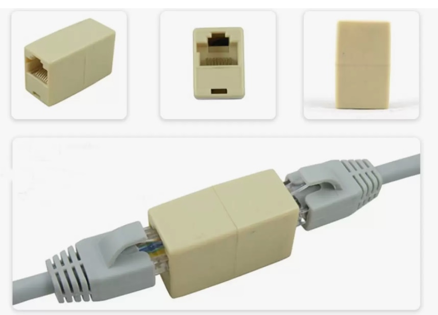

    W.r.t 75ft CAT5 cable, I have a single LAN cable upto from Sump to the OHT. The connections on either side (Arduino on one side and sensor on the other side)  of this wire is taken with the help of connector as shown below...Connections are stiff and conducting properly
    Connector

    What insulation is on the wire? PVC insulation absorbs water. I notice you put some kind of sealer on the ends of the wires, are you sure that isn't leaking? I like to use teflon insulated wire, and rather than one wire down, I like to do a loop down and back up so there is complete insulation only in contact with the water.

    How are you connecting 75ft of twisted pair? Are you replacing the 30ft, or adding 45ft? Soldered or just twisting the wires together?
