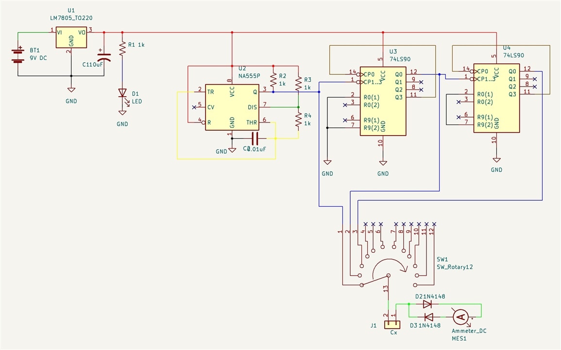

Here I have used a 555 timer IC along with a 74LS90 Decade counter to measure the capacitance using DC Ammeter.
555 Timer is used as a square wave generator in this circuit. During the High (1) square wave cycle, the capacitor (Cx) charges up to approximately 3.5 volts. During the Low(0) Cycle, the capacitor starts discharging.

The NE555 is used as an astable multivibrator in this circuit, it generates the square wave at the frequency of 48KHz with a 66% duty cycle rate. i have chosen R1,R2 = 1K ohm and c = 0.01uF.
To find the frequency f = 1.44/(R1+2R2) X C
                                     = 1.44(1K+2X1k) X 0.01u
                                     = 48 KHz (Theoretical Value)
48KHz square wave signal is connected to the Decade counter Clock input, the 74LS90 Is activated to count function by enabling R0(1), R9(1) to Logic 0
A Rotary switch is used in this circuit to select the measuring scale range, This circuit can able to measure the Capacitor Value from 1nf - 10uF.

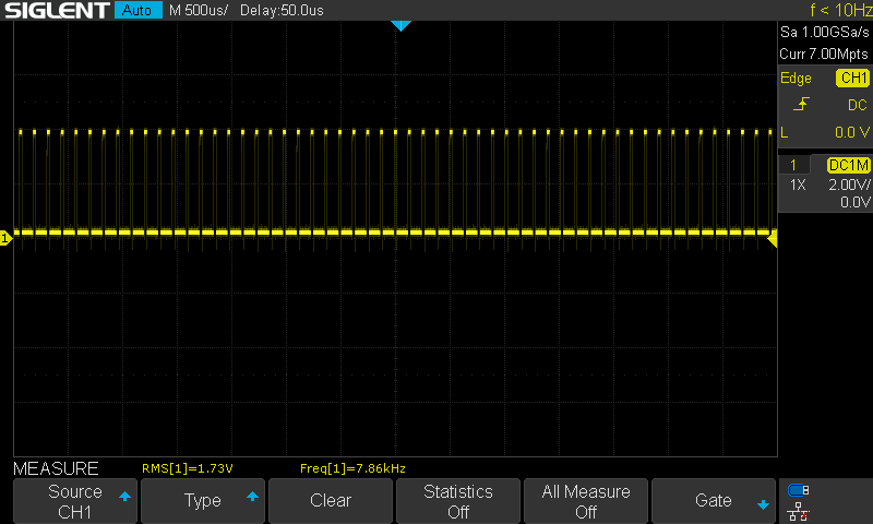

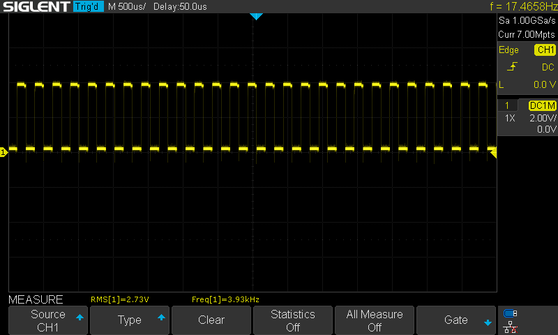

Output Waveform Of 555 Timer The theoretical Output frequency is 48KHz and the Practical Output Of the Circuit was 39kHz
Output Of First Decade counter on the 12th pin of the IC  (Output of First counter is then Fed to 2nd counter)
Output Of Second Decade counter on the 12th pin of the IC
