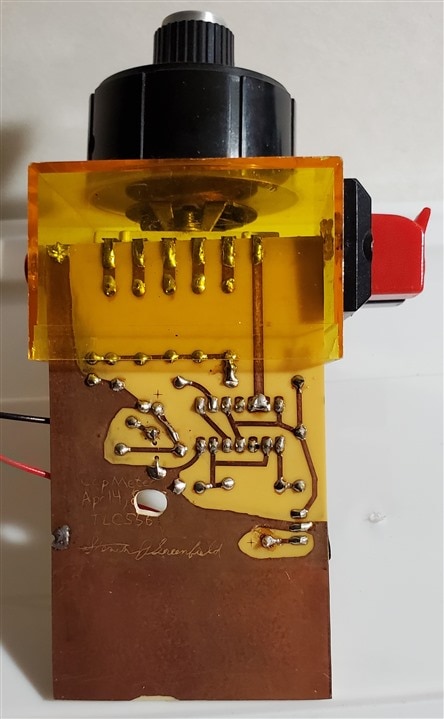

Two 555 timers turn capacitance into an analog voltage readable on a DMM. With a modern 600.00mV scale, that is readable to 10e-11F.
I became an avid user of the 555 timer shortly after Radio Shack started carrying the first 555 timers in the '70s. I didn't like the construction articles I saw in magazines, so I designed my own. I kept showing them to people, they'd ask where I bought it, tell me I am a liar, then ask me how much. I lost track of how many I built.
Originally, I used a 50uA panel meter from Radio Shack for the display. Later, when DMMs became reasonably priced, I started building them without a display, calibrated for a 10M DMM. I still have one of my ugly prototypes from then, not the first one, but close to it. It is in an ugly orange plastic box that I think had perfume in it. Good to 0.1pF on the 200.0mV scale and up to 20uF if you let the meter auto up to 2V on the highest scale.
I recently connected it to my new DMM that has a 600.00mV scale, and found it was stable enough at least in the short term to reliably detect 10fF (femtofarad) or 0.01pF changes with only a digit of instability.

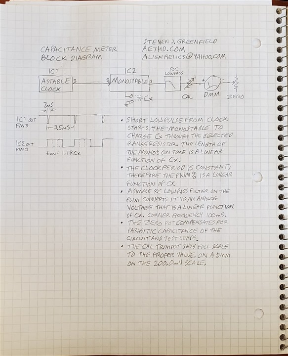

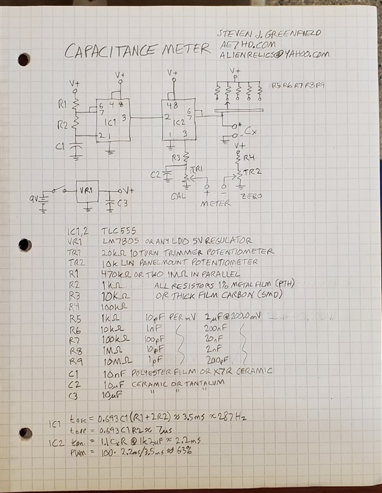

The operation of the circuit is fairly simple. Please note that, although I used a TLC556, which is a dual 555 timer in the circuit, on the schematic the pin numbers assume two separate TLC555 timers.
The first section of the timer, wired as an astable oscillator, provides a steady clock signal with a very short Off pulse, which goes to the Trigger input of the second section of the timer.
The second section of the timer is wired as a monostable. The On time is determined by the resistor selected and the unknown capacitance connected to pins 6 and 7.
The output is therefore a PWM signal with constant clock speed, and the PWM percentage is a linear function of the capacitance being measured.
An RC lowpass filters this PWM to a low ripple DC signal. A ten turn trimpot is used as the Calibration adjustment and goes to the red positive lead of your DMM.
The black negative lead of the DMM goes to a voltage divider which compensates for the PWM output caused by parasitic capacitance. This is done as a front panel control for zeroing, so you can attach test leads and zero them out before connecting a capacitor.
C1 is a mylar capacitor, aka polyester film, as it was a reasonably priced temperature stable capacitor in that range of capacitance.
The low pass capacitor at the output is not critical in value or type. I just used a 4.7uF aluminum electrolytic capacitor.

    Nice! That's a very popular but super-effective topology, that gives good results. I'm tempted to make this for the fixed 200 pF range. Also, this topology is very convenient for adapting for digital…

    Yes, if there had been microcontrollers at the time, that's what I would have done. It converts capacitance into time. I don't know if I'm the first person to do this with 555 timers, but if not I was one of the first.
    I was inspired by a magazine article where someone used some logic gates in a similar fashion. I didn't like it, as it only had two ranges and had a lot of issues because the hysteresis and switching points of a logic IC are going to vary from device to device, and with time, temperature, and supply voltage.
    Compared to that, a 555 timer is very well behaved.

    That's a very popular but super-effective topology, that gives good results. I'm tempted to make this for the fixed 200 pF range. Also, this topology is very convenient for adapting for digital readout, by connecting that output from pin 3 directly into a microcontroller, and counting the width using rising/falling interrupts.
