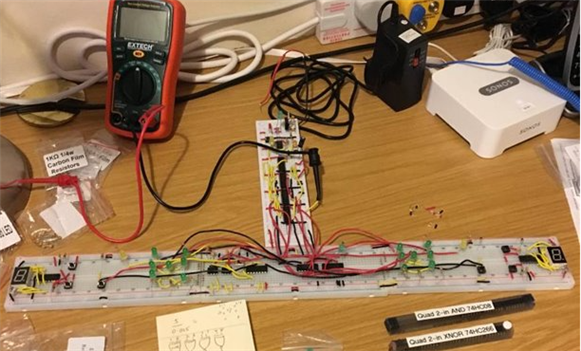

    I didn't but I wish I had.  I guess if I put my mind to it I could re-create it.  The core of it, 'randomising' a dice, actually came from Make: Electronics by Charles Platt so I wouldn't want to post the whole lot anyway.  I extended it quite a bit to duplicate the circuit to provide a two player set up for snap.  Press your button if the die faces match and it locks out your opponent and increases your score, on the 7-segment display, IF you were correct.  All logic chips: I even used a XNOR gate!

    Did you ever sketch out a schematic of the build?
    That is one of the major downsides of breadboarding I have come to learn. If you don't transfer the project to a pcb/perfboard eventually is gone forever :(
