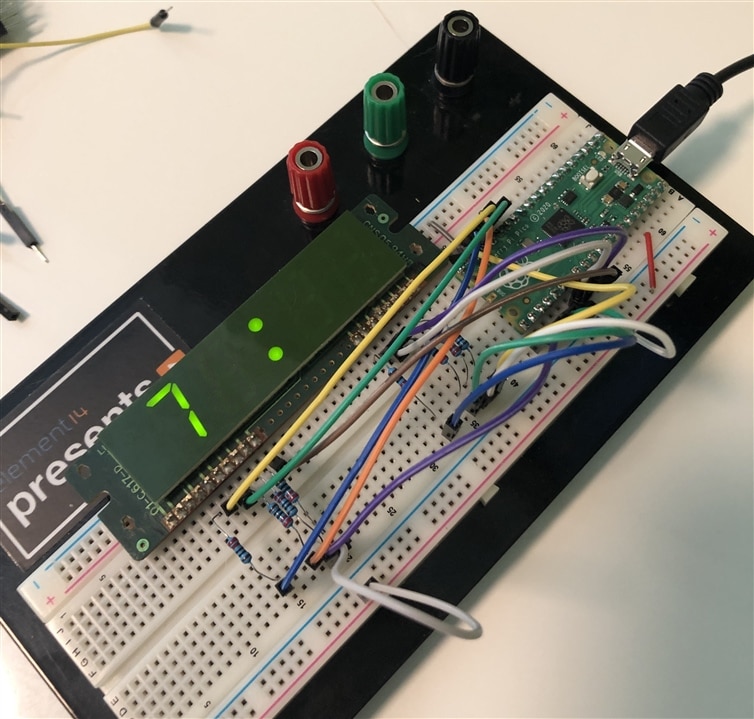

In this first step to building a digital timer, I've set up a clock display with a Raspberry Pi Pico, and then I simply have the Pico step through the 4 clock positions, showing each digit 0 through 9 for each position. At the same time, the divider colon flashes with each count.
It adds a few more wires, compared to the single-digit 7-segment display I had before: 4 wires to select one of 4 digit positions, 1 wire to control the divider colon (that divides hours:minutes or minutes:seconds), and 1 wire to provide power to the divider colon, as well as a current limiting resistor for the colon too.
Pi Pico Testing a Clock Display
I've sped up the timing a bit so it doesn't take long to test all the positions.
As you might notice, I put the clock display just a little too close to the Pi Pico, covering GP15, so I had to change one of the segment pins for this example. Because all the segment pins are defined as constants, this was very easy to do - just change the 15 to a 12 and plug the wire into the GP12 spot by the Pi Pico!
This is just a small step forward after having figured out how to control a single 7-segment display (see my previous blog posts for that). It just takes a few more wires, and a few extra bits of code that aren't much different than before.
