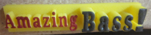

7. 3D print “AMAZING BASS !” nametags for the speaker enclosures

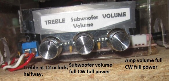

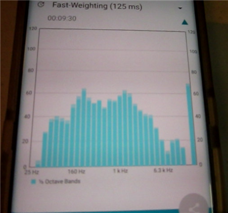

2. The PC speakers were turned up full power for the comparison test. Measurements were taken 4 feet from speakers.
Here is an example screen shots of the spectrum analyzer. The comparison videos at the end of this report include the spectrum measurements for both PC speakers and AMAZING BASS! .

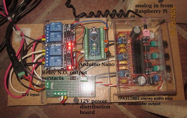

3. Select my Amazing BASS  Audio AMP: It needs to pack a punch and be inexpensive. It needs volume adjust on the subwoofer and stereo, and tone adjustment knobs.

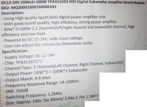

I got this TPA3116D2 class D Amplifier on Ebay for $11 .
Specs :  12-24V input 50W X2  and a 100W subwoofer channel.
     I standardize on 12V on my projects whenever possible for commonality of my on hand parts, and to battery power if desired.

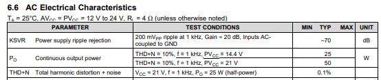

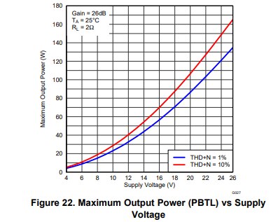

     With 12V input , the power output I anticipate is half the specifications 25W X 2  and 50W subwoofer and are more than needed on the retrogame console anyway.  Double checking the      manufacturer’s output spec, the TPA3116D2 IC has a 7.5A max output.
the TPA3116D2 data sheet says 10% distortion at 25W with 14.4V input. http://www.ti.com/lit/ds/symlink/tpa3116d2.pdf
@ 12V input this interpolates to ~21 W. i.e. we wont crank this amp to maximum to avoid distortion.

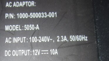

At 100W/12V = 8.3A power supply needed for maximum power RMS output. 6A is likely more than enough for abusive use. This is a variable that can be tweeked.
I have a 12V 10A supply from another project.  SAVE MORE $$$

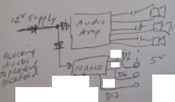

PROBLEM: When the amplifier is first powered up, it sees the speaker loads and sags the power supply bad , causing it oscillate, sometimes wont come up and makes a lot of undesirable and possibly damaging noise.
To fix this problem, an Arduino nano and N.O. relay outputs are used to keep the speakers disconnected from the audio amplifier until the amplifier is booted up.
The Arduino nano waits 3 seconds after power is applied to close the output relays, each one at a time, one second apart, to connect each speaker to the audio amplifier.
The Arduino Nano code:
  turn on relays on a couple second time delay on pickup.
  Relay output HIGH, coil = OFF, the N.O. contacts open
// the setup function runs once when you press reset or power the board
void setup() {
  // initialize digital pins as an output.
  pinMode(2, OUTPUT);
   pinMode(6, OUTPUT);
   pinMode(12, OUTPUT);
digitalWrite(2, HIGH);   // turn the LED on (HIGH is the voltage level)
    digitalWrite(6, HIGH);   // turn the LED on (HIGH is the voltage level)
digitalWrite(12, HIGH);   // turn the LED on (HIGH is the voltage level)
// the loop function runs over and over again forever
void loop() {
  delay(3000);
    digitalWrite(2, LOW);   // turn the LED on (HIGH is the voltage level)
delay (1000);
    digitalWrite(6, LOW);   // turn the LED on (HIGH is the voltage level)
delay (1000);
digitalWrite(12, LOW);   // turn the LED on (HIGH is the voltage level)
The audio Amp assembly

  1. The bandwidth for the amplifier per the datasheet says 14 Hz – 100 kHz…….yea…OK

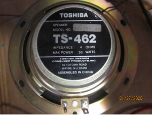

Cost inexpensive:  reused 2  car speakers , I have on hand.
The car speakers are 6 inch diameter , 30W 4 ohm. These Toshiba TS 462 are the perfect wattage for this RetroPi console with AMAZING BASS.
They are designed for use with infinite baffles ( trunk deck) or door panel installation.

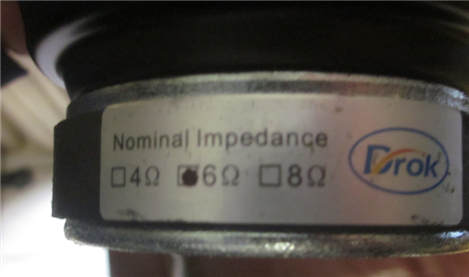

4.5” subwoofer.  bandwidth 66-2KHz   40W  6 ohm. I picked 6 ohm to be able to drive more power than an 8 ohm speaker.
The speaker needed to be somewhat compact and portable , at most 50W ( @ 12V driven 41W with 10% distortion).
IC datasheet shows to drive at ~35W for 1% distortion @ 400Hz.
The subwoofer nameplate is fairly useless  :-)
This chart for the speaker agrees with my calcs, speaker is a good match for this amp's power.

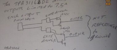

Unfortunately, the amplifier description itself doesn’t say exactly what the amplifiers subwoofer channel output bandwidth is.

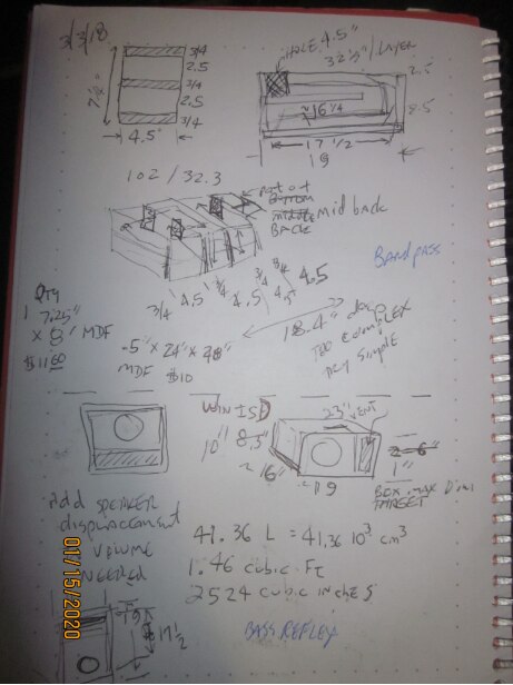

  1. Evaluate different enclosure types . Reference
https://diamondaudio.com/support/box-building.html
Transmission line enclosure , too large and too much work to build.
Bass Reflex enclosure too big.
Sealed enclosures could be used for the left and right side speakers, but no no no for the subwoofer.

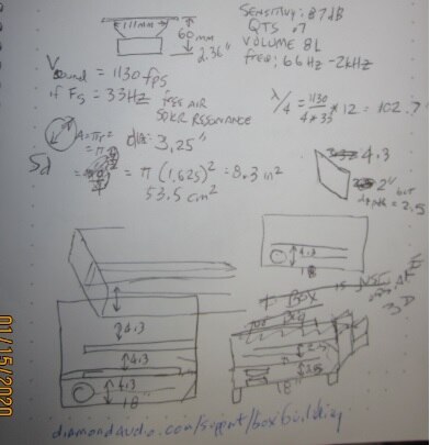

Settle on ported design as best chance for success for the AMAZING BASS! subwoofer

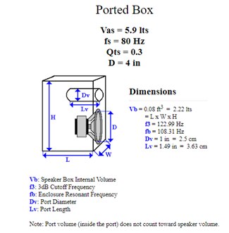

However, real calcs need real Thiele/Small speaker parameters of the speaker(driver)

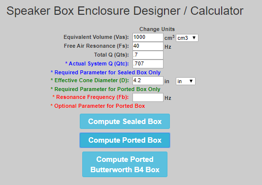

https://www.diyaudioandvideo.com/Calculator/SpeakerBoxEnclosure/
experimenting with this enclosure calculator,
  • observe the Vas parameter & Q determines enclosure box volume
  • Fs (free air resonance) sets determines vented port dimensions
Design details on a $20 speaker arent available.
will have to measure what can be measured and swag numbers from similar already engineered products
"Vas (read V-sub-A-S) is one of several well-known Thiele-Small parameters¹ commonly associated with mid- and low-frequency moving-coil audio transducers (aka drivers.)
Vas represents the equivalent volume of air having the same acoustic compliance (i.e., ‘stiffness’ or ‘springiness’) of the driver suspension in free air. In other words, it indicates the equivalent volume of air that would produce an air-spring with springiness (i.e., compliance,) equal to that of the driver’s suspension; it is NOT the recommended box volume for a driver. (For mathematical purposes box or enclosure volume is typically denoted as Vb, read V-sub-B.)
     Vas (in liters or m³) = ρ c² Cas = ρ c² (Sd)² (Cms)
Where
     *ρ is the density of air; approximately 1.18 kg/m³ at sea level, 50% RH and 25 °C
     *c is the speed of sound; typically 345 m/s at sea level and 25 °C
     Sd is the effective surface area of the driver diaphragm (in m²)
     Cas is the acoustical compliance of the driver suspension (in m/N)
     Cms is the mechanical compliance of the driver suspension (in m/N)
     *(Corrected for temperature, pressure and humidity)"
researching comparable examples of speakers(drivers) with published parameters.
https://loudspeakerfreaks.com/Product.asp?mfr=Peerless%20by%20Tymphany&part=NE123W-08&Product_ID=11254

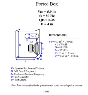

The 40W 4 inch subwoofer speaker(i.e. driver) ( see URL) has a Vas =5.9 L and a Q of .35 , free air resonance = 61Hz.
Surveying several models Q is consistently in the .3 to .4 range.

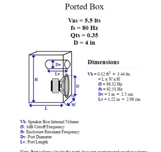

This 4.5 inch driver Vas=5.5, Q=.4, Fs = 65Hz.
https://loudspeakerfreaks.com/Product.asp?mfr=Monacor&part=SPH-115&Product_ID=5538
The free air resonance can be measured for my speakers.
Refer to instructions:  https://www.youtube.com/watch?v=EMhmVmtQ4BI
This You Tube video provided the audio to do the measurement. https://www.youtube.com/watch?v=3m5d6DlkWj8 I like this one because it stopped every 5 Hz and announced the frequency.
My subwoofer measures 80Hz free air resonance.
The Toshiba car speakers measure 150 Hz free air resonance.
My video doing the the free air resonance test procedure and taking measurements for this speaker.
https://youtu.be/maRZfj91uuE

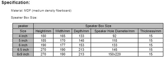

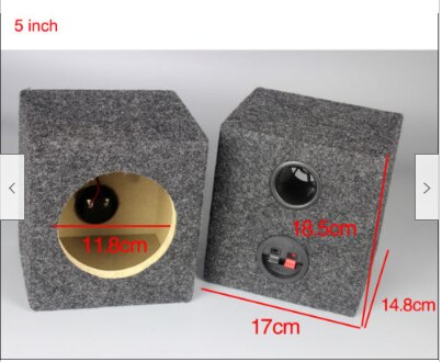

now, comparing commercially available enclosure for a guideline:
Sanity Check dimensions to a commercially available subwoofer enclosure:
https://www.ebay.com/itm/2PCS-4-5-6-6-5-inch-Ported-Subwoofer-Enclosure-MDF-Loudspeaker-Speaker-Box-/332029910671
This vendor’s published table:
Commercially available subwoofer enclosure for a 5 inch subwoofer
MDF   6.7 inches X 7.3 inches X 5.83 inches
MDF is 5/8th ( .625” ) inches thick, 15 mm,  subtract from dimensions. ~6 X 6.7 X 5.25 = 213 in3
213 / 1728 =   .123 cu ft.   total volume of box + port

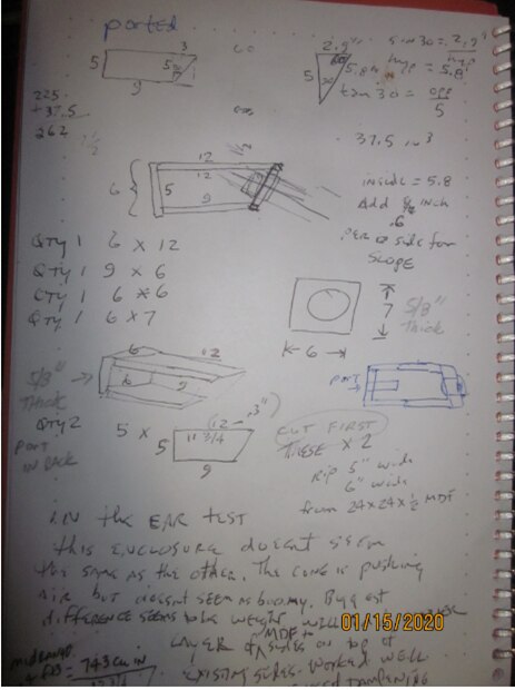

NOW FOR MY AMAZING BASS WOOFER ENCLOSURE CALCS:
6 calcs https://www.diyaudioandvideo.com/Calculator/SpeakerBoxEnclosure/ were made to see effect of driver parameters variance on the enclosure dimensions:
NOTE: Dv diameter = 1 inch ………1 inch outer diameter PVC pipe has 7/8 inner diameter I used PVC pipe cut to length for port tuning.
Since the certain specific woofer speaker data was not available, it was approximated by comparing to other commercially available examples.
6” X 5 “ X ~ 10.5” = 315 cu in     .182 cu ft

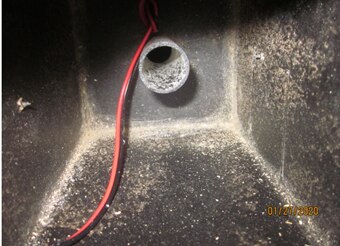

1 inch PVC pipe, 2 inches long used for the port
The woofer sides were double reinforced for stiffness. The inside edges and cracks were caulked, and the inside was sprayed with Plasti-Dip spray rubber for a bit of dampening.
