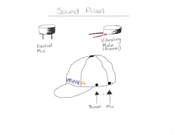

I started thinking about solutions to the direction problem and ended up with the idea of 2 microphones connected to vibration motors embedded into a baseball cap or hair band. Something like the diagram below.
So hopefully if a loud noise occurred, the user would get a buzz on either side of the cap, depending upon which direction the noise was coming from. In order for this to be useful I figured it would have to fit into a baseball cap or Alice band so it needs to be a relatively small circuit. Also I want to keep it as simple as possible.

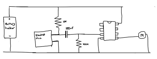

I have some electret mics that I have had for a while but I don’t have the data sheet. I looked at the data sheet of a similar mic and it showed a basic connection diagram like this.
I knew that I couldn’t just connect a microphone to a vibration motor, because I figured the output from the microphone would need amplifying, plus I needed to control the ouput, but I tried it anyway. Obviously I was right. I needed to do something to read the output and trigger the vibration motor. The question was how could I do that?

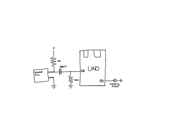

Some time ago I made a clap switch using an electret microphone and an Arduino UNO which turned on and off an LED. I dug out the little drawing I always do when I make a circuit.
It was something I found on the internet  and it is very simple circuit and sketch. Connect the electret mic’s output to one of the UNO’s analogue pins and an LED to one of the digital pins. If a sound goes above a certain value, send the digital pin high, or low if it is already high. All I had to do was swap out the LED and swap in the vibration motor. Then I made a few simple changes to the sketch namely getting rid of the switching function and making the vibration motor vibrate longer according to how loud the detected sound was. Once completed I had something that at least worked.
The only problem really was that using an uno made it too big to fit in a hat. The actual mic circuit is quite small so I started thinking how to make it smaller.

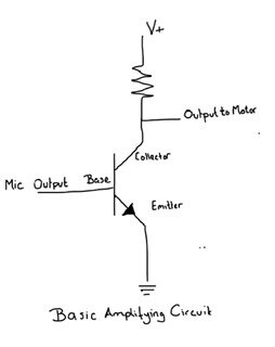

At first I wondered if I could just amplify the output from the mic and I tried hooking up a transistor as per the  following diagram but that didn’t work because whilst I could light an LED I couldn’t get enough power to make the vibration motor work.

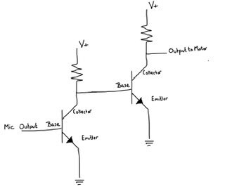

I saw circuits that have two transistors as per the diagram below.
The result seemed no better than the single transistor. I suspect that this can be done but my ignorance defeated me here and the other circuits I found on the internet had too many components (I guess to correct whatever is wrong with the simple circuit) and as I am trying to keep this fairly simple I looked elsewhere for the solution. This is something for me to come back to in the future. All too often I find myself wanting or needing to know something but the investment in time to achieve that knowledge is too great at that point in time. I need to know everything NOW!!!

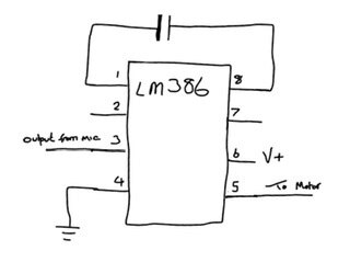

Next I tried an LM386 because I figured the components I didn’t want to add were already built inside. Again I just tried hooking the mic up as per diagram below and again I got the same results; it lights an LED but won’t make the motor work. Again I know I’m missing something here but at the moment I don’t know what.
So at this point I thought about adding an L293 or a relay into the circuit to drive the motor but as I said earlier I want this to be relatively simple and ultimately small and fairly light.imageimage

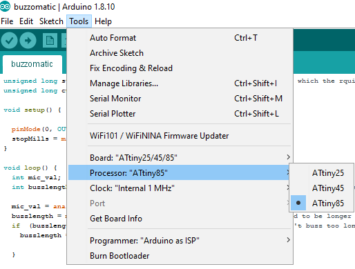

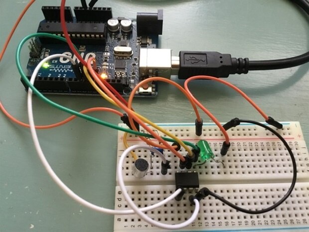

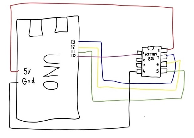

So  I have some ATTINY85 chips and I swapped one of these into the Arduino circuit. Then I loaded the ArduinoISP sketch which comes with the built in examples into my UNO. Then I connected the UNO to the breadboard in order to make the connections as per the diagram below.
I then selected the appropriate board. See screen shot below.
And then I  loaded my sketch into The ATTINY85 and it worked!  The photo below shows it all set up for programming the ATTINY85.
This is my code
