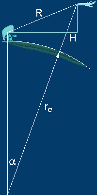

I will only be concerned with the three-letter identification code at this time, as this transmission is considered a slant-range which is based on a line of sight using the following formula: Rtopogr = R · cos ε, where ε represents the angle of R or Slant Range and H or Height,  but this will only work if the EARTH WERE FLAT! Or you could use this model (see box): Where you have a line between the center of the antenna and the center of the Earth, this must include the published height of the antenna,  which is bisected by re is defined as the distance between the center of the Earth to the height of the Where H continues to the aircraft.  α is defined as an angle between the center of the antenna to the center of the Earth and re.  Therefore R is the slant range!
R2 = re2 + (re + H)2- 2re(re + H) · cos α
which depends on the ratio of:
360° · Rtopogr = α · 2πre
which accounts for a spherical earth.
So let's say you are flying at 10k feet and you are headed to Meacham Field in Fort Worth and you have left Addison Airport in Addison Texas and you are on a course of 251.5  degrees  NAV radio is tuned to 115.7 you would be hearing Ranger Vortac, FUZ, and Morse Code three-letter id is:  '..-. ..- --..' . I have a midi file but I can't get there from here!
BTW: At 10,000ft, the horizon at approximately 100nm; At 20,000ft, the horizon at approximately 140nm; At 30,000ft, the horizon at approximately 170nm.

  1. The diagram above came from www.radartutorial.eu
