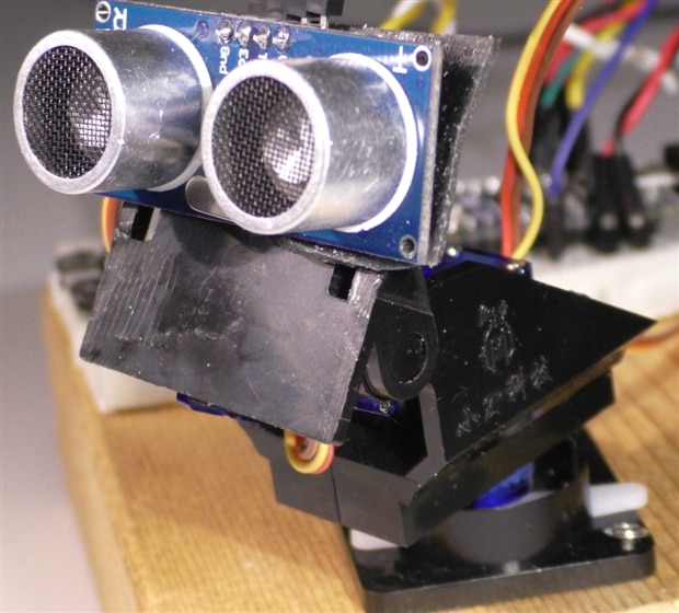

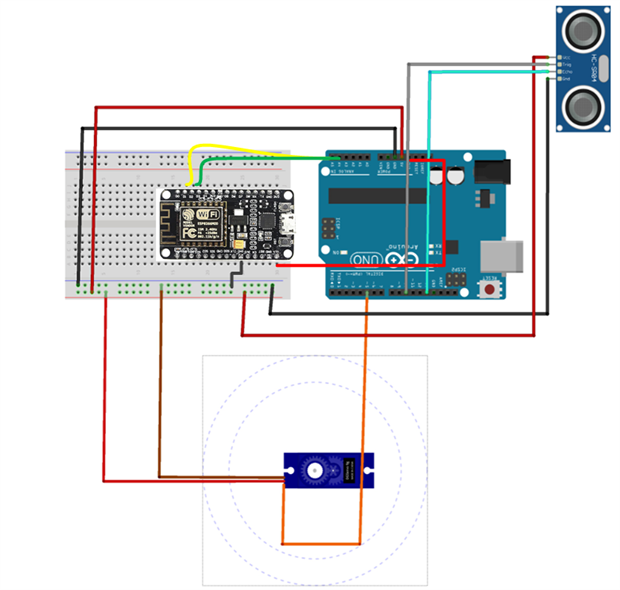

Figure 1 shows the hardware design. I mounted an HC-SR04 ultrasonic sensor on a tilt-pan servo and attached the tilt-pan servo and ultrasonic sensor to the Arduino. The Arduino pans the environment while taking readings for the HC-SR04 senor for every degree the servo moves. The ESP8266 wifi module requests the sonar data from the Arduino. Finally, the Processing software module on the PC reads the sonar data sent by the wifi module and displays the data on the PC screen.
Figure1. Hardware Design

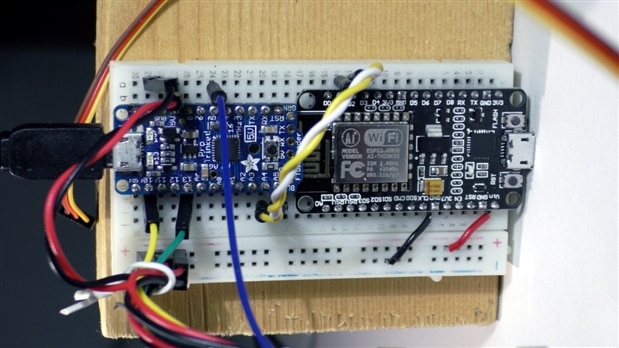

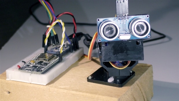

I mounted the Arduino, ESP8266, HC-SR04, and tilt-pan servo on a wooden block. A 1A, 5-volt USB battery supplies power to all of the components. It gives me the ability to set the Ultrasonic sensor anywhere within wifi range and monitor the environment from my PC on the same network.

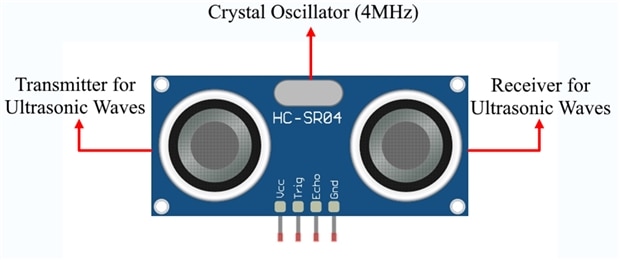

The HC-SR04 is an inexpensive ultrasonic distance sensor. Developers mainly use it to range the distance from an object. It is popular with DIY roboticists for collision avoidance in mobile robots. Other uses for ultrasonic distance sensors include speed and direction measurement, wireless charging, humidifiers, medical ultrasonography, and burglar alarms.
The HC-SR04 consists of a transmitter, receiver, and a crystal oscillator (Figure 2). The transmitter converts an electrical signal to ultrasonic waves, while the receiver converts the ultrasonic waves back to electrical signals. The purpose of the crystal oscillator is for timing operations.
The HC-SR04 works between 2cm to 400cm away with a resolution of 3mm. However, for the best results, range between 10cm and 250cm. Its measuring angle is 30o (15 degrees on either side of the sensor.) It uses approximately 15mA, and its operating voltage is 5 volts.
Figure 2. HC-SR04 Ultrasonic Sensorimage

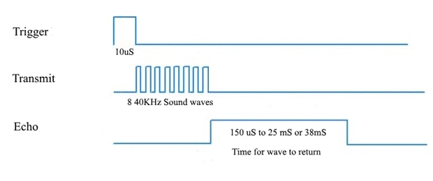

How the HC-SR04 Works

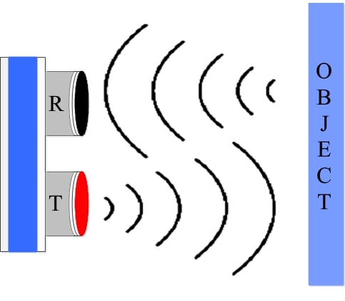

The HC-SR04 is an ultrasonic transducer. It converts a digital signal into an ultrasonic wave. Ultrasound is sound waves with frequencies higher than the upper audible limit of human hearing, which is approximately 20 kHz (20,000 hertz). The HC-SR04 operates at 40 kHz.
When you set the trigger pin high for 10uS, the HC-SR04 generates eight 40kHz sound waves (Figures 3 & 4) and sets the Echo pin high. If the sound waves hit an object, the waves bounce off the object back to the HC-SR04. When the waves reach the HC-SR04, the HC-SR04 sets the Echo pin to low. The waves will take between 150 uS to 25 mS to return to the HC-SR04. The HC-SR04 will set the Echo pin to low if the waves do not return within 38 mS (The waves did not reflect off an object.) Therefore, anything that takes longer than 25 mS is considered an out of range condition.
Figure 3. HC-SR04 Ultrasonic Sensor Timing
Figure 4. Ultrasonic Waves
You can use the following formula to calculate the distance of the object:          d = (v x t)/2
Where:
d - equals the distance to the object
v - equals the speed of sound
t  - equals the time sound waves take to come back after reflecting off an object (called the duration).
Note that we need to divide the value by two because the time recorded by the Echo pin is twice the distance of the object to the HC-SR04. The duration is the time the waves travel to and from the detected object. Dividing it by two will give the actual distance of the target object.

Mini Pan-Tilt Kit
I used the Mini Pan-Tilt Kit (assembled), from Adafruit, to pan the environment (Figure 5). I mounted the HR-SR04 to the Pan-Tilt Kit. I only connected the top servo to the Arduino since I only want to pan the area 180 degrees, side-to-side. I mounted the Pan-Tilt Kit to a block of wood with two screws.

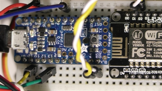

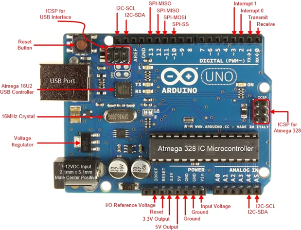

Arduino Uno R3
The Arduino Uno R3 (Figure 6) and its variants are the most popular microcontroller used by robotic DIYers. I used the Arduino to drive the servo motor on the Pan-Tilt Kit and to process the data from the HC-SR04 sensor during development. I also use it to provide sensor data to the ESP8266. You can learn more about the Arduino Uno R3 on the DIY-Robotics website.
Figure 6. Arduino Uno R3

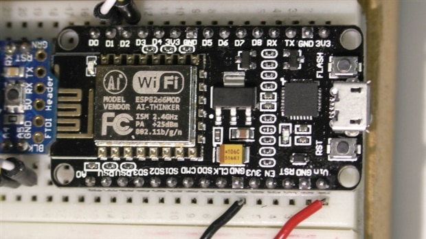

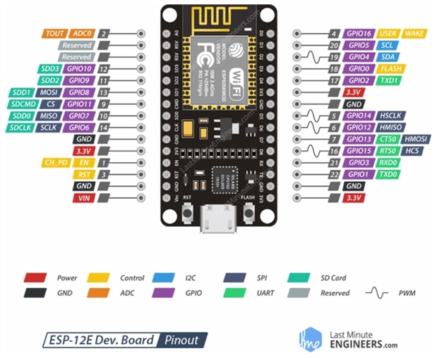

ESP8266 NodeMCU Wi-Fi Module
To communicate with the Processing module on the PC, I used the ESP8266 NodeMCU Wi-Fi Module (ESP-12E Module). The ESP8266 contains a full TCP/IP stack and comes with microprocessor capabilities (Figure 7). The ESP8266 NodeMCU Wi-Fi Module comes with the Arduino firmware pre-loaded on the chip. The specifications are:
  • 80 KB of Ram
  • 4MB of Flash Memory
  • 80MHz Processor
  • 11 GPIOs
  • 3.3V Operating Voltage
  • 1 10-bit ADC
  • 1 Serial Line
  • 1 I2C Bus
  • 1 SPI
  • PWM on all I/O Pins with 10-Bit Resolution
  • 2MBPS Wi-Fi
  • 802.11b/g/n Wi-Fi Transceiver
  • Voltage Regulator
  • USB Interface
Note that the pins are not 5V tolerant, applying more than 3.6 volts on any pin will destroy the chip. A GPIO pin can only draw a maximum of 12mA.
A sketch running on the ESP8266 must share resources (CPU time and memory) with the Wi-Fi and TCP-stacks (the software that runs in the background and handles all Wi-Fi and IP connections). If your sketch takes too long to execute, it might affect the background process (TCP stack) and may crash the system or lose data. It is best to keep your sketch's loop execution time short as possible, preferably under a couple of hundreds of milliseconds. Note that every time the main loop is repeated, your sketch yields to the Wi-Fi and TCP to handle all Wi-Fi and TCP requests. You can explicitly give CPU time to the Wi-Fi/TCP stacks by using including a delay(0) or yield(). Also, note that if your loop takes longer than 3 seconds, the soft WDT (Watch Dog Timer) will reset the ESP8266 chip.
Figure 7. ESP8266 NodeMCU Wi-Fi Module

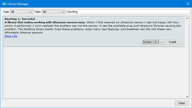

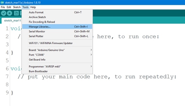

Install the NewPing and Servo libraries
From the Arduino IDE, click on Tools and then Manage Libraries (Figure 8).
Figure 8. Arduino IDE - Manage Libraries
Enter NewPing in the search box in the Library Manager window and press the Enter key (Figure 9).
When the description for the NewPing library appears, click on the Install button.
Figure 9. Arduino IDE - NewPing Library
Repeat the above process for the Servo library (replace NewPing with Servo).

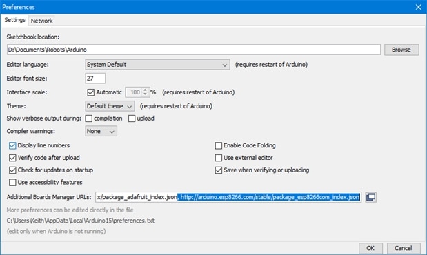

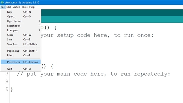

Install the ESP8266 Libraries
The ESP8266 NodeMCU Wi-Fi Module comes with the Arduino firmware pre-loaded on the chip. Therefore, all you have to do to program the chip is to add the required libraries. First, you need to add a line in the Additional Boards Manager box from the Preferences window. To display the Preferences window, click on File, then click on Preferences (Figure 10).
Figure 10.  Arduino IDE - Preferences
Add the following line in the Additional Boards Manager box (Figure 11):
http://arduino.esp8266.com/stable/package_esp8266com_index.json
Note that I already have a URL entered in the box. So, I separated the current URL and the new URL with a comma.
Then, click on the OK button.
Figure 11. Arduino IDE - Preferences: Additional Boards Managerimage

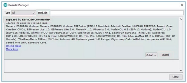

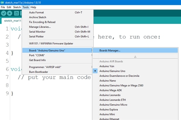

Now add the ESP8266 Community library to the Boards Manager.
Click on Tools, Board, Boards Manager (Figure 12).
Figure 12. Arduino IDE - Boards Manager
Enter ESP8266 in the search box in the Boards Manager window and press the Enter key (Figure 13).
When the description for the ESP8266 Community library appears, click on the Install button.
Figure 13. Arduino IDE - Boards Manager - ESP8266 Communityimage

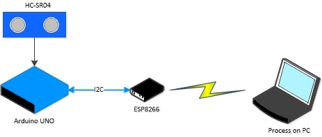

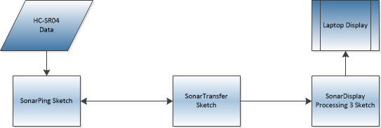

High-Level Design
I developed three sketches to handle receiving the data from the HC-SR04, transferring the data to the PC, and displaying the data on the PC's screen (Figure 14). The first sketch is an Arduino sketch running on the Arduino Uno, called SonarPing. SonarPing pans the HC-SR04 180 degrees, one degree at a time. Every time it moves the sonar sensor one degree, it calculates the distance to an object, stores the distance, and stores the current position of the sensor (in degrees). SonarPing also joins an I2C bus as a slave. The I2C bus connects to the ESP8266 NodeMCU Wi-Fi Module.
The second sketch, SonarTransfer, is loaded on the ESP8266 NodeMCU Wi-Fi Module. It connects to my Wi-Fi network and then to the Processing sketch on my laptop. SonarTransfer joins the I2C bus as a master. It requests data from SonarPing via the I2C interface (distance from an object and position of sonar sensor in degrees). It then sends the data to the Processing sketch via the Wi-Fi interface.
The Processing sketch, DisplaySonarData, receives the data from SonarTransfer, paints the laptop display with a sonar screen, and then displays the sonar data over the sonar screen.
Figure 14. High-Level Design

I tested the sketches with the Arduino Uno and the ESP8266 NodeMCU tethered to my laptop. Attaching both boards to the computer allowed me to test the sketches on both boards simultaneously. To test both boards at the same time, I had to run the sketches in its own instance of the Arduino IDE (I had to start two instances of the Arduino IDE). It gave me the ability to start a serial monitor for each board and add Serial prints to the sketches to debug the code. Once I finished testing, I deleted the debug code and used a USB power pack to provide power to the boards. The ESP8266 NodeMCU board received its power from the Arduino Uno.
I attached the HC-SR04 to the upper part of the pan-tilt kit with velcro. To get the sonar sensor to fit, I cut off the two grips.
I planned to mount the components (half-size breadboard, Arduino Uno, and the ESP8266 NodeMCU) onto the block of wood. The block of wood I selected was too small for the Arduino Uno. So, I mounted an Adafruit Trinket Pro to the breadboard. The wiring is the same as it was for the Arduino Uno. To mount the pan-tilt kit to the board, I attached the bottom of the pan-tilt base to the block of wood with two screws. I took off one of the power rails on the half-size breadboard (to make more room on the block of wood) before mounting it to the board, using the self-adhesive backing on the breadboard.
Note that I used the Trinket Pro instead of a different small board because I had one lying around. Also, note I did my development on the Arduino Uno and moved the wires to the Trinket Pro after I was satisfied with the way the code worked. I could have added an FDDI interface to the Trinket Pro and did my development on the Trinket Pro. Another option I could have used was purchasing the newer Adafruit Metro Mini 328, which has a built-in USB-to-Serial interface.
I planned to use a hot glue gun to attach the Arduino Uno to the block of wood. As I noted above, I instead mounted an Adafruit Trinket Pro to the breadboard.
Once I assembled the hardware, I wired all of the components as follows (Figure 15):
  • 5-volt pin on the Trinket Pro to the positive rail on the breadboard
  • Ground pin on the Trinket Pro to the ground rail on the breadboard
  • Ground pin on the ESP8266 to the ground rail on the breadboard
  • 5-volt pin on the Trinket Pro to the VIN pin on the ESP8266
  • VCC pin on the HC-SR04 to the positive rail on the breadboard
  • Ground pin on the HC-SR04 to the ground rail on the breadboard
  • The brown wire on the servo to the ground rail on the breadboard
  • The red wire on the servo to the positive rail on the breadboard
  • The yellow wire on the servo to pin 5 on the Trinket Pro
  • Trigger pin on the HC-SR04 to pin 10 on the Trinket Pro
  • Echo pin on the HC-SR04 to pin 13 on the Trinket Pro
  • A4 pin on the Arduino to the D2 pin on the ESP8266
  • A5 pin on the Arduino to the D1 pin on the ESP8266
Figure 15. Wiring Diagram
Figure 16. Portable Ultrasonic Object Detector
Figure 17. ESP8266 NodeMCU Wi-Fi Module
Figure 18. ESP8266 NodeMCU Wi-Fi Module

Start the Processing 3 IDE on your PC. Load the DisplaySonarData sketch and run it. You must start the DisplaySonarData sketch before running the SonarTransfer sketch. Otherwise, the SonarTransfer sketch will not attach to the socket. If the sonar display does not appear on the PC try pressing the reset button on the ESP8266 NodeMCU Wi-Fi Module.
Place the block of wood (your scanner) in the area you want to scan. The sonar sensor should face the center of the scan area when it is in the 90-degree position (center position). Plug your scanner in an outlet or use a 1 ampere / 5-volt USB power pack to power the components.
The sonar data should begin displaying in the DisplaySonarData screen. Note that ESP8266 and your PC must be in the range of your router.
