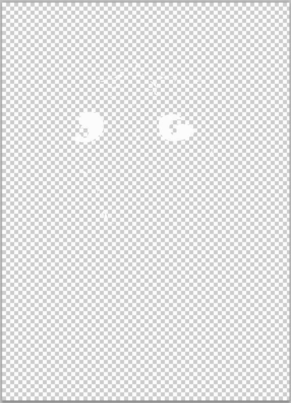

The PCB art is based on the famous work by Edvard Munch called The Scream.  The method used is based on the work of Andrew Sowa, with the main difference being my workflow uses Photoshop and converts the image to grey scale using the "magic wand" to isolate layers rather than a color conversion using Adobe Illustrator to create the bit map for KiCad as Andrew does.  The modified layers are brought into KiCad and converted into a footprint as shown below.  For additional information on the methods used see my first post here.
A palette of colors is created with the bare FR4, copper, solder mask, and silk screen.  The palette resulting from purple OSHPark boards is shown below.
By converting to a grey scale image in Photoshop and then adjusting by trial and error it is possible to isolate the layers corresponding to the palette above.  The layers below have been shaded with the palette and are the ones used in this project.
{gallery} Photoshop Layers
Silk on Copper
Copper
Bare FR4
Solder Mask on Copper
Solder Mask on Bare FR4
Stacked View in Photoshop
Before exiting Photoshop the layers are converted back to a pure black and white image before importing into KiCad.  That process is straight forward although a bit tedious and results in a component footprint as shown in the image below.
The resulting render in KiCad looks like this:
