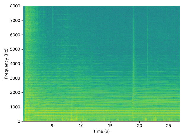

The spectrogram of the extracted audio sequence looked like this:

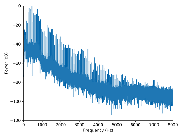

As it can be seen, it contains multiple harmonics of the 50 Hz fundamental. I then extracted a "clean" 5 s segment at the 13 s timestamp and computed the power spectrum density using Welch's method:

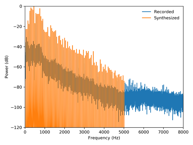

I then measured the amplitude of the fundamental and 99 harmonics and ran 100 oscillators at random phase shifts. The spectrum looked like this:
Even though the spectrums look quite different, they sound similar. Two important differences are that the synthetic hum is stationary, while the recorded one is not (it changes with time), and the second difference is that the recorded hum contains noise (wind on the microphone, etc), while the synthetic hum doesn't. The video compared the recorded segment to the synthetic segment:
I tried covering all harmonics up to lower frequencies using fewer oscillators, but I noticed that with fewer than 80 oscillators the synthetic hum began sounding quite different to the original.
