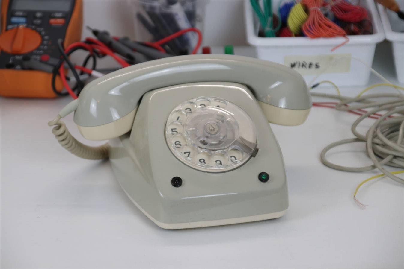

Pi Rotary is based on the upcycling of a rotary phone from the end of 60s' using a Raspberry Pi to create a Pi-rotary smartphone.
A part of the device I decided to exclude is the phone ring bell: controlling an old phone ring bell with digital low voltage signals may be more complex than expected as the bell rings working at a relatively high voltage. Together with the electrical issue, I had to find a way to create the space for the new components and using another class of audio messages – as we will see later – the ring bell results useless.

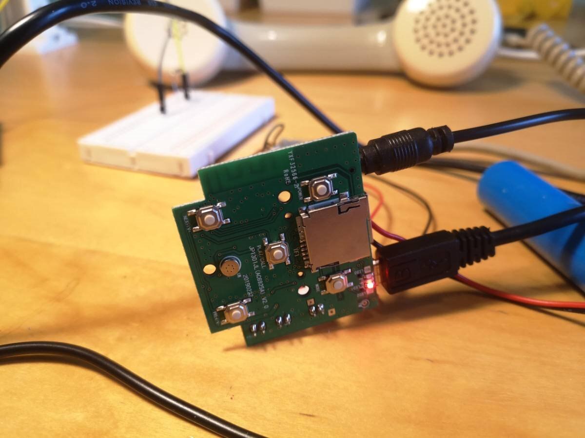

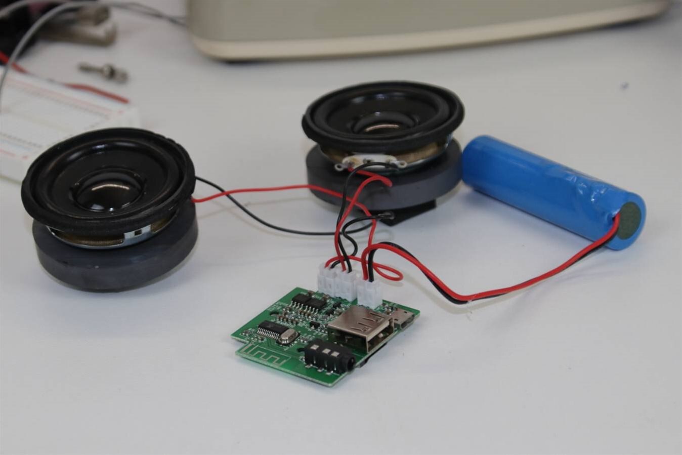

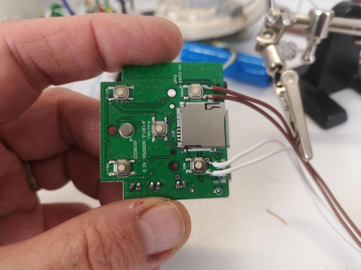

To provide audio features to the device I disassembled a cheap USB and Bluetooth portable amplifier with speakers. the device includes a 3.5 mm Jack audio input for wired connection, used to amplify the Raspberry Pi audio output.
Above: the small amplifier board with the LiIon rechargeable battery and the two stereo speakers.
The amplifier is powered by a temporary switch button. After powering on, the default setting is Bluetooth mode; to switch to wired mode another temporary switch button should be pressed once. The power sequence need the button pressed for about five seconds (until the amplified emits a sound); the same when switching from Bluetooth mode for about half a second.
Above: the amplifier board. The button near the 3.5mm audio jack is the power button while the other temporary switch to the opposite side is the mode button
Pressing the power button for three or five seconds (mine needs five), the device powers on emitting a sound, automatically setting the Bluetooth mode. With the help of a handy multimeter I found the points where the buttons close the circuit and I was able to reproduce the buttons behaviors. Soldering a couple of wires in correspondence to the contacts of the temporary switch these can be controlled digitally. Joining the two end wires of one of the buttons we can expect to obtain the same effect as by pressing it but to control them by the Raspberry Pi needs some electronics.
Above: the control wires soldered to the corresponding temporary switches on the amplifier board.

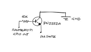

As a matter of fact, when we change the state of a pin of the Raspberry GPIO, we just provide a 3.3V current level, not physically closing a circuit for which we need the equivalent of a relais. The solution is not so complex using a common NPN transistor (I used a PN2222A) for every button: the two soldered wires coming from a button will be connected to the collector and the emitter of the transistor that is normally open (same as the button in its normal state). Sending a digital signal “high” from a GPIO pin to the base of the transistor – and so powering the transistor itself – the transistor closes the circuit and we get the button pressed.
Above: the two buttons wired on the prototype PCB board with the two transistors. The third image shows the button connection circuit.

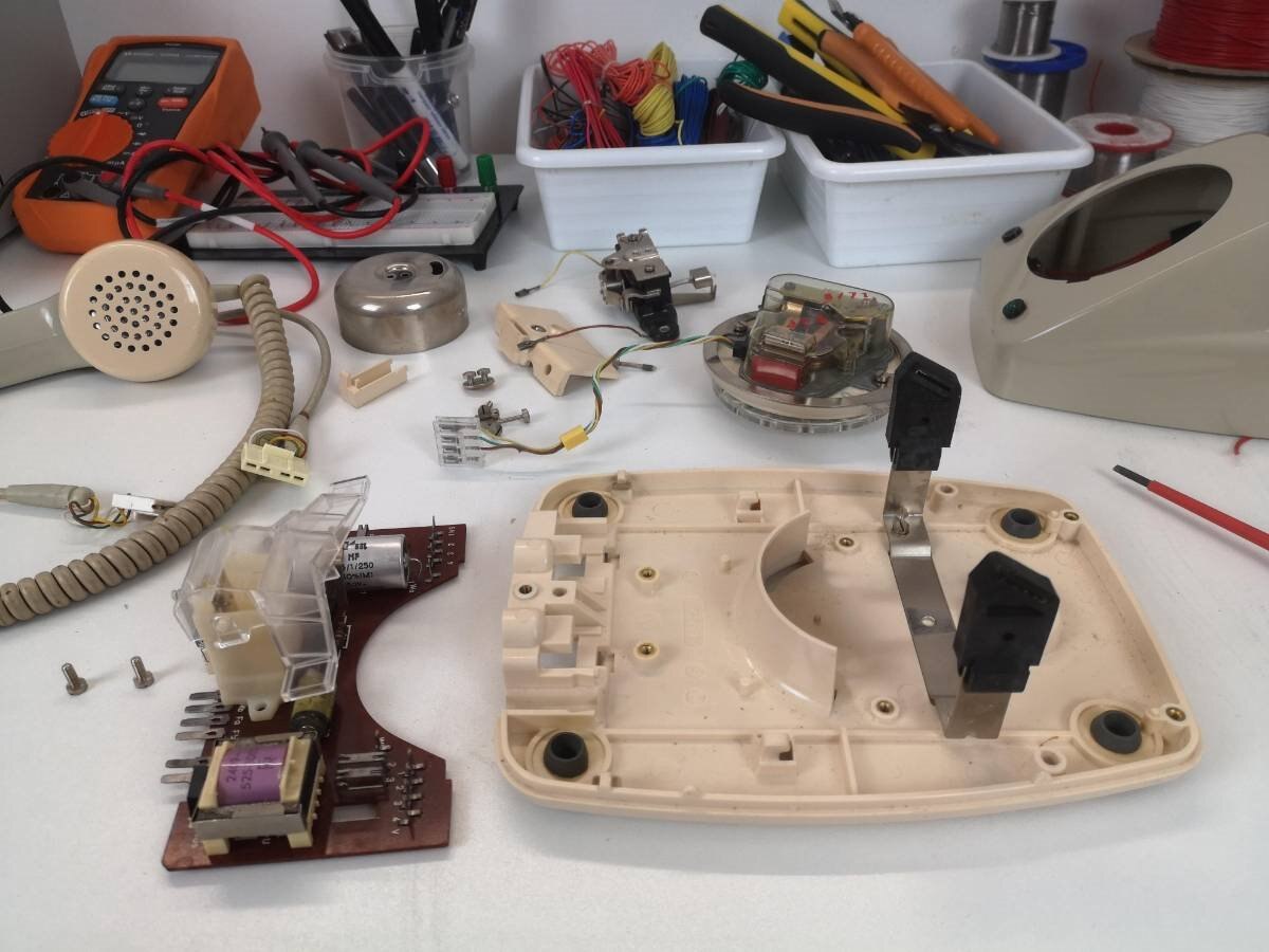

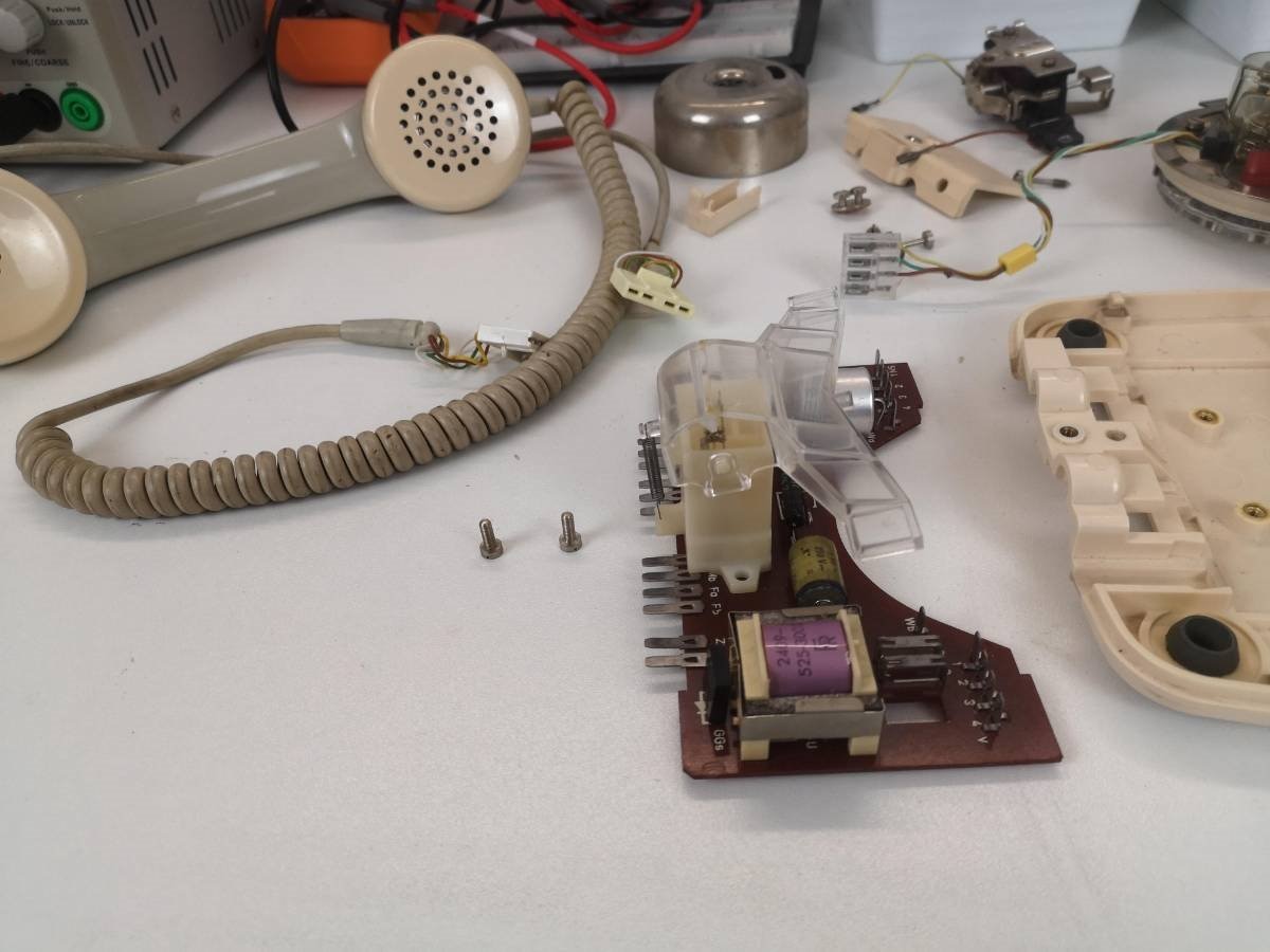

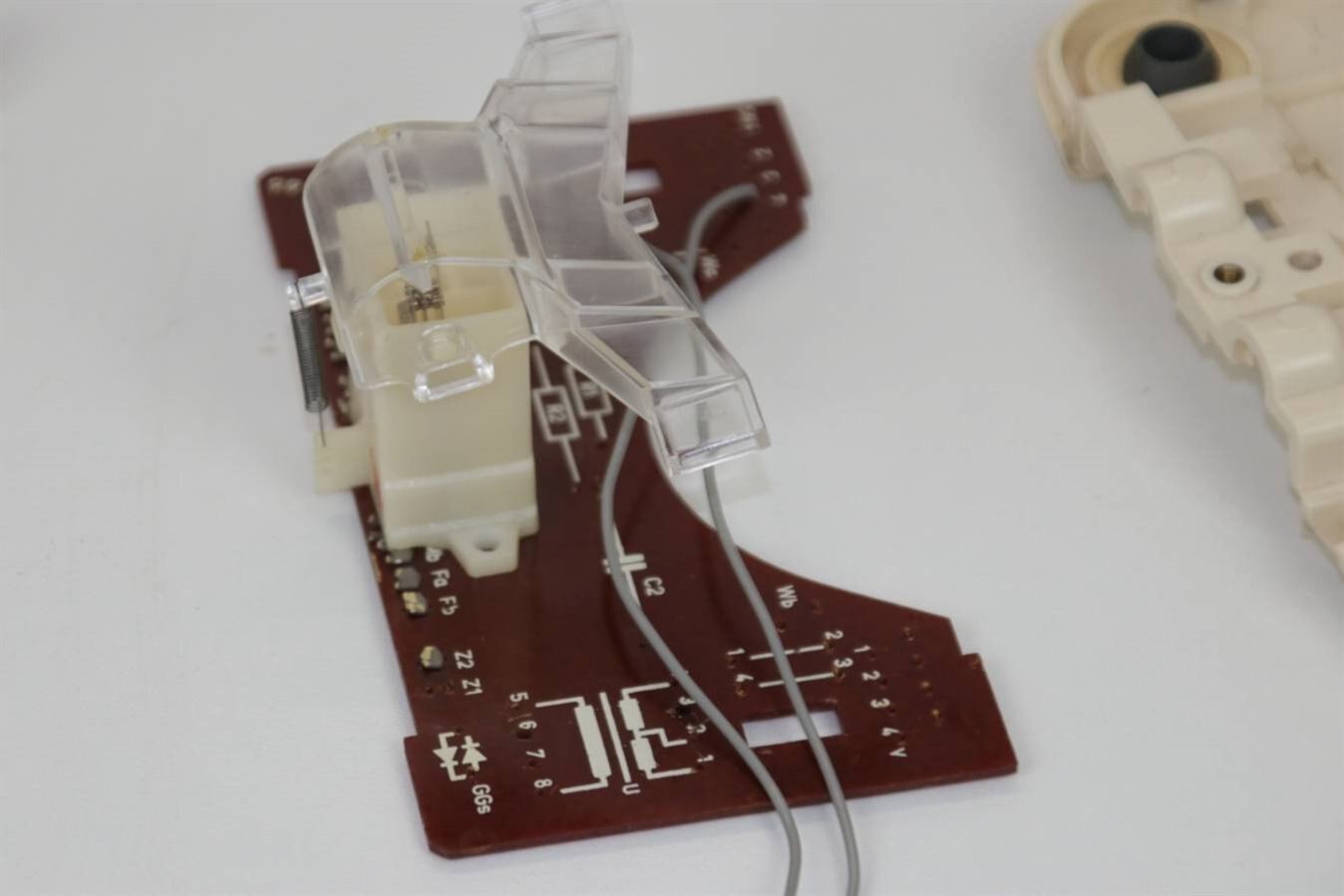

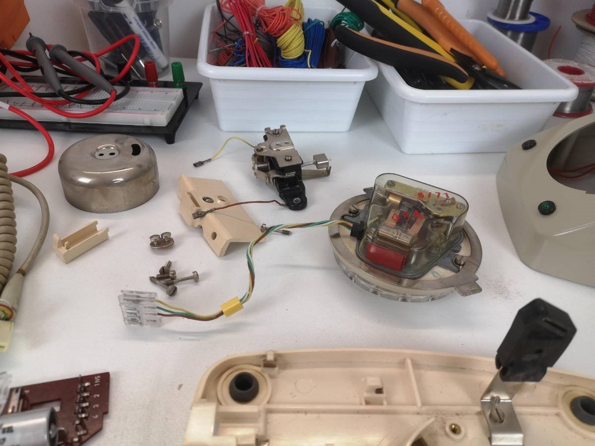

The easiest phone component to connect is the microphone hang-on switch. After removing the ring bell and the solenoid group, I completely disassembled the phone in order to remove the electronic circuit screwed onto the base of the phone case; then, I desoldered the components leaving only the PCB and the hang-on switch.
{gallery} Disassembling the Rotary Phone
The rotary phone fully disassembled
The hang-up switch on the PCB control circuit of the phone

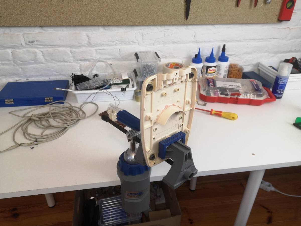

Preparing the phone base to host the new components
The main PCB with the components removed and the hang-up wires soldered on the clean PCB

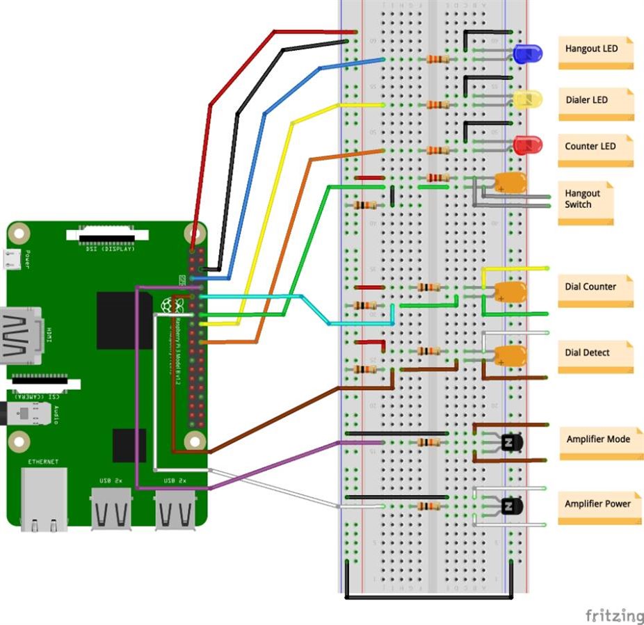

Above: the full circuit to control the telephone and the amplifier buttons through the Raspberry Pi GPIO.
The reading circuit on the hangout switch is the same used reading a common temporary switch button. To avoid multiple readings when the contacts are closed, I have added a 0.1 uF capacitor between the two wires on every terminal of the rotary dial, a debouncing component smoothing the read persistence signal for some milliseconds and avoid false-positive readings.

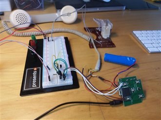

The circuit connected on the Raspberry Pi GPIO to control the amplifier buttons worked fine, as well as the three LEDs used to provide some essential visual notification to the user.

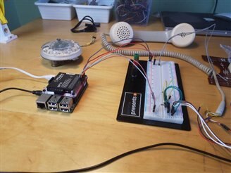

Above: the breadboard test circuit during the design phase, before making the PCB

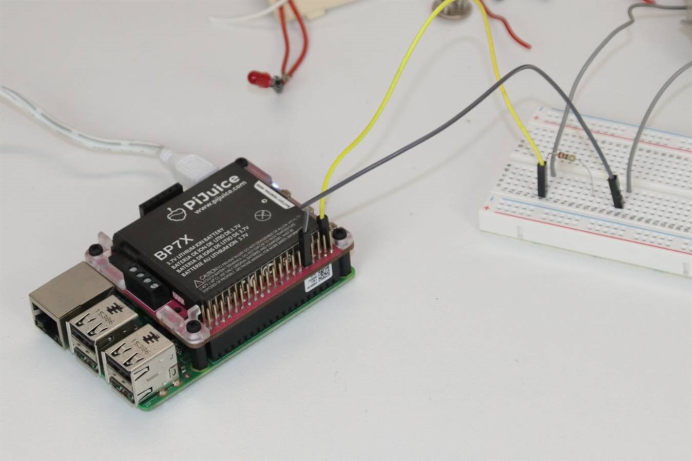

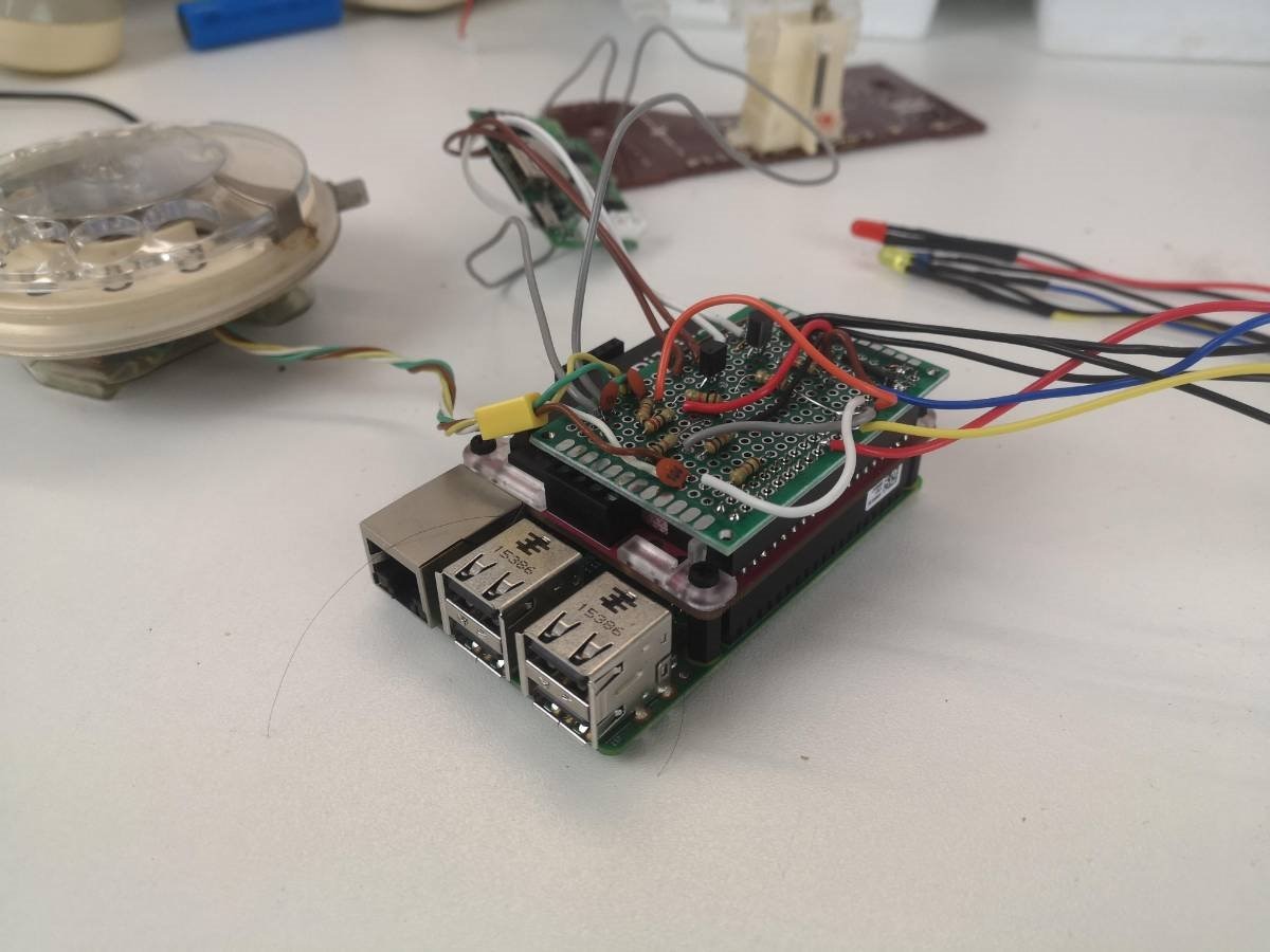

Adapting the circuit and the components to the internal design of the phone to host the Raspberry Pi (with the circuit), the amplifier and the batteries was a challenging task; at least it is what I thought until I  faced the real challenge making all the things working together. I decided to make this project battery-operated because the circuit of the amplifier was already equipped with a LiIon USB rechargeable battery; to power the Raspberry I decided to add a Pi Juice board to run on battery the Raspberry Pi in the most efficient way.
Above: the Raspberry Pi with the Pi Juice HAT
After testing all the components controlled by the Raspberry Pi on the breadboard, using a Pi-sized PCB breadboard I made the final small circuit board fit on the pass-through 40-pins connectors of the Pi exposed by the Pi Juice HAT.
Above: the Raspberry Pi custom circuit to control all the parts of the rotary phone created on a Pi-sized breadboard PCB.

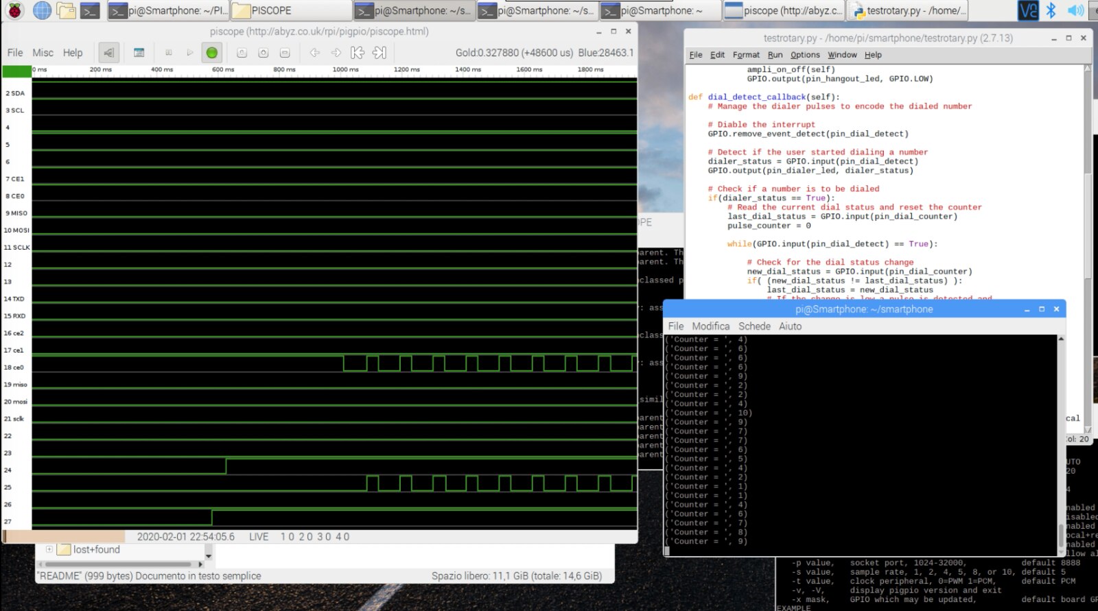

The circuit part to manage the rotary dial pulses is almost easy. If you search on Google you will find plenty of working examples on how to count the pulses generated by the rotary dial and convert them into the corresponding numbers. Unfortunately, the projects and documentation, as well as the source code, to manage this task are based on the Arduino board, and things become more and more complex when trying to accomplish it on a Linux machine like the Raspberry Pi.
Arduino is a microcontroller running continuously a program and as the dialer signal goes high, it starts counting the pulses generated by the rotary dial. The generated pulses can be detected connecting a pin from the board GPIO to one of the two wires of the rotary dialer while the other wire is connected to the power line: when the signal goes high, a pulse is generated for the duration of about 10 milliseconds. The circuitry to reach the same result on the Raspberry Pi using Python is the same as on Arduino. The issue lays in the Linux operating system behavior; when an event happens, like  a pulse is received from a GPIO pin on the Raspberry Pi, it is not certain that the operating system reserves all the resources to this specific task in a timely manner. At least not in the normal way we can expect using the GPIO library for Python and the Python source. This issue turned me crazy for a week as, regardless of the approach, I was always missing detecting some pulses. The correspondence between the number of pulses and the dialed number is direct:
1 = one pulse, 2 = two pulses, 3 = three pulses and so on up to 0 = ten pulses.

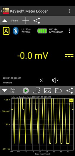

Above: the typical pulse train generated when a number is dialed.
To make things more complex, the rotary dial pulse generator is an analog device; as shown in the above image, the pulse train can have small differences between pulses so sampling the state of the pulse connector at a specified interval can't work fine.
What I needed was a Python library interfacing the GPIO hardware events in a more accurate way; after trying several GPIO libraries for Python, finally I adopted the PiGPIO library (http://abyz.me.uk/rpi/pigpio/python.html) that fits perfectly to solve tasks like this. As a matter of fact this multi-platform library is a C component that can be compiled in the Windows, Mac, and Linux environments, including the Raspberry Pi Linux operating system. The advantage of the library is that it uses a 'daemon', a program running at a lower level than the other common processes like the Python interpreter and can read any GPIO pin status change at a high frequency. An interface available for Python makes it easy to include the features inside the application.
Above: screenshot of the Raspberry Pi desktop. The left window shows a perfect reading of the rotary dial pulse train via the PiGPIO library in Python using the daemon socket.
