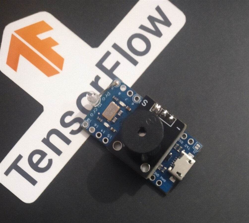

The annoying caps lock buzzer looks like a keyboard to the host PC except it doesn’t have any keys. The host sends the periodic USB output reports to our “keyboard” and when the USB output report is received, our “keyboard” turns the buzzer on or off to match the state of the CAPS LOCK bit in the USB output report.
Think of it like the little indicator LED on your keyboard, but one that makes a terrible screeching noise that you simply can’t ignore. This is made possible by the fact that the Caps Lock status is handled at the OS level rather than the local input device.
As a side effect, you’ll always know when CAPS LOCK is enabled so entering the wrong password, joining lines when you’re just trying to scroll down in to your thesis report , or answering an entire email (to your .boss.) in ANGRY SCREED format should be history.
Things you will need
-Arduino Pro Micro
-Small Buzzer (can be directly powered through Micro)
-An LED (optional; but I chose green one)
Without using the PIC ones (showcased in the original build), I chose to use ATMEGA32U4 based Pro Micro, which also provides the necessary USB 2.0 Data lines for both programming the microcontroller and as a dedicated USB - HID Device (emulated as Keyboard, Mouse, Joystick, PenTest, Rubber Ducky, Remote Injection Tool, etc. etc...tested them all .yay.)
Connections (Clean n Simple)..
- Connect Buzzer+ to pin 3 on pro micro, LED on 9 (your choice) and the rest is ground. You can also use 'pinButton(pull-down)' to initiate a reverse Caps Lock on PC Keyboard from the microcontroller;  'Hacky-way to control'.

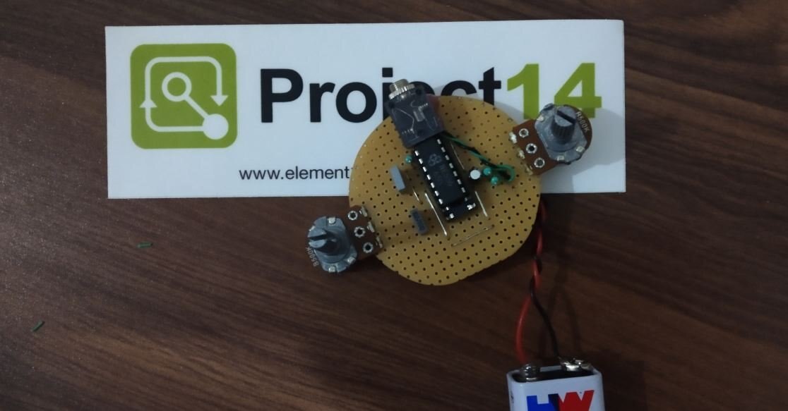

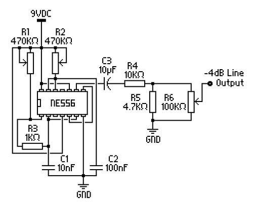

BUILD(II): The ATARI PUNK CONSOLE

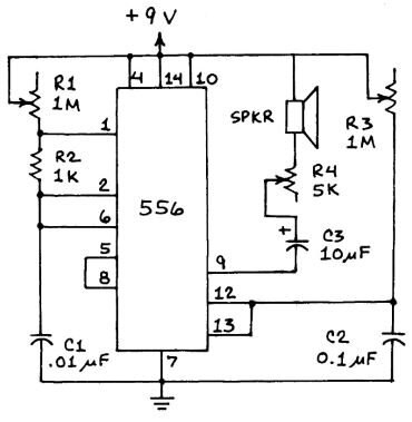

The Atari Punk Console (commonly shortened to APC) is a popular circuit which utilizes two 555 timers or a single 556 dual-timer IC. It has been modified slightly from the original circuit, ‘classified’ as "Sound Synthesizer", that was published in the famous “RadioShack” booklet: "Engineer's Notebook: Integrated Circuit Applications" in the year 1980 and was after few years recognized popularly as "Stepped Tone Generator" in "Engineer's Mini-Notebook - 555 Circuits" by its lead designer & author, Forrest M. Mims III (Siliconcepts, 1984).
It is nowadays dubbed as "Atari Punk Console" (APC) by Kaustic Machines crew because of its "low-fi" sounds resembling the famous classic Atari console games from the 80s, that replicates a square wave output similar to the Atari 2600. Kaustic Machines added a -4db line level output with volume control to the circuit which was originally designed to drive a small 8-ohm mini speaker.
Working...
The Atari Punk Console is actually a square wave oscillator which further drives a monostable oscillator that creates a single (square) pulse. There are two controls, one for the frequency of the oscillator and one to control the pulse width. The controls are usually potentiometer based (can be modified to adapt capacitive slide interface). The circuit is simple DIY ‘noisemaker’ that is relatively inexpensive and easy to build, can be easily modified & configured by replacing components from the perf-board (of course you have to de-solder it, in my case). Try it in your pastime, and you will definitely have some classic fun (SIDE EFFECTS: infuriating & annoying for others).
Things to search for (will be lying around..)
- 556 IC (or 2x 555: worstcase)
- Resistors valued : 1K, 10K, 4.7K
- Capacitors valued : 10nF, 100nF
- Potentiometers(x2) : 470K each (or 500K)
- 3.5mm mono audio-jack
- 9V battery
- itsy-bitsy wires as links
Original Circuit Connections (Kaustic Machines Crew)

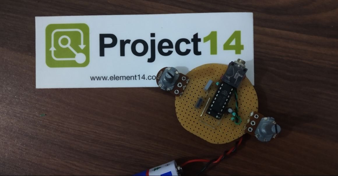

Prototyping on a Perf-Board (rounded manually)
Fun Fact: It took quite longer time to cut and file the perfboard, than it was required for the soldering-part...#MakerSpirit
For sorting things out, you can do it in a Jedi Style (Breadboarding), or become Sith Lord (CNC Milling)

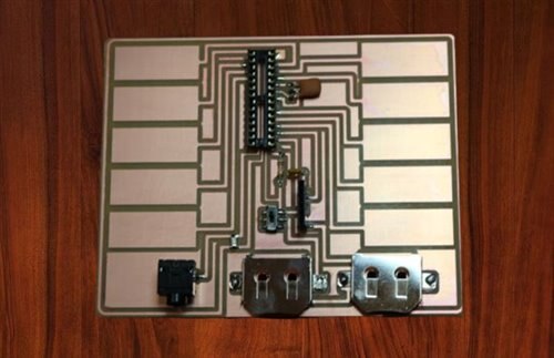

This project is certainly for you Element14 lovers! The Arduino-Touch aka Capacitive Synthesizer will be rocking you out to infectiously simple computerized tones with just the touch of bare-copper.

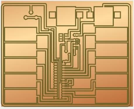

Things
- Printed Circuit Board (Single-sided Copper Clad: 180mmx180mm)
- ATMEGA328P IC (DIP) along with 28-pin socket (though you can easily scrape it out from UNO Board)
- 1x Ceramic resonator: 16MHz
- 1xResistor: 10K
- 1x Capacitor: 0.1uF
- 2x CR2032 Coin cells and Cell holders (SMT)
- LED (color of your choice, but an SMD one; optional)
- 1x 2 Pole Slide Switch
- 1x Mono 3.5 mm Audio Jack
- Female header: 6-pin (need only 5 of them for programming MCU)

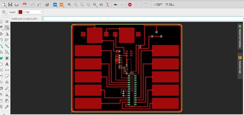

- A desktop milling machine (though you can do it in Jedi-Method:'Etching')
Milling in action...
Soldering it out...
No Coding, Only Uploading...
Take the Arduino Uno, plug-in the USB cable, set out your board & port, compile the following files(both) in the IDE, Click UPLOAD.     After this you can remove the IC from the UNO board and plug back into the designed board.
Retro users can utilize the 5Pin header on the PCB and use it through FTDI or CP2102 Programmer according to following configuration
- Reset: Header Pin-1
- Digital Pin 0: Header Pin-2
- Digital Pin 1: Header Pin-3
- Vcc(5V): Header Pin-4
..Leave the Pin-5..
- GND: Header Pin-6
!!!you can also manipulate the code for performing tones of your taste!!!
Links: Check the following to get board-file(Eagle.brd), gerber-file(Manufactring.grb), NC file(CNC Milling.nc) and Arduino Code(.ino & pitches.h).
