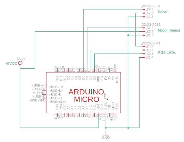

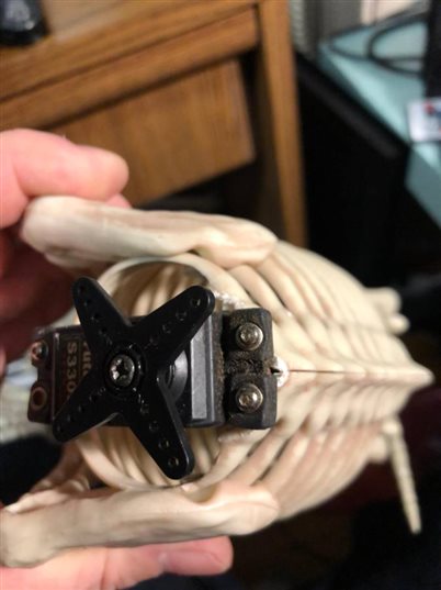

I'll be using an Arduino Micro for this project to control head movement and eye color.
A motion sensor will detect a visitor, and animate the scary puppy.

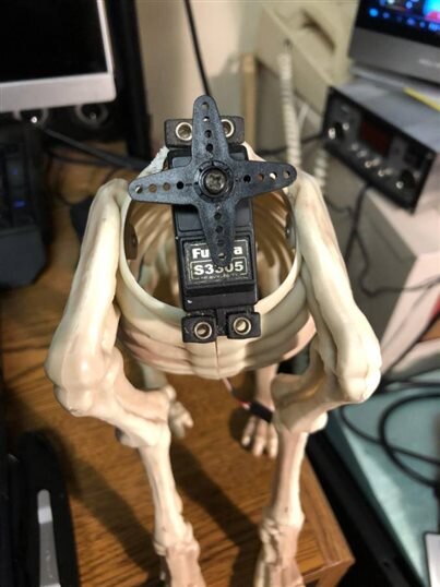

First cut it's head off and add a RC servo.

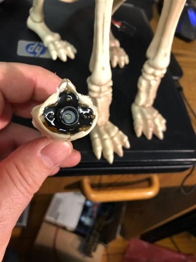

Then epoxy the servo horn into the neck of the beast.

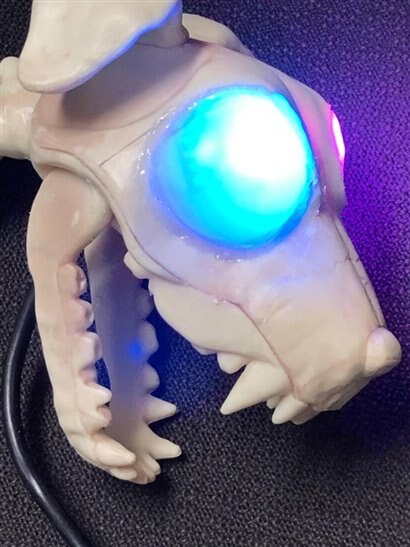

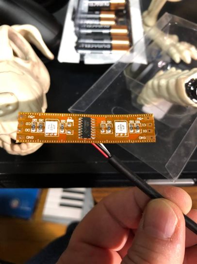

Then we'll add some programmable RGB LEDS for eyes.
These are cut from a strip of 48 with LPD8806 control ICs.
Here's the schematic:  The power is from a 5VDC wall supply.

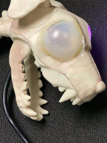

Then hot-glue some ping-pong ball half spheres to cover up the RGB LEDS

    Thanks everyone, it was a last minute project for Halloween and it wasn’t easy to find a servo strong enough to hold that head up without stripping gears. Scott

    robogary over 6 years ago in reply to rsc
    I hear you on the servos.
    The one pictured uses plastic gears. Servos can be ordered with metal gears , start with prefix MG-xxxx, that dont strip so easy.
    Another thing you can do for the design is to use a 6.6V or 7.4V power supply or battery, direct wire to the servo power pins.
    (Arduinos can handle up to 12V on Vin.)  You can also find servos with higher torque and voltages.
