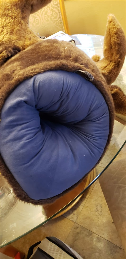

    Luckily both my daughters and mother in law are into sewing, so there was a seam ripper tool in the house. It was pretty easy to cleanly remove the thread holding the blue part to the fur, and empty him. I see now that a lot of the weight comes from the metal bar holding the horns up, which is fine at least for now (until i decide to animate them too image) as that can get mounted partially to the board he's going to go on

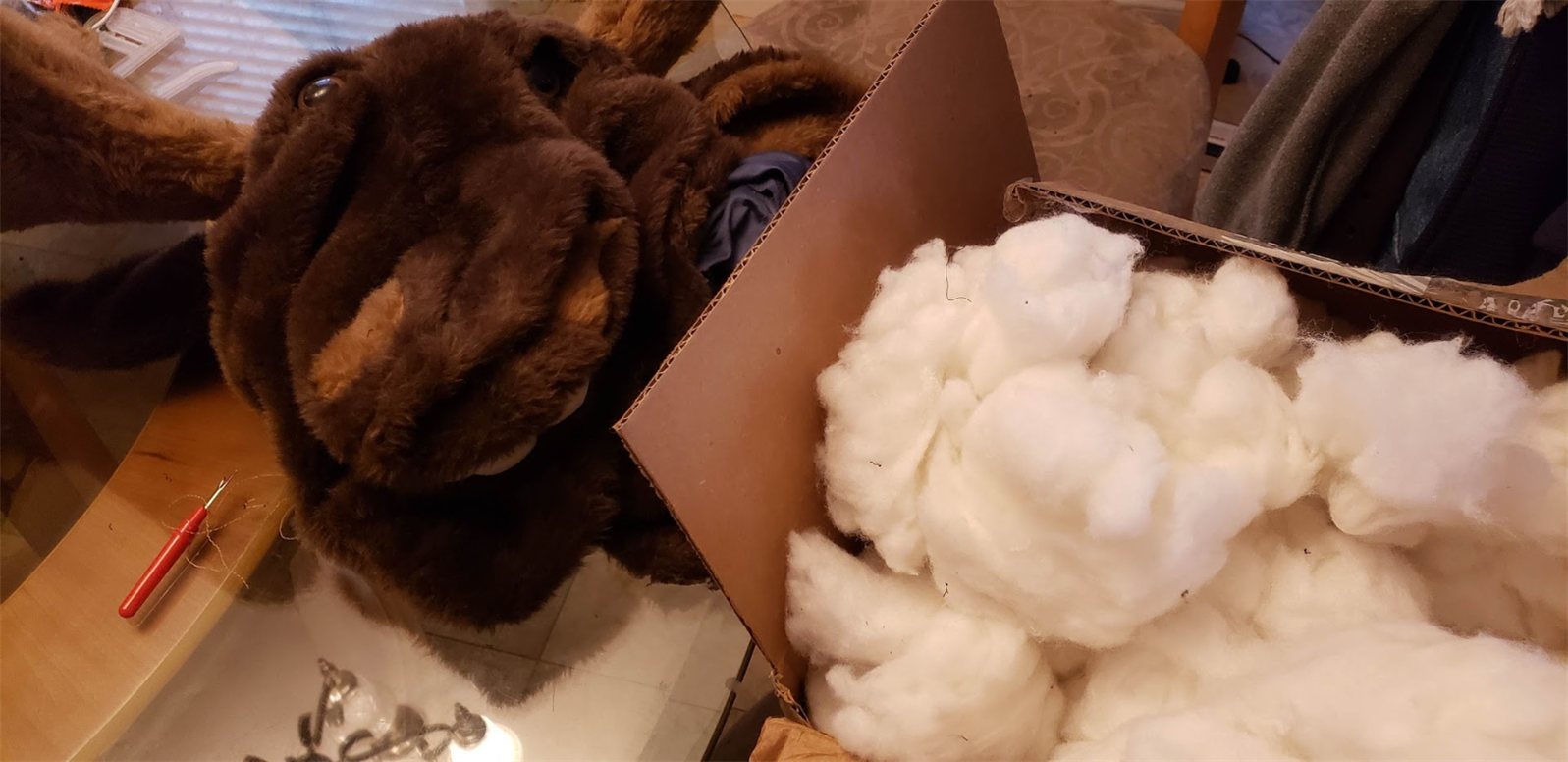

    Today's work is de-stuffing moogle, and then rebuilding some sort of skeleton inside. Right now, the stuffing is so full and stiff there is no way the arm can possibly move his face independently of his neck. plus he's really heavy, and its all stuffing weight

    I've decided that regardless of my sound related issues, this weekend i'm removing the fluff from the moose head, and working out the supports internally. It's kind of sad to cut into a $150 puppet, but c'est la vie. I'd rather have the movement + the puppet head worked out and need to add powered speakers + mic than just continue to spin on that detail.
