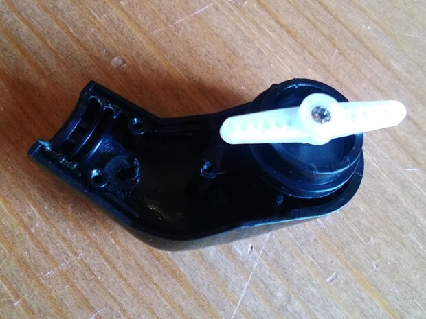

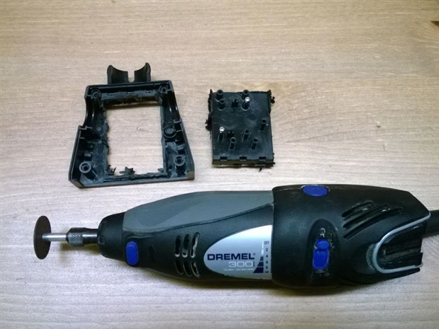

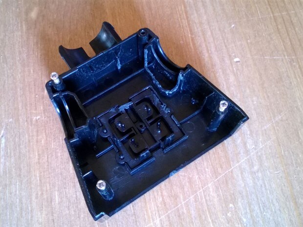

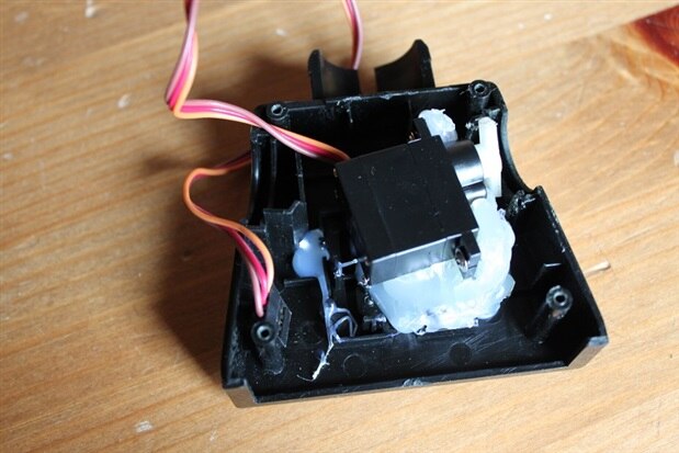

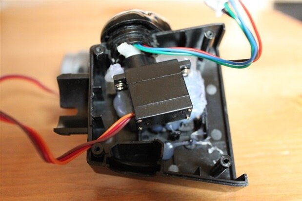

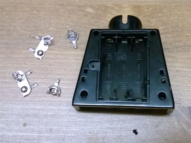

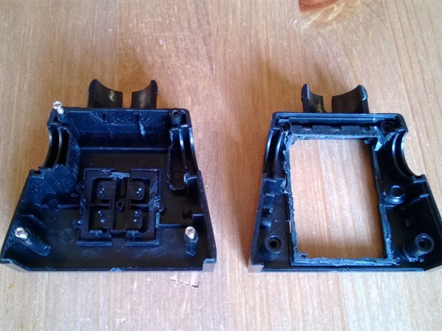

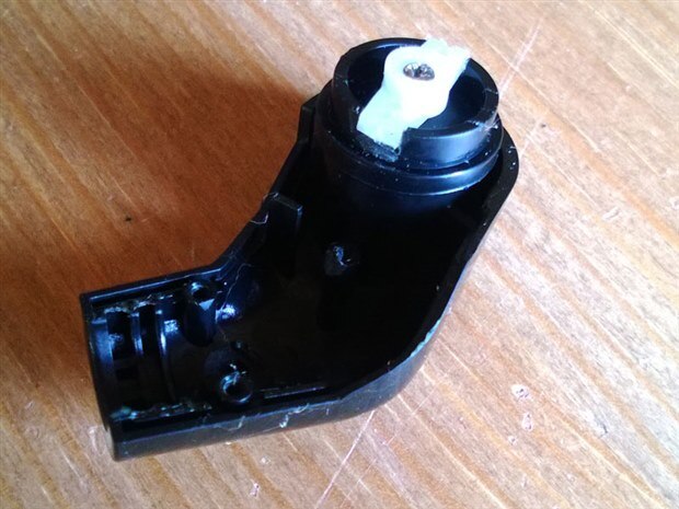

Dremel please, nurse

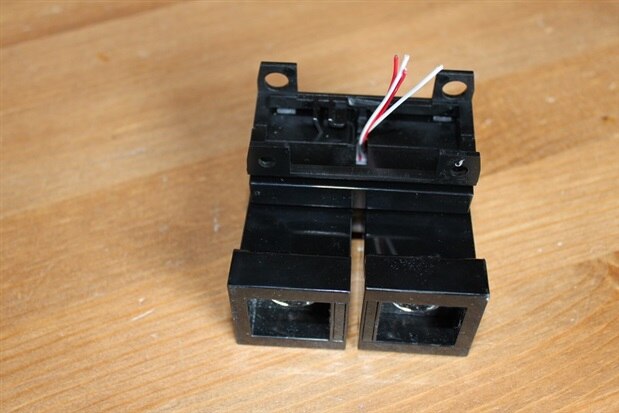

So a fair bit of surgery was required. His chest contained a compartment for 3 AA batteries and a switch. This was used to control the lights in his feet. Much of the battery compartment was Dremelled away and the now unused button (his chest panel) was glued back in place. This left enough room to hot glue a servo in just the right place to operate his shoulder joint. More Dremelling and careful filing later has the servo horn slotted into the top of his arm. Some pictures probably show it better than I can describe.
Shoulder surgery
{gallery} Darth Vader's shoulder surgery
Back with battery connectors removed: We're going to make way for a servo
Battery compartment removed: That should help!
Front panel trimmed and button glued in place: Anything we don't need is being pared back to make more space
Front and back panel butchered: Let's hope these aren't worth thousands on eBay one day...
Servo horn attached to his arm
...and trimmed to fit: That should let me get a servo in there
Servo in place!: Enough glue, you think?
Arm reattached: Ignore the RGB wires for now - that's later
I'm doing nothing with his legs: I just sort of like the photo

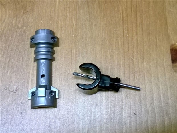

Saber surgery

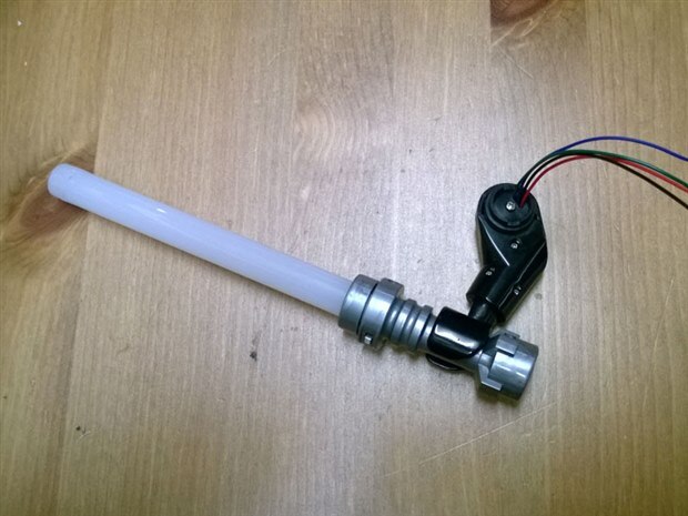

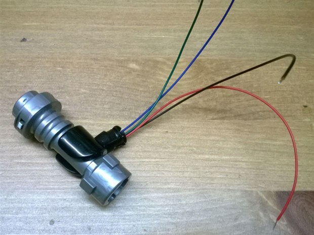

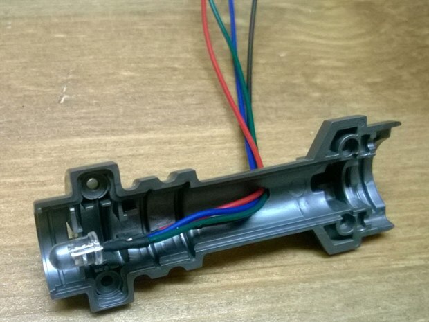

So, I know that he can move his arm, but there would be little point without a lightsaber to wield, would there? The toy has a single RED 5mm through-hole LED mounted at the top of the handle and the handle contains a single AAA battery, a small boost converter PCB and a switch. Who wouldn't want a colour changing lightsaber though? Gutting it and fitting an RGB LED was fairly easy. Routing the LED wiring through the handle, his hand, arm and rotating shoulder joint was a bit trickier though. Once again, pictures probably tell the story a little better than words.
{gallery} Adding an RGB LED to his lightsaber
Fitting the RGB LED: The easy bit
Drilling a route for the wires: The hole in his hand and the lightsaber handle need to line up
He's not putting that down again: It was originally removable - but not any more
His completed arm: Ready to be reattached
Major surgery finished: The patient is looking a bit off colour though
Once again, I did a quick test to make sure the LED was working as intended before testing it along with the servo.

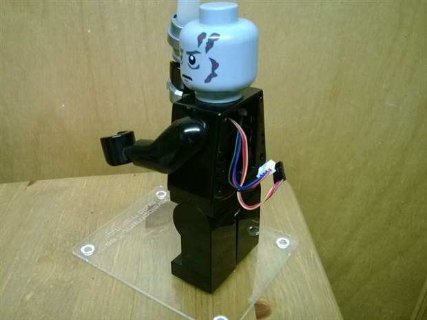

Tidying up

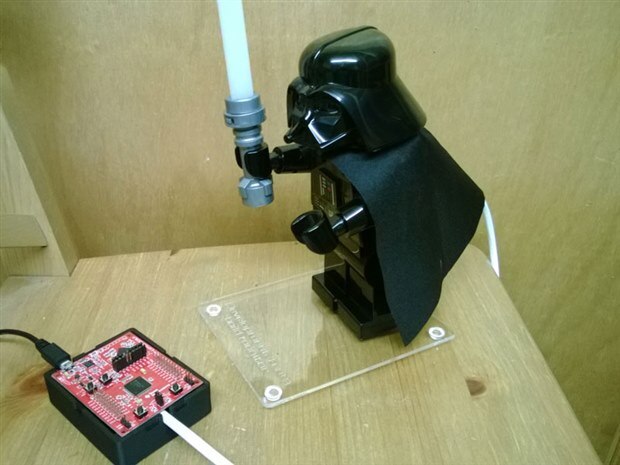

So the hard bit is done, but it would be a shame not to tidy things up a bit. You may have noticed he was a bit wobbly in the test video, so he got a nice laser-cut acrylic stand. The MSP430F5529 launchpad used to control him got a 3D printed case too. Popping his cape back on covered up the wiring into his back nicely too.
