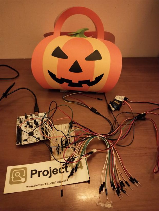

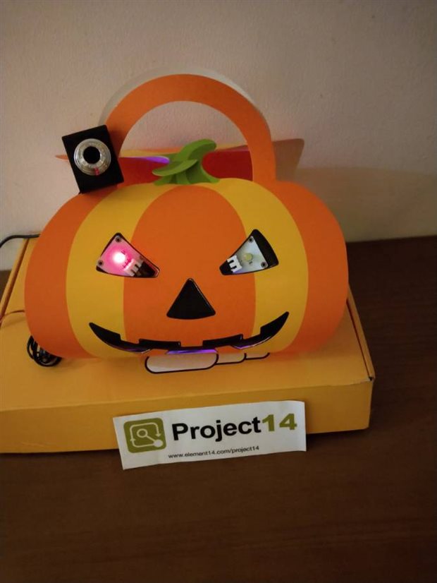

The moment you come to the scary Door, if you are chosen you will see...
1. Scary Door
Using Computer Vision Deep Learning model, camera can detect your appearance and start rocking this scary pumpkin just before the SCARY DOOR.
2. How to Build

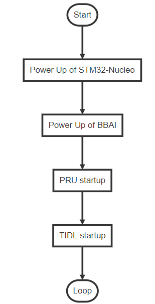

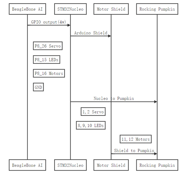

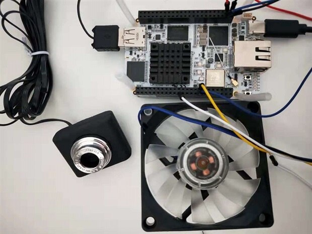

  • First, the camera can detect human approaching with CNN classification capabilities,With BeagleBone AI dev board and one usb camera, classification model runs on A15 core and change GPIO output as signals for Servo, LEDs and DC motor.
  • Then the pumpkin lightup and the eyes on the door rolls.The Nucleo-STM32L496 is triggered with GPIO input to start Servo, LEDs and DC motor with DFRobot Arduino Motor Shield. Then the pumpkin is active now.
  • If you are chosen, the eyeball is cushed with bleeding blood. (Sure, but fake ones. )Optional part is the pop eyeball and crushed bleeding eyeball.
* the Nucleo-STM32L496 is not neccessary in the whole project, but the DFRobot Arduino Motor Shield is easy to be used if with this arduino-compatible board. And I have blackouted the Beaglebone AI board when wiring the DC motor directly with the GPIO for quick test. The fact is that STM32L496 is more cheap and durable. {;-}

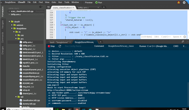

All the codes are done on C9 BeagleBone AI and arduino for nucleo-STM32-64.
3.1 BeagleBone AI part

LINUX A15 core TIDL startup,Main part of Code for CV_process, after put the results in *shared\_dataram.
bool ProcessFrame(ExecutionObjectPipeline* eop, Mat &src)
    if(configuration.enableApiTrace)
        std::cout << "preprocess()" << std::endl;
    imgutil::PreprocessImage(src,
                             eop->GetInputBufferPtr(), configuration);
    eop->ProcessFrameStartAsync();
    return false;
void DisplayFrame(const ExecutionObjectPipeline* eop, Mat& dst)
        std::cout << "postprocess()" << std::endl;
    int is_object = tf_postprocess((uchar*) eop->GetOutputBufferPtr());
    if(is_object >= 0)
        cv::putText(
            dst,
            (*(labels_classes[is_object])).c_str(),
            cv::Point(15, 60),
            cv::FONT_HERSHEY_SIMPLEX,
            1.5,
            cv::Scalar(0,255,0),
            3,  /* thickness */
            8
        // Trigger the out
        *shared_dataram = rand();
    if(last_rpt_id != is_object) {
        if(is_object >= 0)
            std::cout << "(" << is_object << ")="
                      << (*(labels_classes[is_object])).c_str() << std::endl;
        last_rpt_id = is_object;

4. Hardware and Wiring
Total,
  • 3 x 5V USB power
  • 4x jumper wires from BBAI
  • 1x breadboard
  • 11x jumper wires from Nucleo+Shield
  • 3x r-y-b LEDs for pumpkin Eye-blinking
  • 2x servo for pumpkin head turn-around
  • 1x motor for pumpkin eye movement
5. Summary
This project can add some fun for this Halloween.
