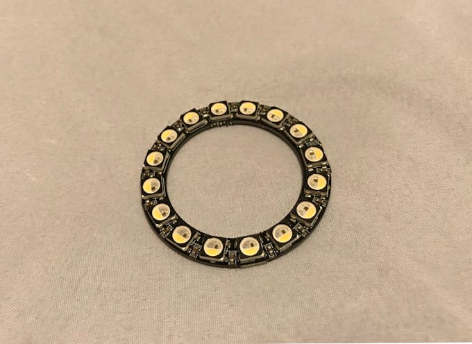

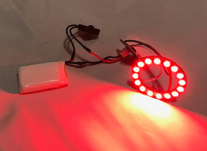

First step is to get the hardware wired together. Start by solder the LED Ring to the board. There are 3 wires to connect, power ground and signal.

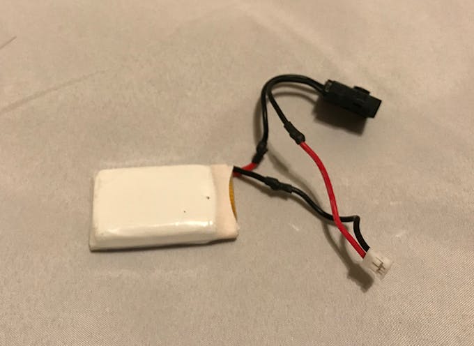

The board is powered can be powered by a Lithium polymer battery.

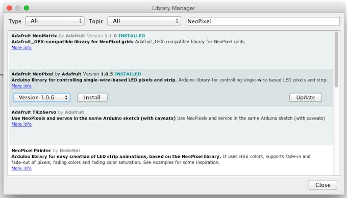

After the you able to upload programs to the board, we will need to install a library to help us control the LEDS. We'll be using the NeoPixel library.
NeoPixel library installation steps: https://learn.adafruit.com/adafruit-neopixel-uberguide/arduino-library-installation
From the Sketch menu, > Include Library > Manage Libraries... In the text input box type in "NeoPixel". Look for "Adafruit NeoPixel by Adafruit" and select the latest version by clicking on the dropbox menu next to the Install button. Then click on the Install button. After it's installed, you can click the "close" button.

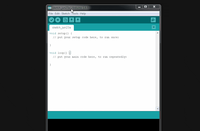

Now that your system is ready, we start programming the LEDS. Open the 'simple' example from NeoPixel:
Change the pin 1, and set the correct amount of LEDS.
#define PIN            1   #define NUMPIXELS      16
You will need to change the following line when using REGW leds:
Adafruit_NeoPixel strip = Adafruit_NeoPixel(16, PIN, NEO_RGBW + NEO_KHZ800);
After those changes you should be able to upload the example and see the LEDS turn on!
We have light!

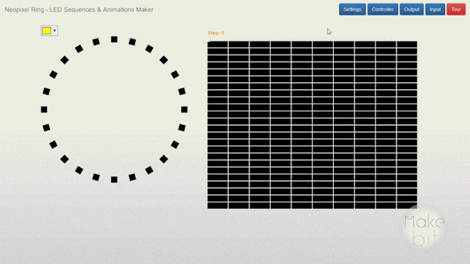

LED ANIMATOR
You can create you own patterns and animations by using this sequencer app: http://brightwaterbottle.io/animator/
Animation Maker
After you have created your animation. You can then copy the output and upload to the board.
