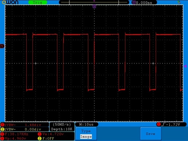

The R1 potentiometer determines the transmission power which of course affects the detection range. The potentiometer R5 adjust the frequency. If you have an oscilloscope, you should be able to see a signal like the figure-4 at the U1, pin-3 (output). Adjust the R5 to read 38KHz. Actually, the R5 allows you to install a wide range of similar IR receivers that might operate with different frequencies.
Figure-4, The 38KHz signal at the 555’s pin-3
