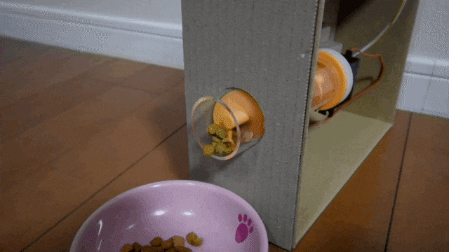

Do you wanna feed your pets from outdoor? I have made a feeding machine which can be controlled on the browser using smartphone.
What you need to prepare
  • Obniz
  • Battery or USB adaptor & cable
  • Screw and pipe
  • Servo motor ( unlimited rotation)
  • Pet food - as much as possible
Step 1
Cut pipes and prepare the screw. I made a screw by using 3D printer. Then, connect screw to a motor. and  put them into a box.
Step 2
Connect servo motor to obniz.
io0: GND,
io1: VCC,
io2: signal
Then power up your obniz.
Step 3
Write codes below and put food into the bottle. Food will come out from the pipe.

    I really like how you built that dispenser! nice work That Obniz looks like a nice dev board and platform too. I see it uses the ESP32 chip too. A few years ago I built a cat treat (or food) self-serve…
