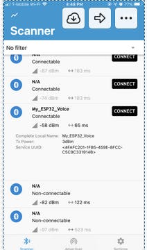

When you open the app, you will see a list of available devices to connect to; in this case, we will be connecting to the esp32 marked as "My_ESP32_Voice".

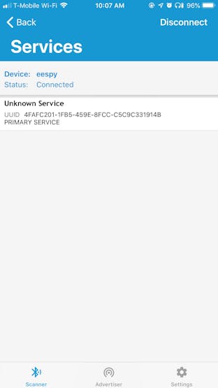

You will be shown available services such as the one above. Click on each service to see its characteristics.

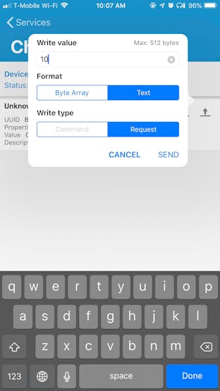

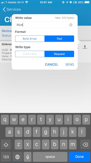

Sending color to the MATRIX Voice ESP32 over Bluetooth
Sending brightness to the MATRIX Voice ESP32 over Bluetooth
The characteristic our MATRIX Voice created allows the user to write to it, so by clicking the upload icon, we can send it a message containing the color we want or a number value indicating the how bright we want the LEDs to be.
