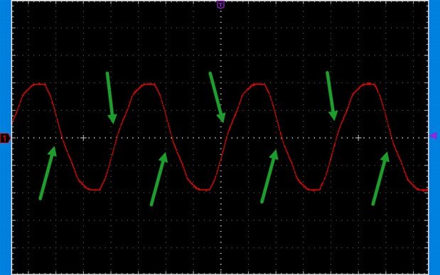

The figure-1 shows the mains sinusoidal wave with the frequency of 50Hz (sometimes 60Hz). To build a dimmer, the zero crossing points (the points where the wave changes its polarity) are important. To grab these points, we have to use a zero crossing detector. The figure-2 demonstrates the schematic diagram of the whole circuit.
Figure-1, Mains sine wave (Green arrows show the zero crossing points)

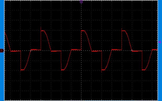

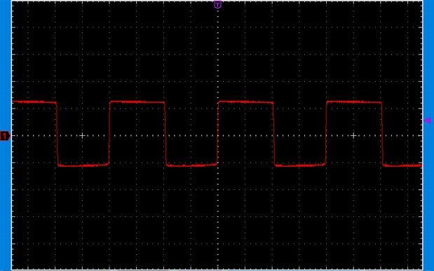

R1, R2, IC1 [1], D1, and C3 build the zero crossing detector circuit. It is designed to make proper isolation (optically) with the mains voltage. So we can expect to get a noise-free signal which can be safely connected to the Arduino I/Os. The figure-3 demonstrates the zero-crossing detector output signal (Pin-4 of the IC1). According to the TLP521-1 datasheet: “The TOSHIBA TLP521-1, -2 and -4 consist of a phototransistor optically coupled to a gallium arsenide infrared emitting diode.” For sure you can use similar optocouplers as well, but I use this part for other designs as well and it does the job quite well.
Figure-3, The output signal of the zero crossing detector circuit
So as it is clear, we gonna use the zero crossing pulse as a trigger for the main controlling circuit. Exactly after a trigger (a zero cross), in a simple term, we have to decide how much power we want to deliver. It is easier to understand by demonstrating the Arduino code and output wave later.

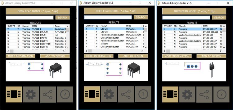

I did not have the footprint and schematic symbols of the IC1, IC2, and IC3. So instead of designing the libraries from scratch and wasting the time, I used the free SamacSys Altium Designer plugin to install the libraries directly in the document [5] [6] [7]. The figure-4 shows the selected parts in the plugin’s UI.
Figure-4, The selected schematic symbol and footprint libraries for IC1, IC2, and IC3

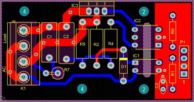

The figure-5 shows the designed PCB layout. The AC lines which are supposed to carry a high amount of current have drawn thicker and double sided. In addition, both track sides have reinforced by some Vias to reduce the resistance and increase the current transmission capability of the PCB track.
Figure-5, The PCB layout of the AC dimmer
All components are Dip. Therefore it is easy for everyone to solder the components quickly and use the circuit as a module. R2, R4, R5, and R7 are 1W resistors. R1 are R6 are 1/4W. C1 and C2 can be selected from MKT or Polyester type capacitors, but make sure that they are at least 400V rated. The 250V rated capacitors seem to be okay, but 250V is a bit close to the input voltage boundaries. Therefore 400V is a wise selection for the capacitors’ voltages. C1 has a 10mm pitch size. This number is 10.5mm for the C2. K1 is an MKDSN connector with 5.08mm pitch size (MKDSN-2.5/4-5.08). P1 is a traditional 4 pins male header connector.
The PCB board has a cutout under the IC1 and IC2. It provides better galvanic isolation between two sections of the circuit board.

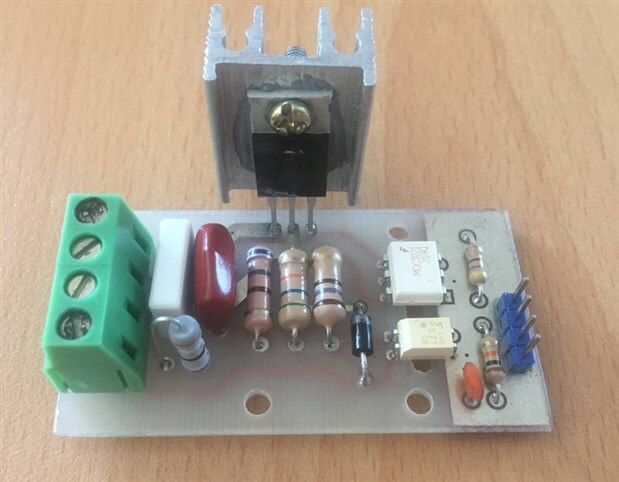

The figure-6 demonstrates the first prototype of the circuit board. The provided PCB layout and Gerber file in this article are the final versions [8].
The mounted heatsink is just for a short test. For an actual long term use, you must use a bigger heatsink. The location of IC3 (near the PCB border) makes the heatsink installation task much easier.
Figure-6, The first prototype of the circuit

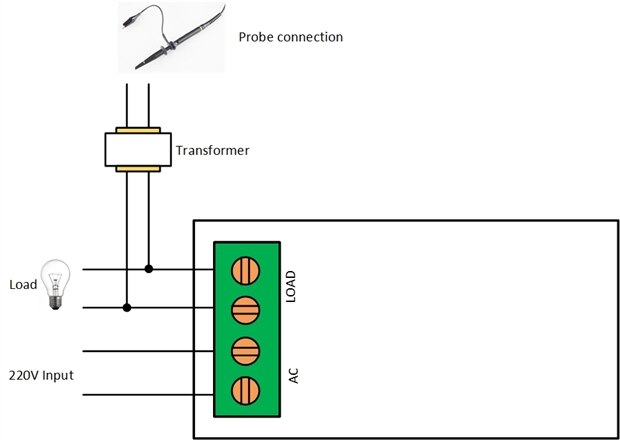

Be careful: never connect your oscilloscope probe directly to the mains. The probe’s ground connection can build a closed loop with the mains terminal and blow up everything in the path, including your circuit, probe or oscilloscope or even yourself!
There are several solutions to overcome this, such as using an isolator or using a differential probe … etc. I used an ordinary transformer (220V to 12V) and verified the output just by using this. Please check the figure-7 for the connections. I have to note that the load must be connected, otherwise you won’t see the true waveform.
Figure-7, Probing the load and required connections
The figure-8 shows the output waveform (50%). You can expand the code and add two buttons to increase and decrease the output power. You can develop the code and modify it with your own Arduino board and your specific needs.
Figure-8, The output waveform in 50% of the power (dim = 5000)
