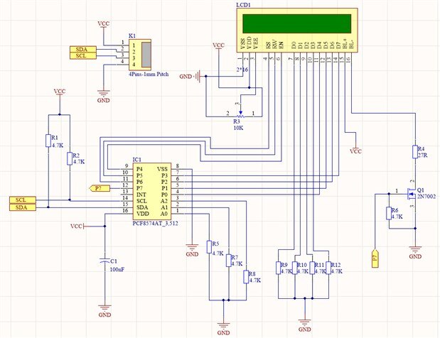

The figure-1 shows the schematic diagram. Even the LCD’s backlight can be controlled by the I2C and you don’t need an extra I/O line to handle this. The resistor R4 limits the backlight current. The LCD contrast can be adjusted by the potentiometer R3.
Figure-1, The schematic diagram of the circuit
The floating LCD data pin (D0 to D3) and the PCF chip address lines (A0 to A2) have been pulled down by 4.7K resistors.

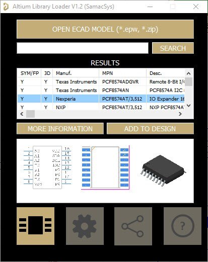

I did not have the schematic symbol and footprint of the PCF8574. So instead of wasting the time to design it from scratch, I used the SamacSys search engine to quickly find the component libraries. I use the Altium designer, so I installed a helpful plugin which installs the libraries directly in the document (Figure-2).
Figure-2, Altium designer plugin search results for the PCF8574
I am interested in the 16 pins package from Nexperia or the NXP. So I just selected that.

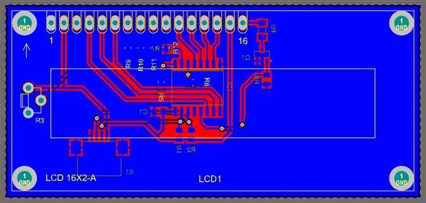

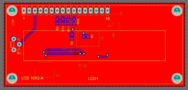

Figure-3 and 4 show the designed PCB board. It is a double-sided board which has designed in the size of a 2*16 character LCD. All capacitors and resistors are 0805, except for the R4 which has a 1206 package.
Figure-3, The top layer view of the PCB board
Figure-4, the bottom layer view of the PCB board

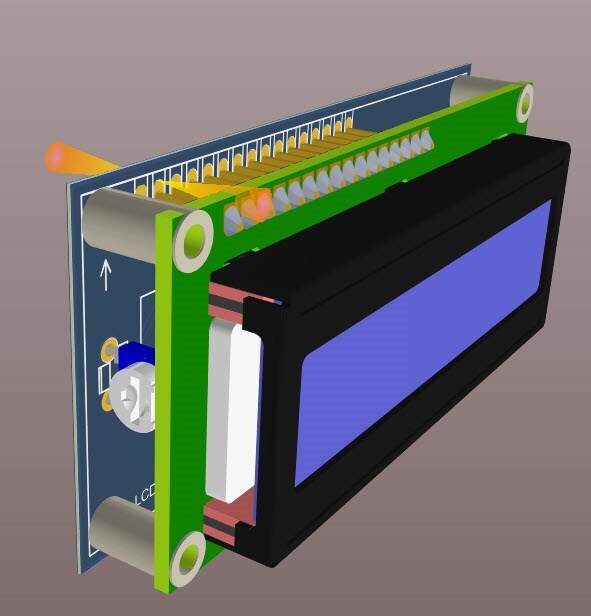

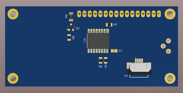

Figure-5 and the figure-6 demonstrate 3D views of the assembled board. From the side and bottom view. You can see the majority of the components will be soldered on the bottom side.
Figure-5, A 3D side view of the board
Figure-6, A 3D bottom view of the board
K1 is a 4-pins 1mm pitch FPC/FFC connector. You should use a ribbon flat cable to connect the LCD board to your main circuit. The LCD will be mounted mostly on the panel, therefore such type of connection is useful.
